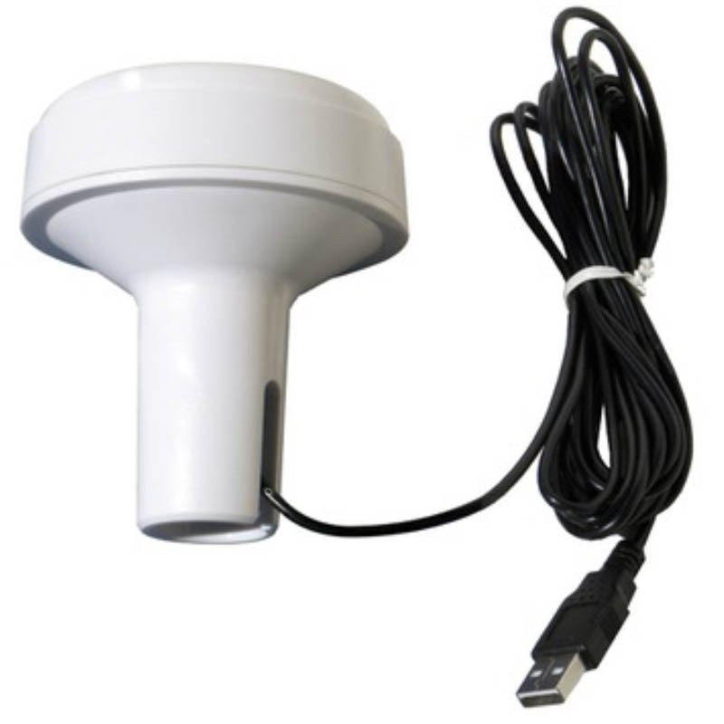

A lot of manufactures use something that resembles a mushroom
This can be in the cabin where it gets its signal through the deck, or outside on a pulpit or the bimini supports.

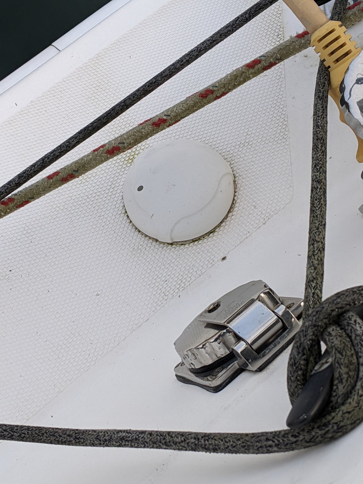

I had the same question with respect to the H41DS that we bought last October. I posed the same question and the replies basically amounted to "it depends on the person/company that installed the electronics".
After more searching, I finally found ours, which is relatively unobtrusive, on the aft starboard deck near the shore power connection. See the attached photo.

Also have a 2009 H41DS and the same 'mushroom' style antenna - although mine is located on the port quarter deck outside the power combing. I never really noticed it for about a year until a guest actually asked me what 'that thing' was :)
