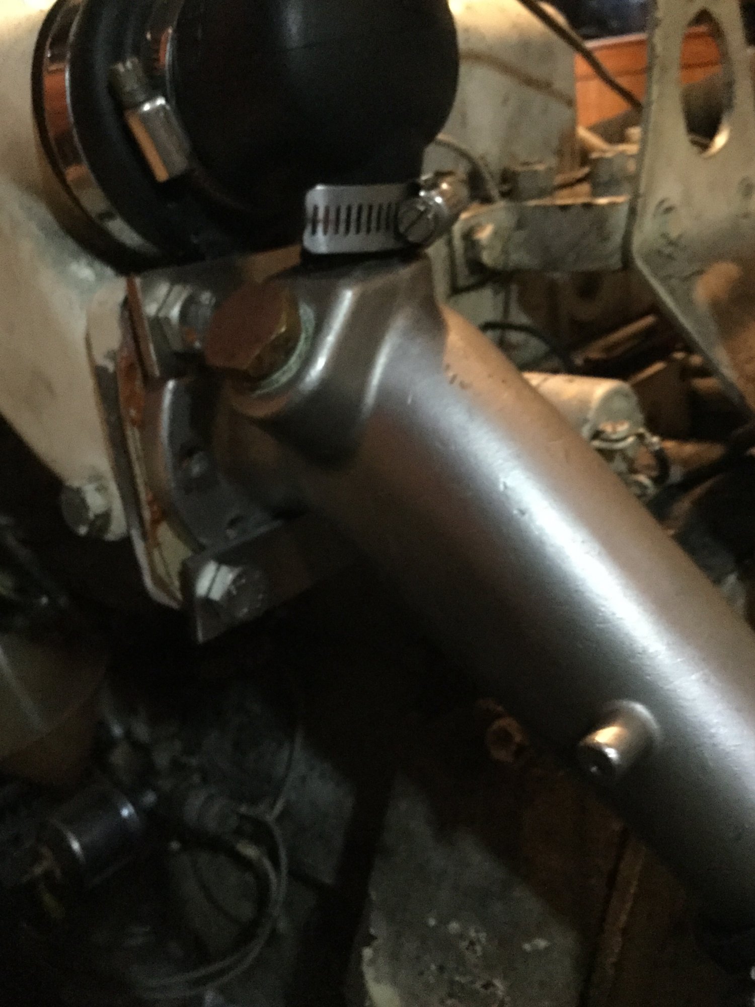

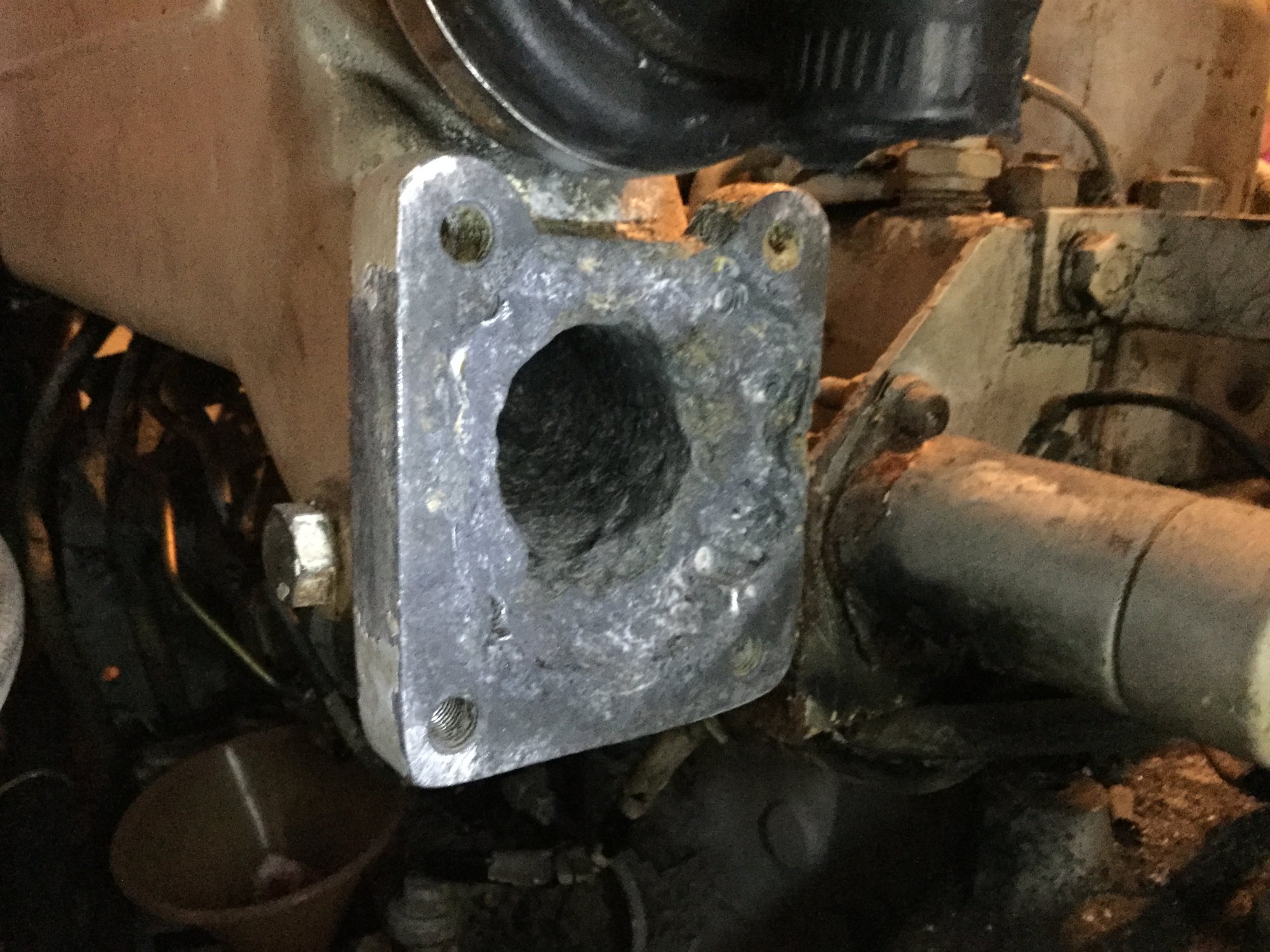

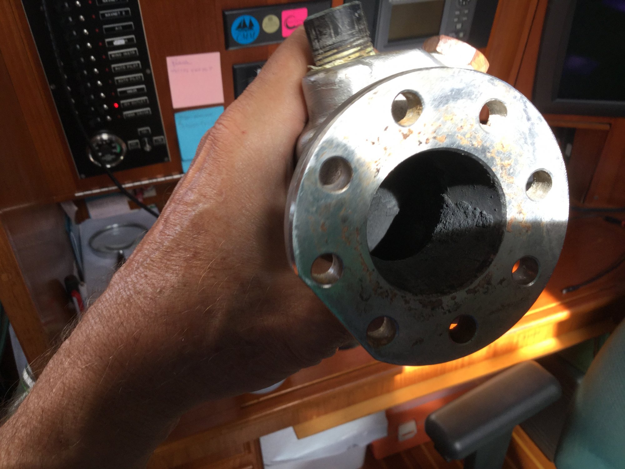

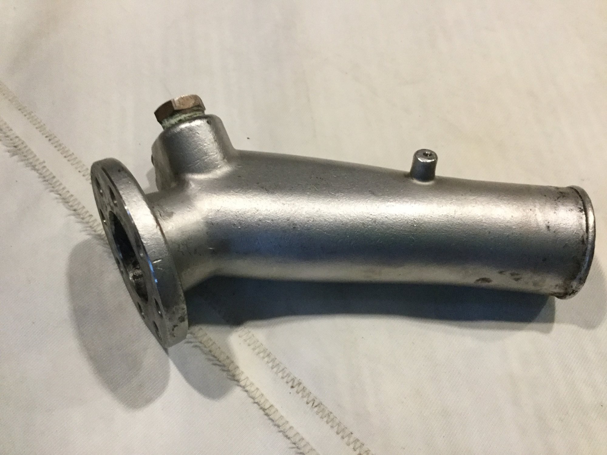

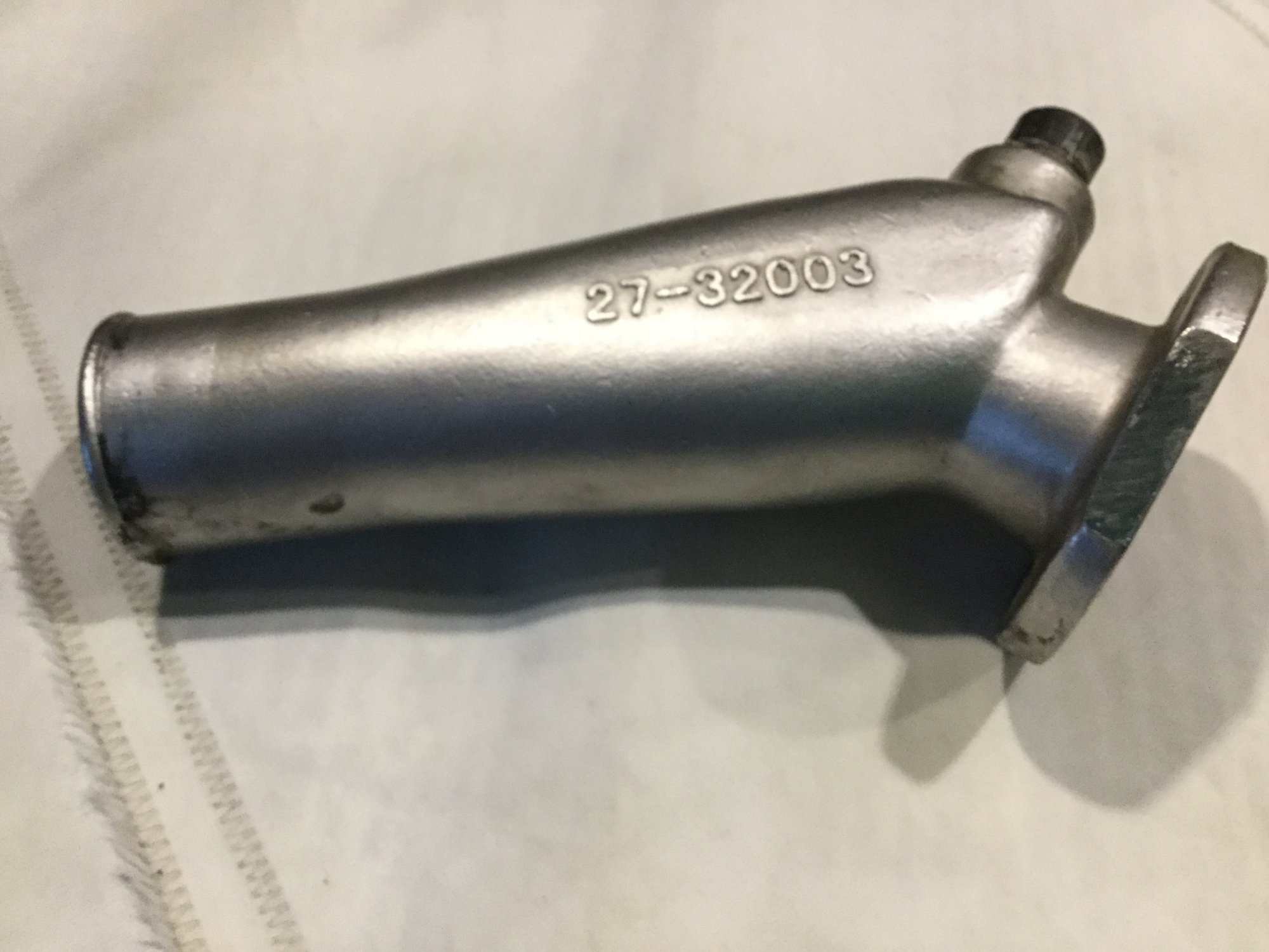

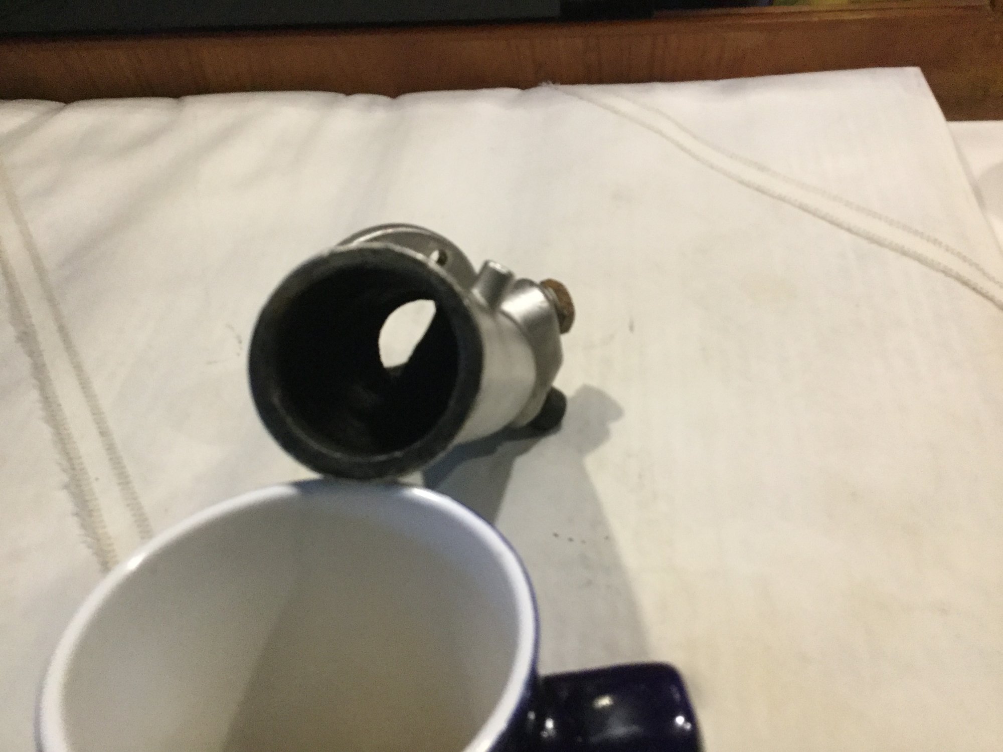

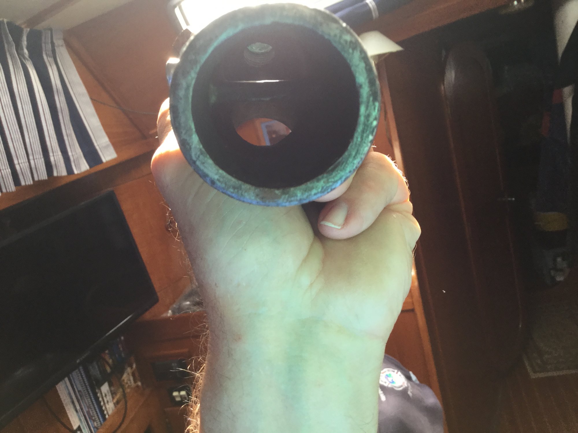

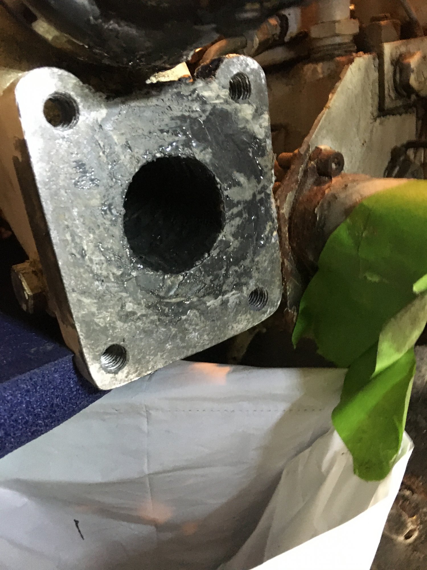

I cleaned up the Hx flange and will try some J-B Weld, hopefully to get us back north and then look at getting a new one. I took the mixing elbow ashore to clean out the carbon, less than a tablespoon. If you look over my coffee cup you can see where the elbow is divide. The raw water flows to about that pin before mixing with the exhaust. Both Hx and elbow were new in 2013, the elbow looks nearly new.

Can you take a photo of the flange connection end of the elbow also please? Like the one you took on the opposite end from the flange showing the inside. Can you perhaps put a flashlight into the elbow from the opposite end from the flange to illuminate the internal surface?

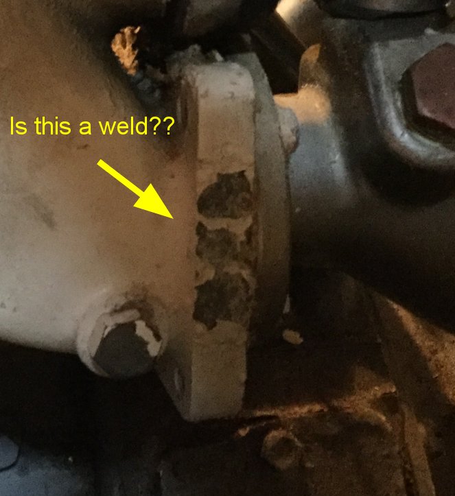

Apologies I still have some questions - see photos below. Does it look like that flange is welded onto the heat exchanger? And can you please measure the two diameters?
dLj
Mar 23, 2017
4,486
It looks from here that both the HX and the elbow are a cast aluminum. Can you confirm if they are both aluminum? I do not see indications of galvanic corrosion. It is looking like an under-deposit corrosion mechanism. I would like to know the diameters of the holes both coming out of the HX and the hole going into the elbow. It's also looking like that flange might be welded onto the HX, but it is hard to tell from the photos. That would be a bit unexpected, but hey, I don't know how they made that HX.

PS: The amount of Carbon in the riser should not be an issue. Looks very clean considering hours on genset.

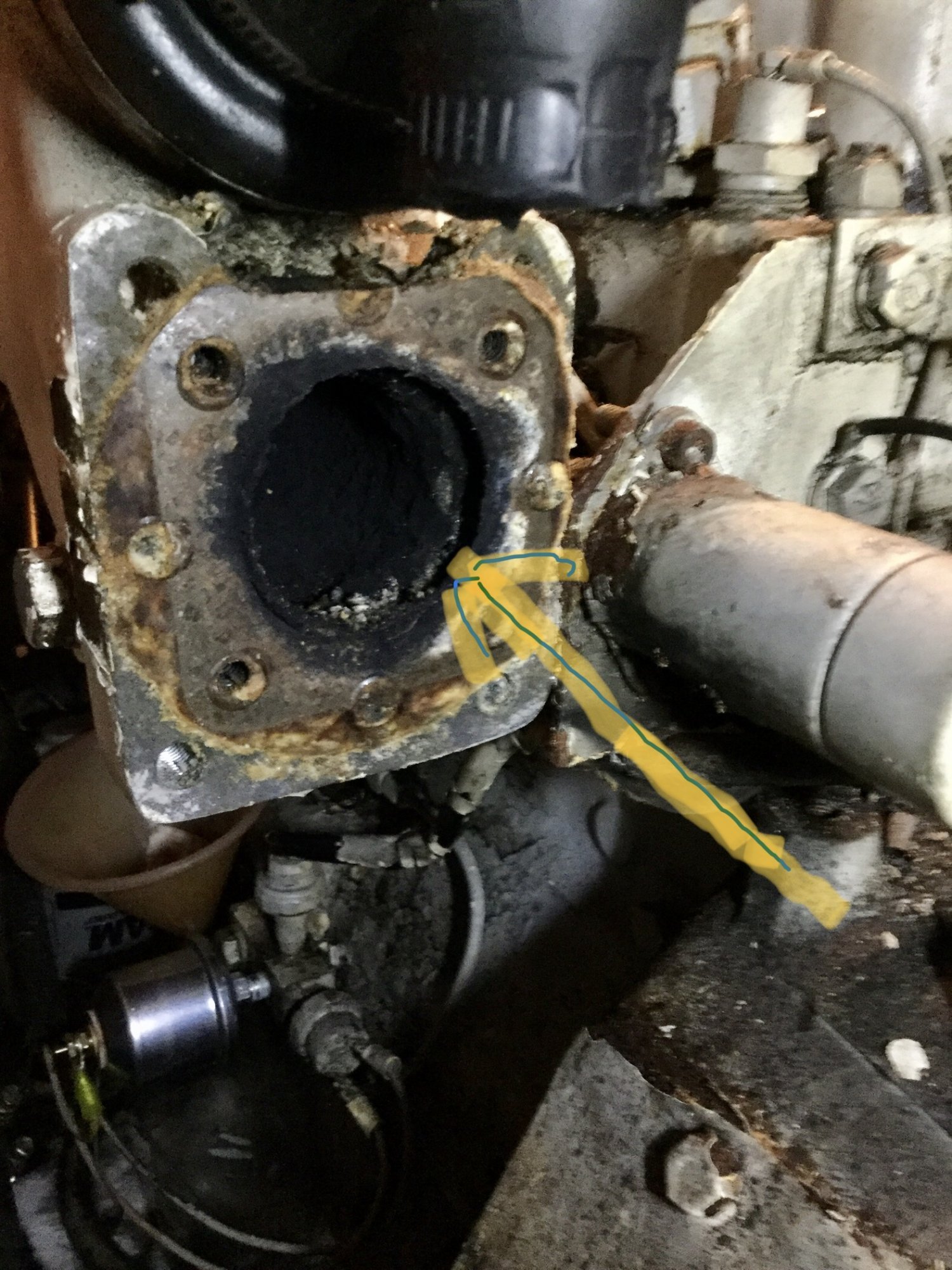

The amount of deposit on the riser does look normal and should not be a problem. But the amount of deposit on the HX does not look as normal to me. Here's one of the original images prior to cleaning with the arrow that @All U Get put in to indicate where the leak was.
This image to me is rather confusing. You can see the 8 holes from the mixing elbow imprinted onto this flange, but none of those holes line up with holes on the flange itself. In this image, it appears that the gasket is still on the flange. It's a square gasket, smaller than the HX flange with four holes closer together than the holes on the HX. Here's the image with the surface cleaned off:
Looking closely into the holes, they don't even look like bolts were in there. How were these two parts held together? It's just not all making sense to me. It looks like mismatched flanges and however they bolted them together may simply have not given the correct sealing pressure.
I think at this point, all I can do is wish @All U Get good luck in getting home. Do let us know what you find out in the end. From my arm chair position, I can't reliably give an answer to this problem. I'd have to see the whole setup.

Just a little update on the mixer elbow connection, after filling the Hx flange flat from adding J-B Weld where the corrosion took place, I had two stainless bars fabricated so I could secure the round mixer elbow to the square Hx flange. I applied some perma-tex to both sides of the gasket then managed to get it together. I also added Tef-gel to the bolts to try and isolate some of the galling which may have been a factor before. This also offered me the option of using bigger bolts instead of the little ones tapped into to the flange in 2013, you can see those in my earlier posts.
No leaks during my testing.
