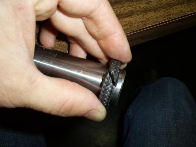

This gore stuff feels like fabric infused with silly puddy. So it's kinda mallable. I thought that if I wrapped it around the shaft and cut it at a 45 degree angle that I could put that piece in the packing gland and push the shaft into it. It didn't work out that way.

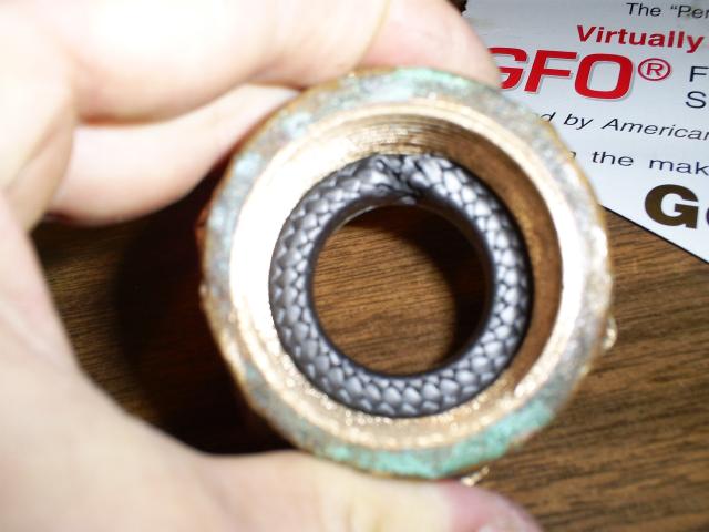

In picGore1 I cut the piece like I have seen in pics online. Then I tried to put that in the packing nut (gore2). It doesn't fit.

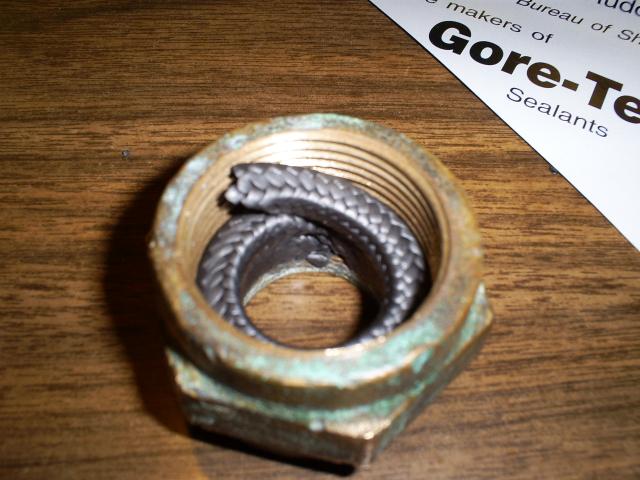

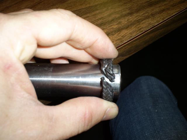

To make it fit I had to cut it about 1/4" short of gonig the circumference of the shaft(gore3) then it fits in the packing gland but I had to smash it pretty good with shaft by inserting it into the nut(gore4). The shaft feels pretty tight in there with just one piece.
This is 1/4" goretex. Do I need to go down to 3/16" goretex? My concern is that this is too tight of a fit and the friction will burn the shaft.

and not a Universal M25. However, if you have the standard C30 1 inch shaft, most use 3/16 packing. Our C34s and the C36s do, as well. Maine Sail's packing article is superb. It looks from your pictures that the material is too thick. Your first picture is the correct way to cut the material.

Anyway I can make it fit but it flattens out pretty far. I didn't know if I had to press the gortex into the threads of the nut or what. They are so tight I couldn't have installed them in the boat. The only reason I could make this fit at all is because it's on my desk.
I can smash them down using the shaft to losen them up, but I don't know if that's right.

According to the measurements you gave it fell dead center in between. If 1/4" does not fit go with 3/16". You're better smaller so you don't over heat your shaft.
You should not try to fill the nut with packing and then jam the shaft through. Always wrap the packing around the shaft then slide the nut over it off setting the cuts..

Anyway I already ordered the 3/16 so it's on the way. It must be 3/16 because the last guy had 4 pieces in this box. 3 pieces of the 1/4 was all the way to the end with only 1 thread showing.

I had the same problem. I had to smash the 3 rings of 1/4 in... not leaving many threads for the packing nut to grab. I ripped that out... and put 3 rings of 3/16" (that fell right in). In retro spect... I think 2 rings of 1/4' would of worked. That gore stuff you can kind of compress... as it is square. Compress it... cut it... then slide it in. I think I caught on the threads and it rolled.
I was in a difficult position hanging upside down and wedged in-between the water heater and fuel tank. Left the 3 rings of 3/16" in... no problem.

OK I just installed the 3/16" goretex in the nut. IT fit perfect.
