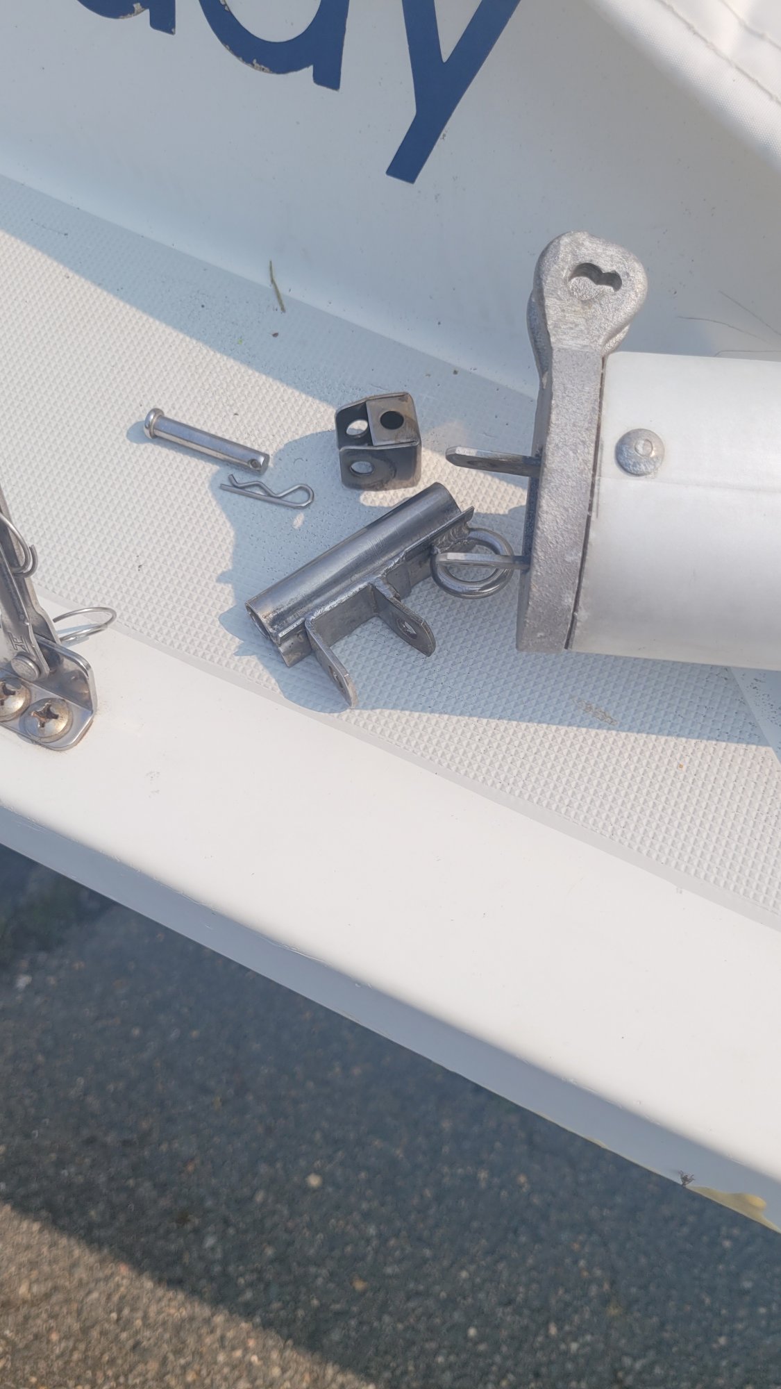

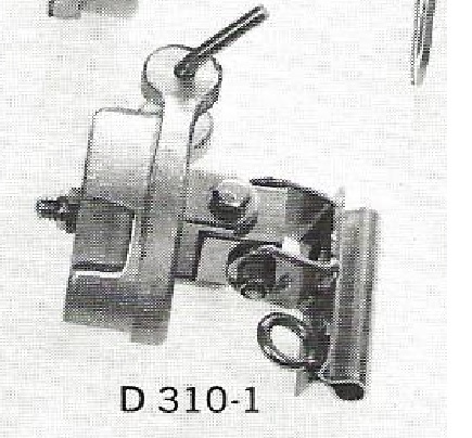

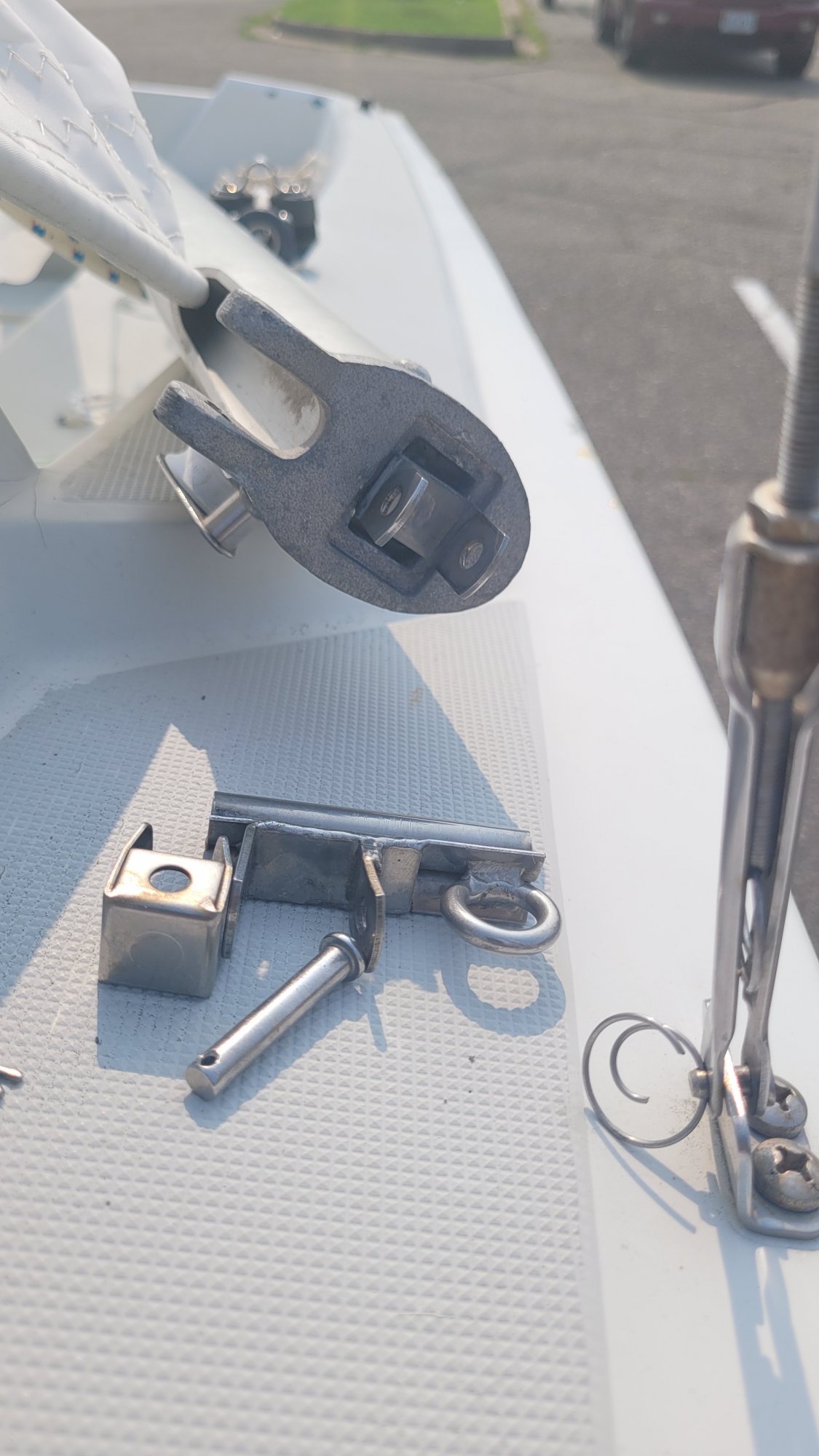

Gooseneck is pretty simple. The body slides into the mast channel where the sail slides. There should be a stopper in the channel below the gooseneck to keep it from dropping too low, The boom attaches to the gooseneck like a hinge, using the pin to connect the two. The sail tack will attach to the ring on top of the gooseneck, most commonly with a shackle. You can use an inexpensive "stamped" shackle, you don't need the pricey forged type.
If you don't have a cunningham rigged, then you can set the gooseneck to slide up and down to adjust mainsail luff tension. The real term for this is a "boom downhaul" These days, most sailors find the cunningham more effective as a mainsail luff tension tool. Very easy to set up, btw, and with the cunningham you can lock the gooseneck in one position and forget it.
If you do not understand the terms and devices I'm describing, now's the time to do a little research. These things are not boat specific, they are common to all sailboats. So google things like "cunningham" "boom downhaul" "sail stop" and so on. From what I can see you have everything you need. Perhaps the clevis pin isn't long enough for "hinging" the boom to GN. In that case, get a longer clevis pin.
These are all basic parts, especially the clevis pins. You can find them at any marine store (also called a chandlery) Doesn't have to be a sailing store either. In fact, you can find a lot of these things, like clevis pins, at your local hardware or auto parts store.
