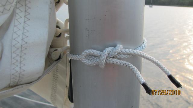

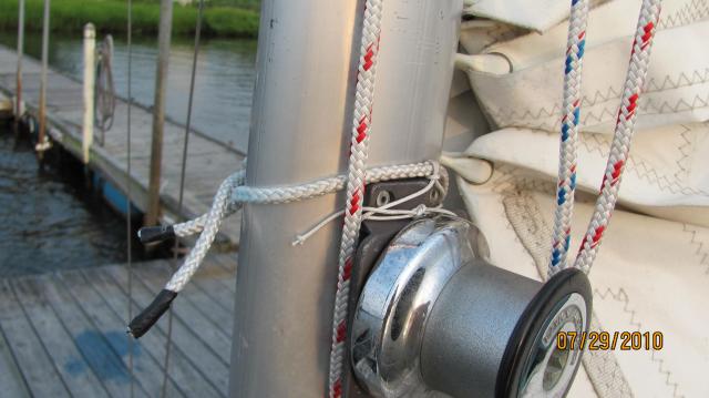

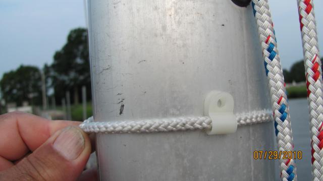

I forgot to mention that. On my O'Day 222 and also my friend Wayne's Seaward 22, we need to take two sail slides out of the track before we reef the mainsail. You may need to do this also. I have a fixed goose neck fitting on my mast. In other words, I have no tack downhaul and a gate for sail slides will not work on my mast. For a sail slide stop, I'm using a 3/16" X 12" braid which I have tied to my mast winch bracket. I tie a reef knot in this line and it works great for a sail stop. If your mast winch is not located in the right spot to use a rope, you can use a nylon wire clip with a screw to hold it in place. The rope works great for me.
Put a couple of drops of Dawn Dish washing detergent on each sail slug and you'll see a big difference in the way that the sail goes up and comes down. Each rain will wash the soap out and clean that mast groove. Add more Dawn as needed.
