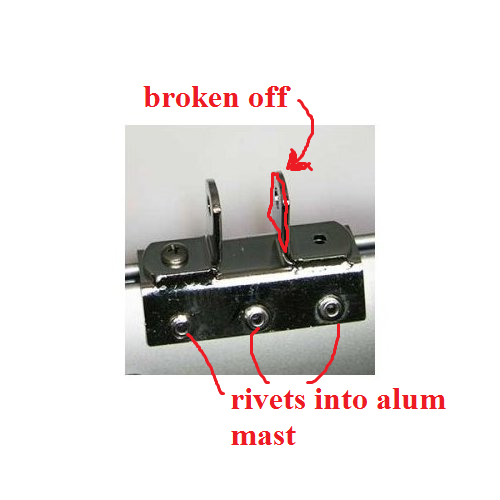

I'm the maintenance guy for a college club racing team. Back in November we bought 6 CFJ's used from another club, and finally got the chance to sail last weekend now that our lake is thawed.
Aside from the various little missing pins and parts, the only major damage to one of the boats was a sheared off piece of the gooseneck bracket on the mast.
I haven't really worked with rivets before so I have a few q's:
What is the best way to remove them? I assume drilling them out
How do I replace them, and what kind of tools do I need?
Attached pic for reference

I'm thinking those are stainless steel rivets. You will have to drill them out, which will probably require a very durable bit. They are a lot harder to drill out than aluminum rivets.
Replacing them may also be too difficult with a standard rivet gun depending on the size. It may be worthwhile to get a gun for ss rivets (assuming all these parts have ss rivets) since you will be maintaining a fleet.
Good luck ... they look like fun!

If you still have the piece that is broken off, it may be easier to take the mast to a welder that can do stainless and have it repaired.

They seem to be barrel rivets, if so, then replacement barrels with Philips head should be an appropriate replacement.

The main thing is to get the head off regardless of stainless steel and aluminum. To do that of course is to drill with the drill bit the same size but if you do not know the size of the pop rivet as there are several sizes, start with a drill bit a little smaller at first, then go to the next size. Once that is done, generally a punch with a slight tap to the punch is all that is needed to remove them.

Harbor Freight sells a decent riveter that will pull SS rivets ok. The most common size used in dinghies is 3/16", and the HF riveter handles them. Pull SLOWLY on the rivet, and make sure the length of the rivet is appropriate for the thickness of the substrate - e.g. don't use a longer rivet than you need to. I find with the HF riveter, I slowly pull until the handles hit the stops, open, push down on the mandrel, and start pulling again, and the mandrel will pop very shortly after the second pull starts.
HF Riveter: http://www.harborfreight.com/heavy-...and-riveter-with-collection-bottle-66422.html
You can get SS rivets from McMaster-Carr. I've had great experiences dealing with them. (It doesn't hurt they are maybe an hour or two from me, so they ship very quickly…) http://www.mcmaster.com/#standard-rivets/=rkrfr2

I've also had good luck a Dremel tool and cutoff wheel. Just grind the head off nad punch the body in, it's also about the only way when the rivit is loose and spins when you try to drill it.
When you are drilling stainless you must use as much pressure as the bit will stand, and low rpm's. Otherwise you just work harden the stainless, also some cutting fluid, alcohol, light oil, or even diesel will help tremendiously. Above all sharp bit and pressure.

However, the original poster's comment shows a fairly heavy bracket that would hopefully protect the aluminum extrusion from much damage.... which, in my thinking, would allow one to grind off the head and simply push the rivet's body through.

If you are going to replace the bracket anyway; just grind the heads off, and punch the body of the rivets out.
