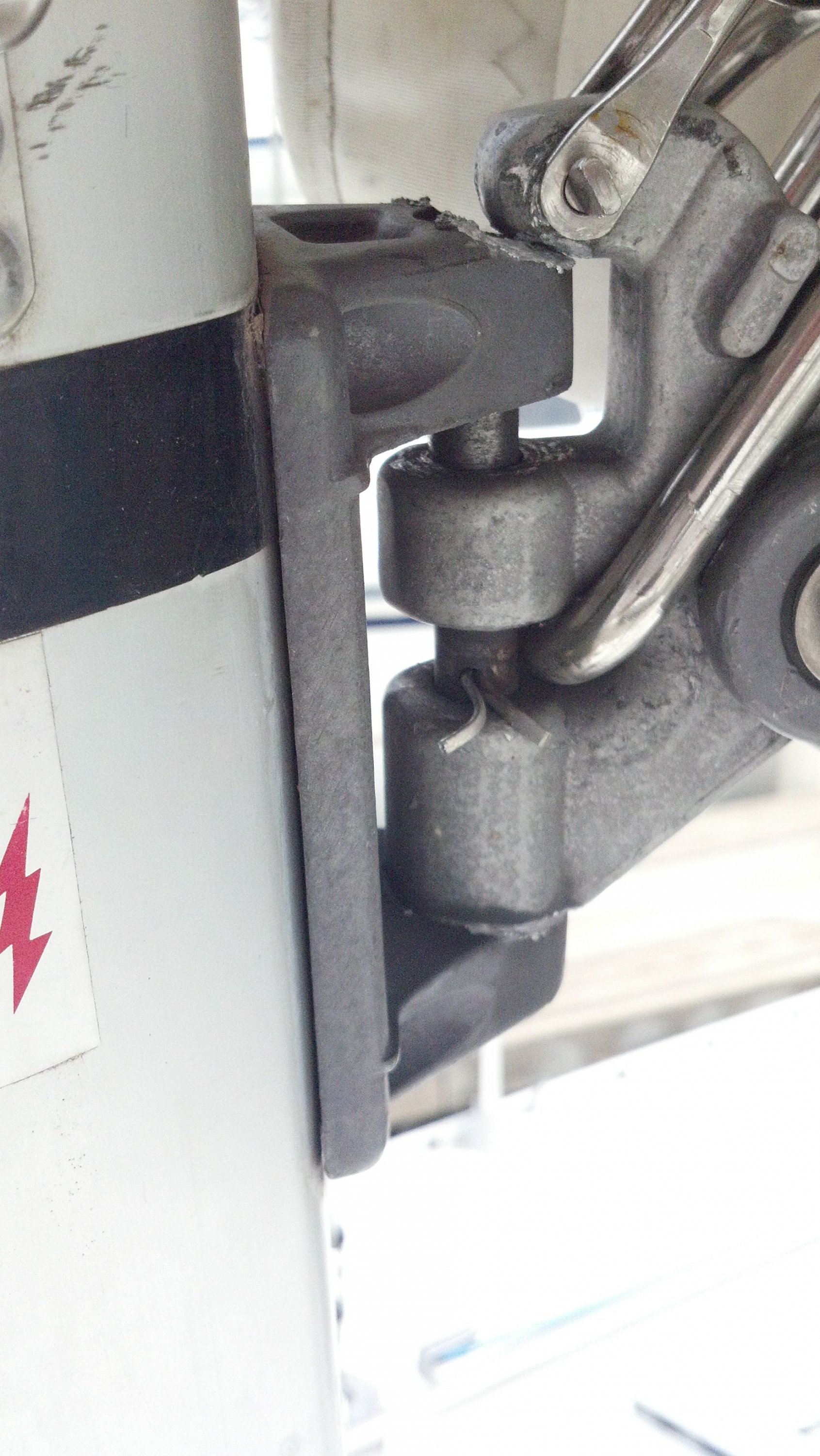

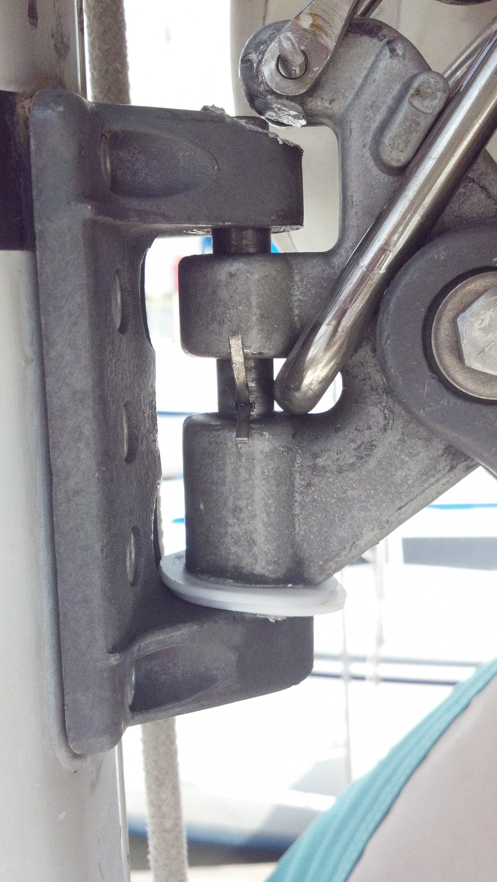

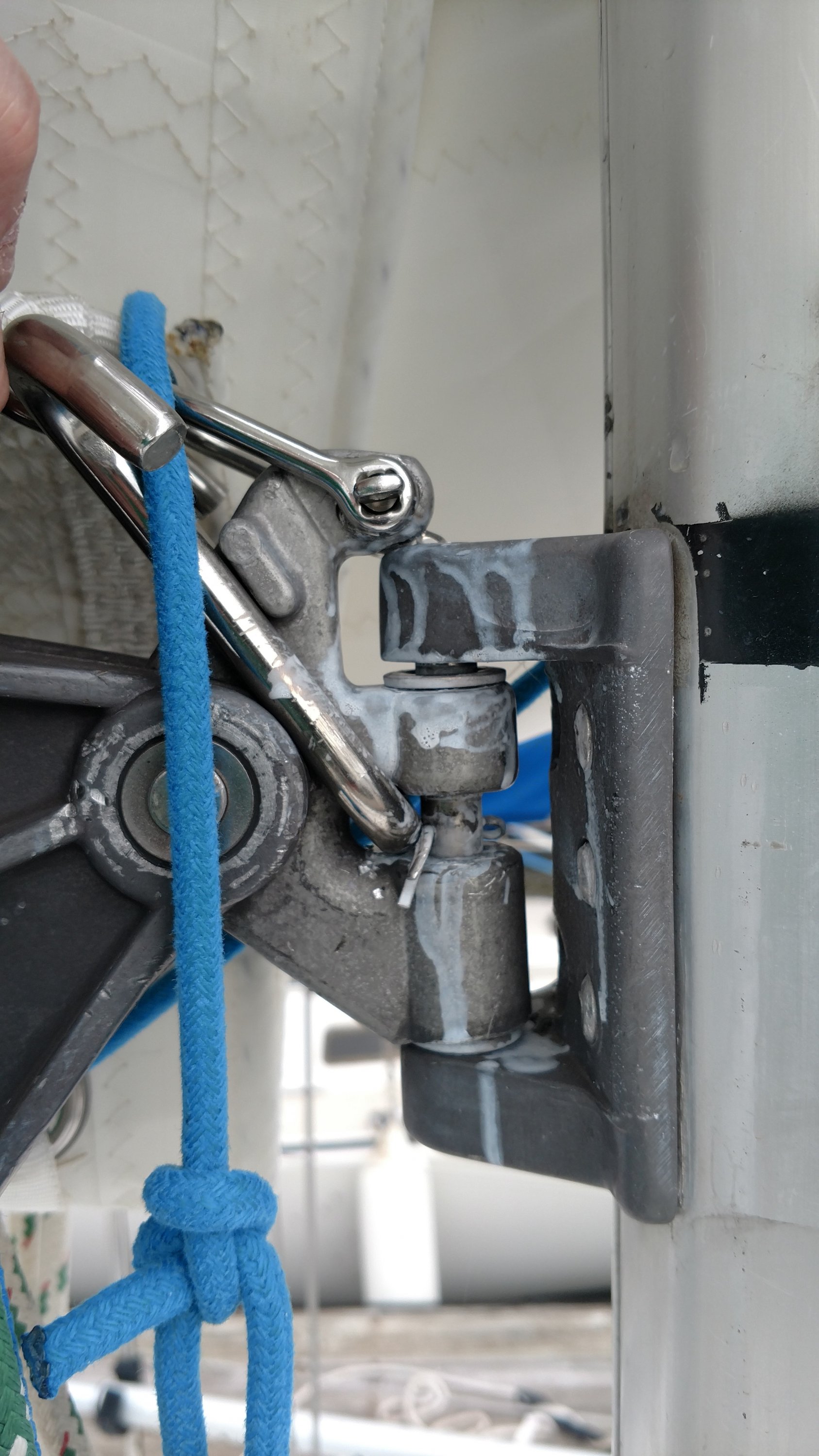

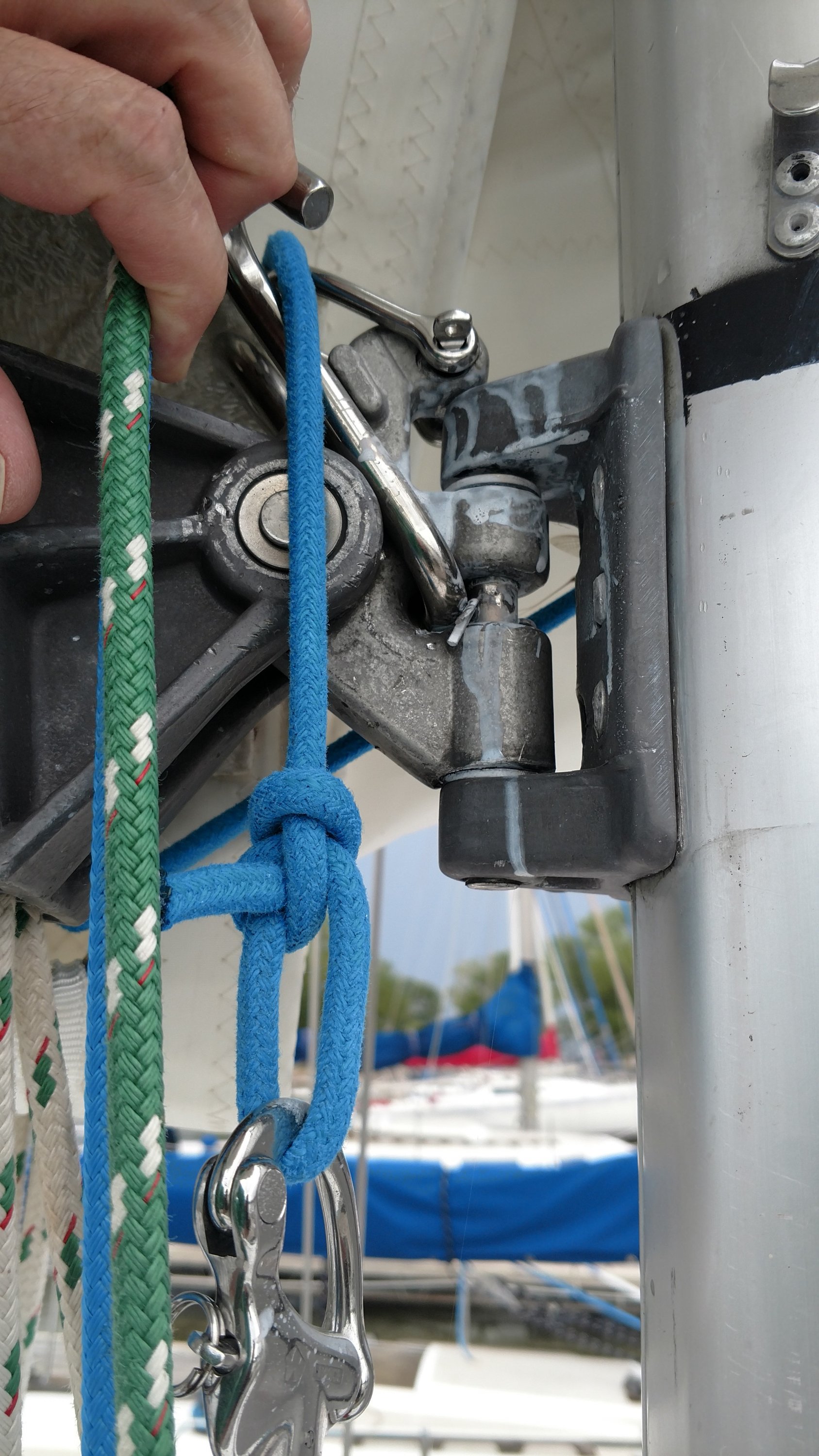

While having a glorious downwind sail yesterday, the boom suddenly came off the mast on my bennetau first 310. I am a little confused as to how it goes back on. Anybody out there have a diagram, sketch, photo by chance?
JRacer
Aug 9, 2011
1,407
Here is a picture of mine on the 310. Mine lacked the needed bushings to avoid wear when I bought the boat so that's why you see it worn. The fixture on the mast has since been replaced and properly bushed. Basically, stainless washers to use as spacers to keep the fixed and moving parts separated from one another. On a temporary basis before I could fix it, I bushed it with Teflon bushings that the cat sailors use on the base of their masts - that is what you see in the pic. But the pic should show you how it fits together. I'll be out at the boat tonight and if I remember it, I'll shoot a new pic of the current arrangement. US Spars website should have the parts explosion for that mast, boom and related hardware. Go here and plug in the boat details on the left side of the screen and it will take you to the parts details. http://www.usspars.com/
