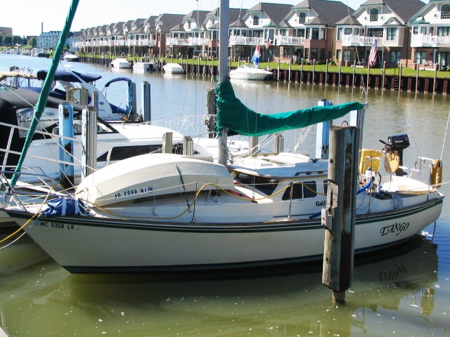

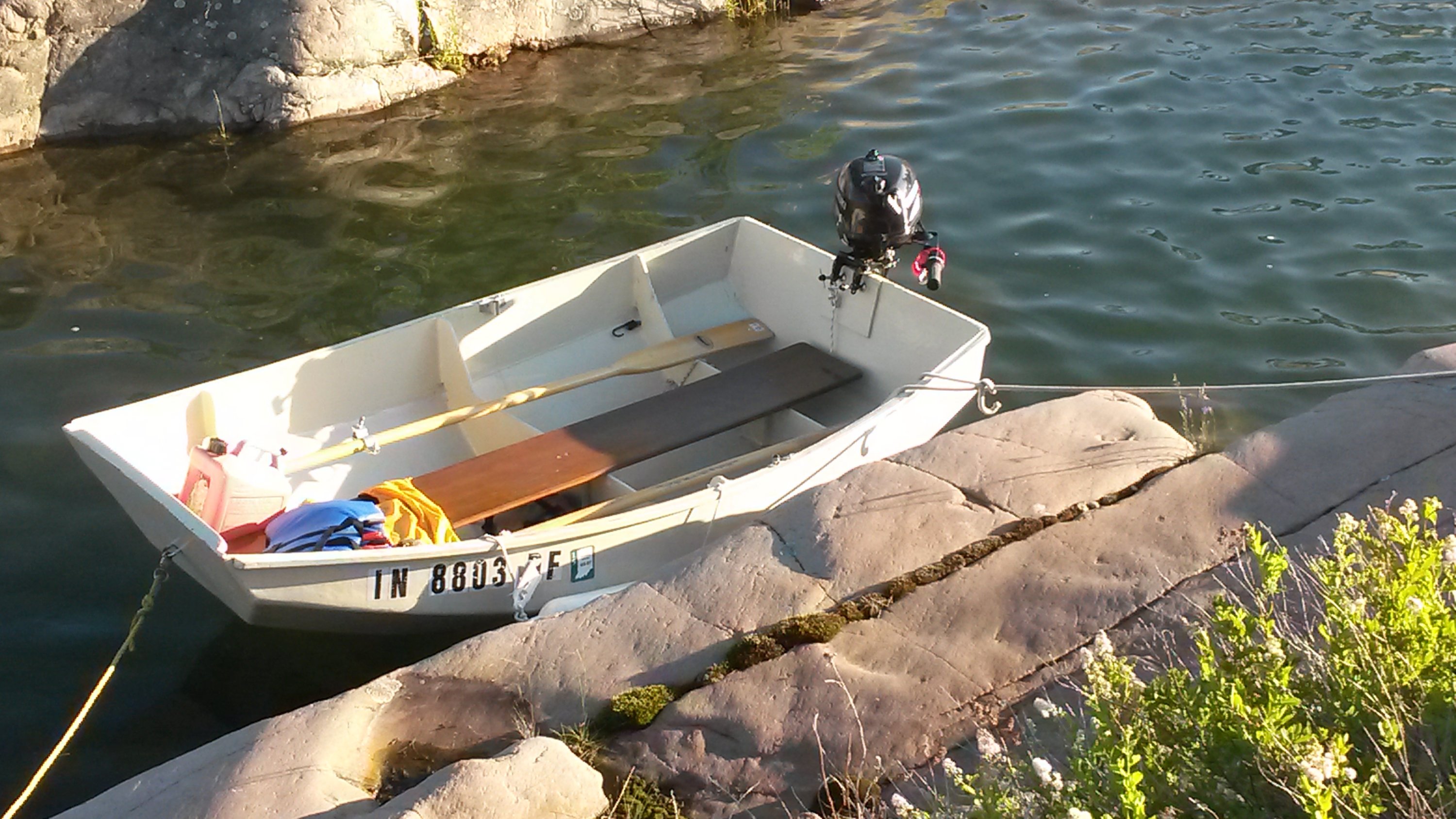

I built Bolger's Rubens Nymph, 8' long and a foot wider than the regular Nymph. It is extremely stable, rows well, and can have a sailing rig (we don't). I fit it on the foredeck of our Gulf 29', where we carried it for a 250 mile trip from Port Huron, MI to the North Channel of Lake Huron. It was possible to get around it on the foredeck while docking or anchoring. Since then, we've always towed it without a problem.
