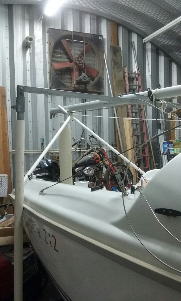

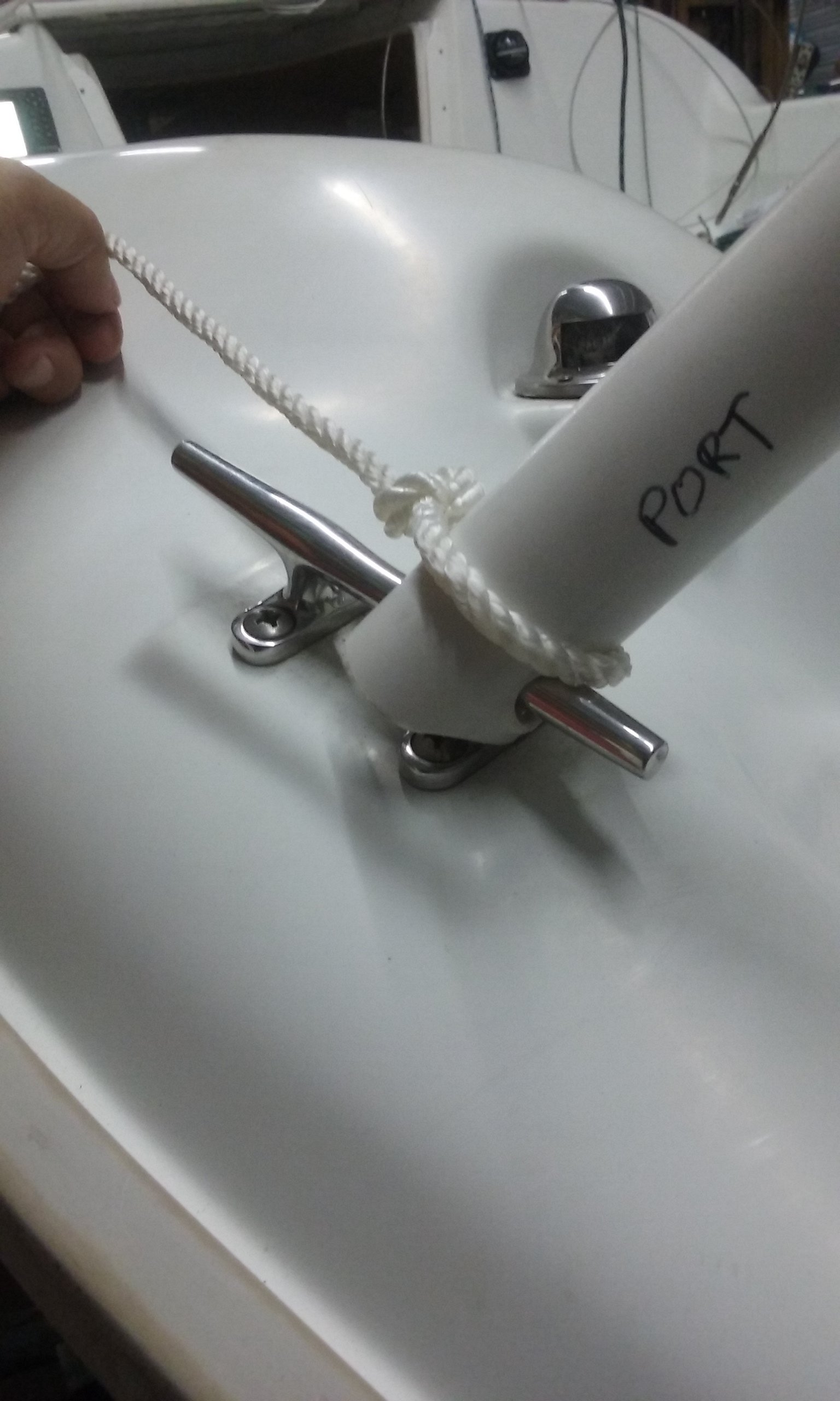

Not sure if you have roller furling but would like to see a photo of the cross stick support if you do not mind....
...As for the windows, like I said not all boats had cracked windows. In heat and cold, the windows I think tend to contract and expand along with the ACP, where the two meet, do not let that happen using dow 795 as a barrier. that is the key
No roller furling on mine.
The sticks are 1-1/4" Sch40 PVC pipe. Each is 6-1/2' long. I drilled holes, probably about 10" from the tops, & ran 1/4" line through those holes, then lashed the sticks together at the point where the holes are, which becomes the cradle where the mast sits. The line then goes forward to a block & a jam cleat. That way, I can raise & lower the height of the sticks by pulling in or letting out the line. In the attached picture, the mast is resting on the trailer support & the cross sticks are just snugged up under the mast. The sticks hold the mast on their own with no problem while underway. I mounted the sticks to the stern cleats by drilling holes in the pipes that I then stick the aft end of the cleats through. A slot on the front of the PVC gives clearance on the front of the cleat. I secure the PVC to the cleats by wrapping some more of the 1/4" line around the cleat after the stick is in position & then put a couple of half hitches on top.

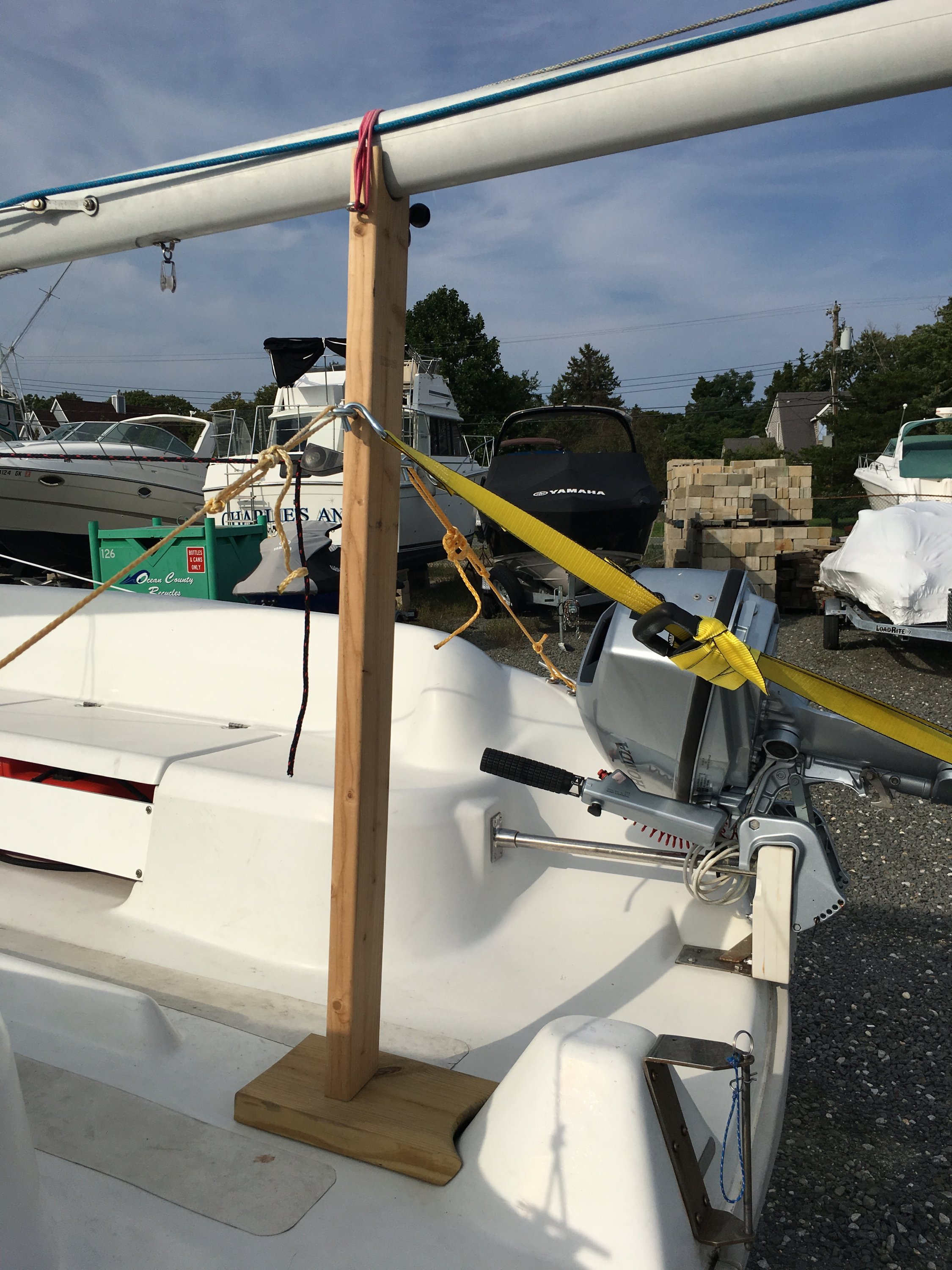

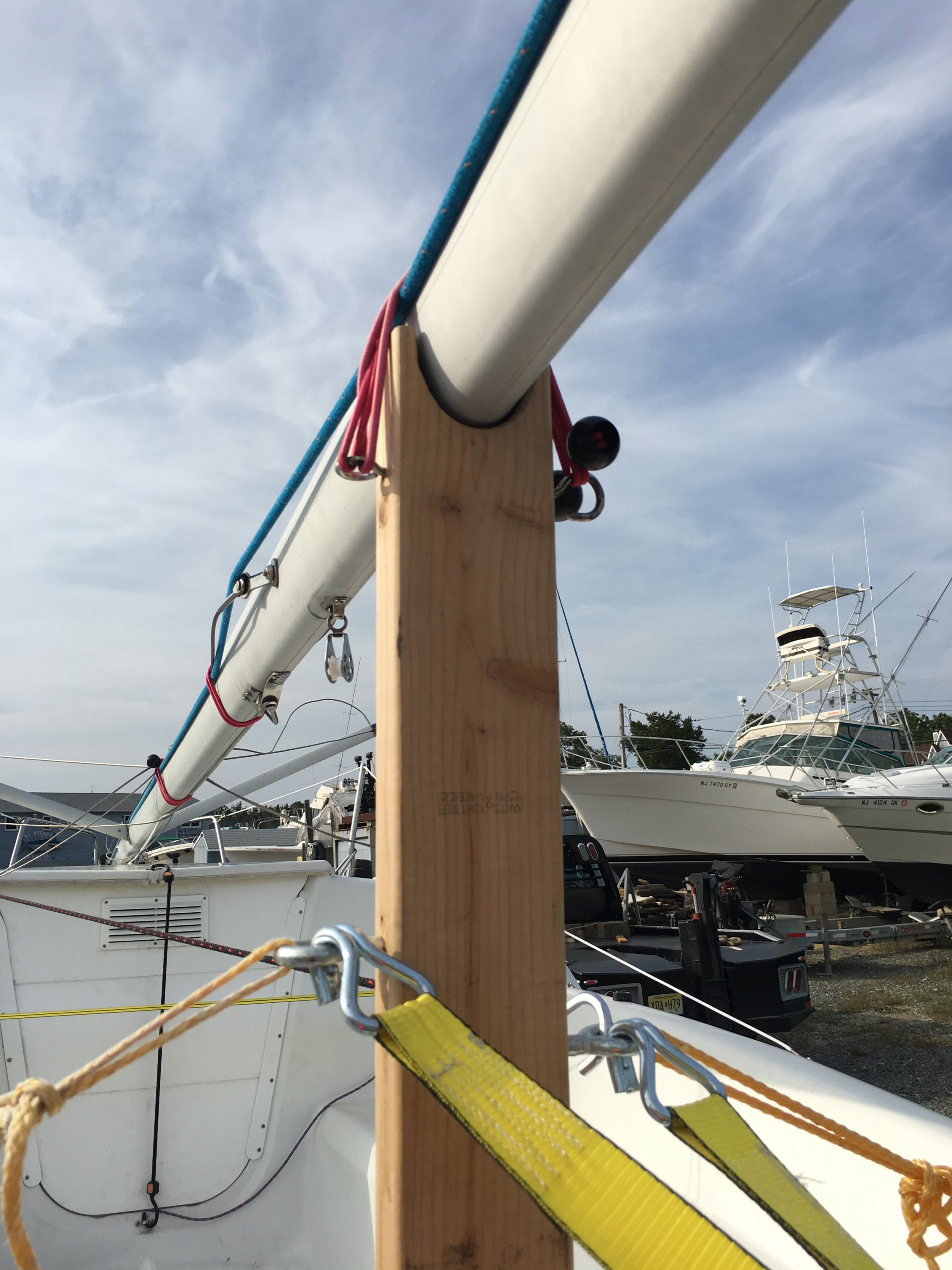

Jim, thanks for the interesting posts and pictures of your mast support system. A friend and I bought a Hunter 212 earlier this summer and have faced some of the same issues you have, so maybe I can offer some advice.
Both windows were very loose and were letting in a lot of water each time it rained, so we removed them, scraped off the old adhesive, and reinstalled with Dow 795. Be careful and take your time getting the old windows off - they are taped on very strongly, especially in the rear 1/3 of the window, and will crack if you're not careful. Once they are off, I suspect you will see that most of the cracks in the Luran surface originate under the windows, so this is a great time to secure everything with epoxy and countersunk 1/2" wood screws which will be hidden when the windows are reinstalled. We then reapplied some strong outdoor double-sided tape to hold the windows in place before caulking around the outside with Dow 795. Although it cleans up with alcohol when wet, I'd strongly advise you to mask off both the window and the boat with masking tape on both sides of the Dow 795 bead. Then just apply the 795 liberally (we used 1 and 1/2 tubes for two windows) , bed it down with a wet thumb, and pull off the masking tape all around the window before it dries too much. A little Devcon adhesive in the remaining visible cracks, then some 2-part Bondo putty and white spray paint and it looks like new again.
Even after the windows were sealed, we were still getting a lot of water leaking into the boat during rainstorms. We removed and re-sealed the stanchions and u-bolts in the top of the cabin with 5200, which helped a lot, but we still had some "mystery" leaking. We finally determined that water was collecting in the rub rail that runs around the boat and covers the seam between the top and bottom "halves" of the boat, so we used white silicone to seal around the entire top of the rub rail. It's now 99% dry, and what little water comes in quickly evaporates through a ventilation grill we installed in the top section of the companionway door.
To support the mast when trailering, we built a simple wooden bracket that is braced against the inboard side of the rudder support and lashed to both stern cleats. We like to leave the motor on for trailering, tilted up, and we use a strap from the lower part of the motor to the wooden bracket to carry some of the weight and avoid stressing the motor mount points on bumpy roads. I'll take a picture if anyone is interested in that.

Mike, that does help. Thank you for all that good information. I too have a little mystery water getting into the cabin & I did not think to check the deck/hull joint under the rub rail.
I’m still using the stock motor mount. I do not leave the motor attached for trailering because I don’t trust it on a bumpy road. The stock mount works well with a 3.5hp. It might be under gunned for larger motors. A previous owner replaced the set screw in the forward support tube with a through bolt, which leaves some slop due to the clearance between the tube & the socket. I plan to press fit a solid plug in the tube & tap it. That should make for a snug connection. At this time, I have a hi/low bracket bolted to the stock motor mount. This is being done so that I can use the short shaft motor from my roll up RHIB tender to power the sailboat & not carry a second motor. I will probably remove the hi/lo & go back to a long shaft when I stop going to places where I need a tender.

We just used 10 ounce tubes of Dow 795 that fit in a standard caulking gun - they're available on Amazon and elsewhere but make sure you order the black color to match the windows. When dry it feels just like cured silicone caulk - solid but with some flexibility. It's much more flexible than cured 5200 and it has to fill some substantial gaps, up to 1/4", between the window and the hull. It was a little firmer than normal silicone caulk, didn't "slump" on the vertical joints, and was the ideal product for this application - I would not use anything else.

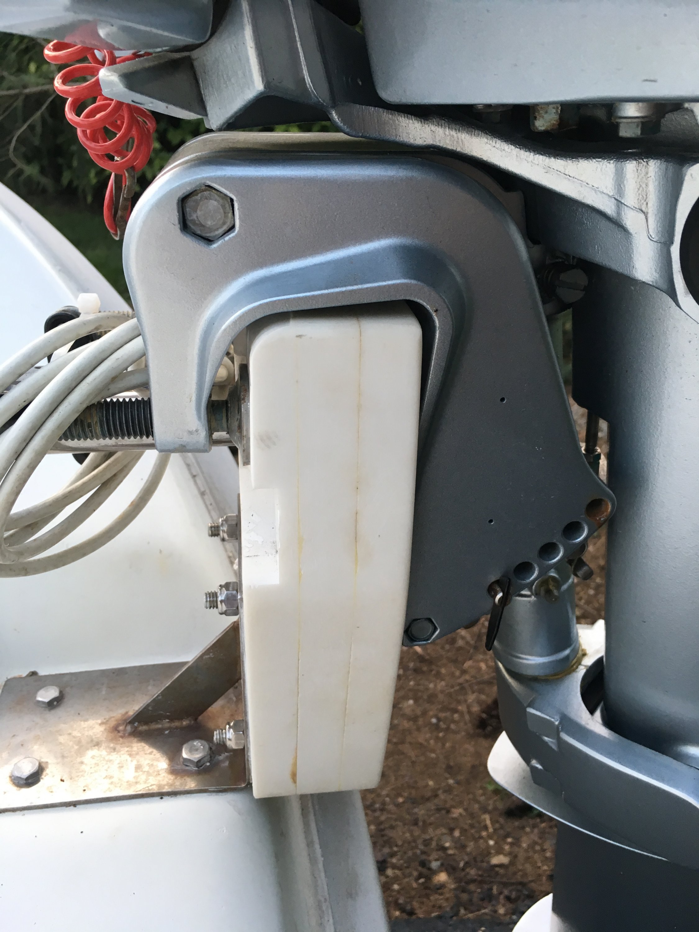

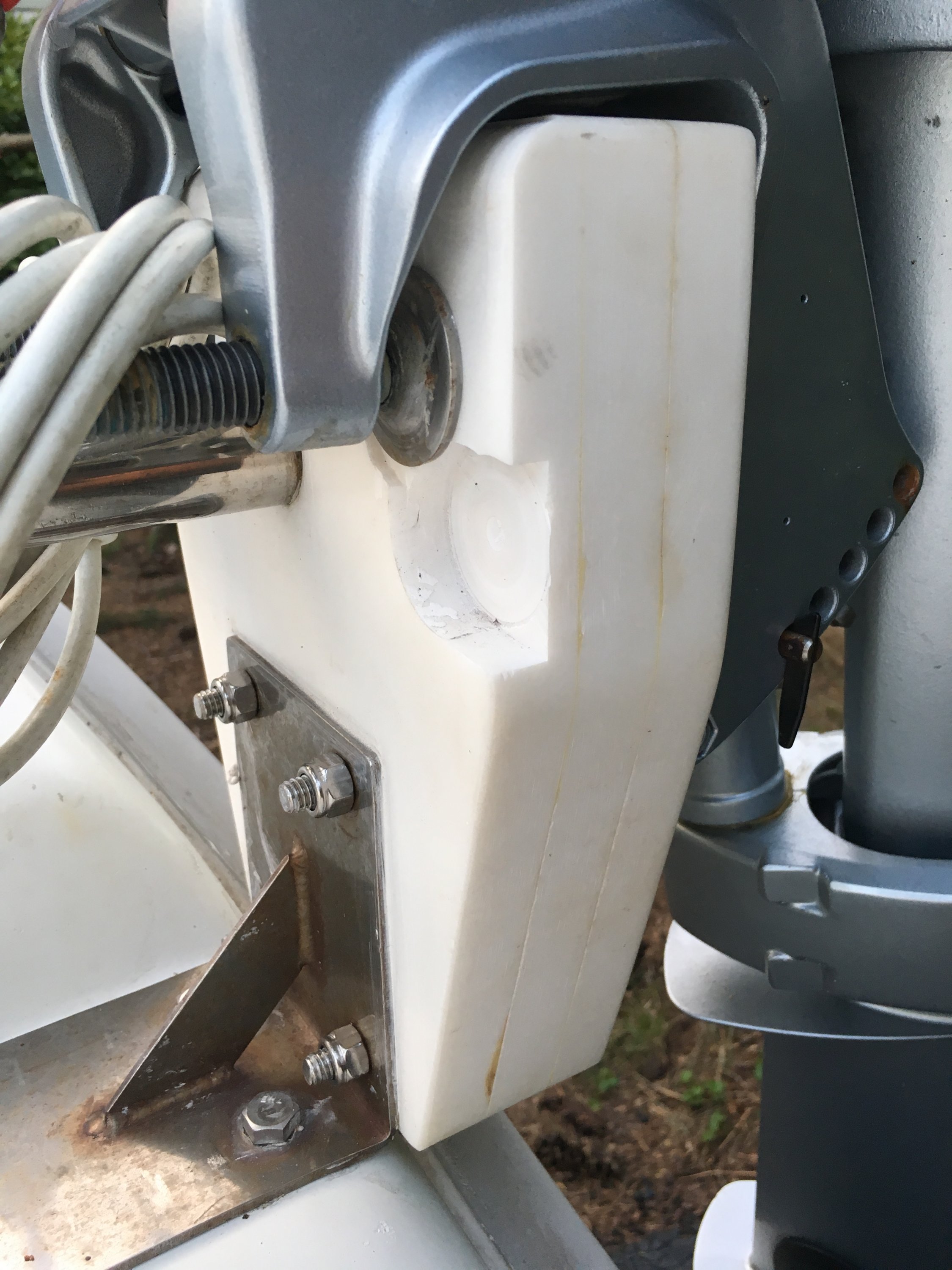

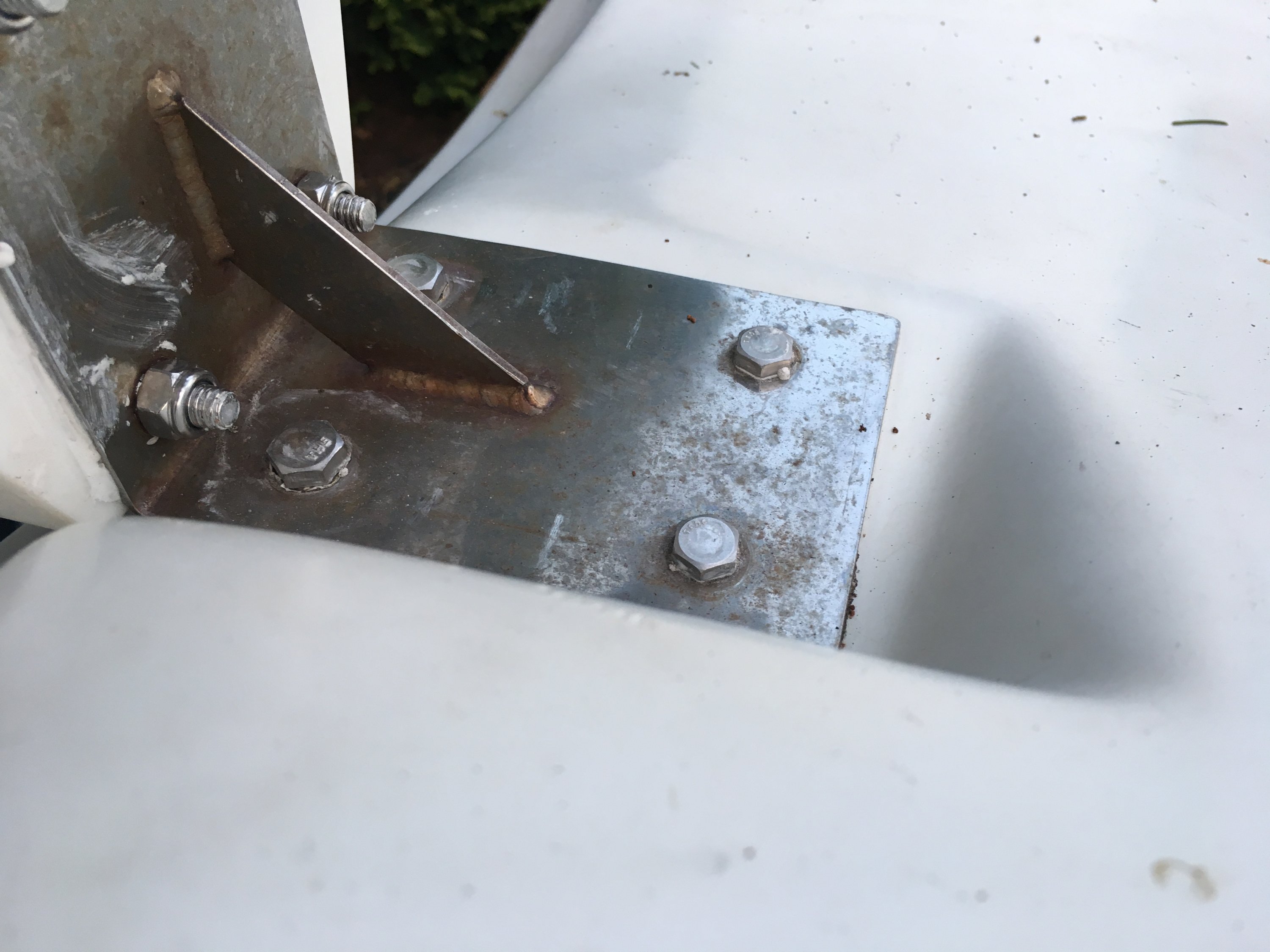

That's good that your motor mount has already been stiffened. We didn't tap the tube but just made sure that the screws fit snugly and used 5200 to firm things up. I'll try to post some pictures soon to make that more clear.
One thing to watch on your motor mount is to make sure that the white plastic piece isn't cracked too deeply - it's just soft HDPE, which probably absorbs some of the vibration from the motor, but ours had cracks almost halfway through it as you can see in the attached photo. The only reinforcement for the top 2/3 of the mount is the single long screw running through it from the top. Our new Corian mount is much stiffer but the noise and vibration from the motor hasn't been a problem.

Hi Jim, here are the pictures I promised to send of the modifications to strengthen the motor mount, and the mast/motor support for trailering. Hope they are useful!
IMG_6779.JPG IMG_6780.JPG IMG_6781.JPG IMG_6782.JPG IMG_6799.JPG IMG_6802.JPG
