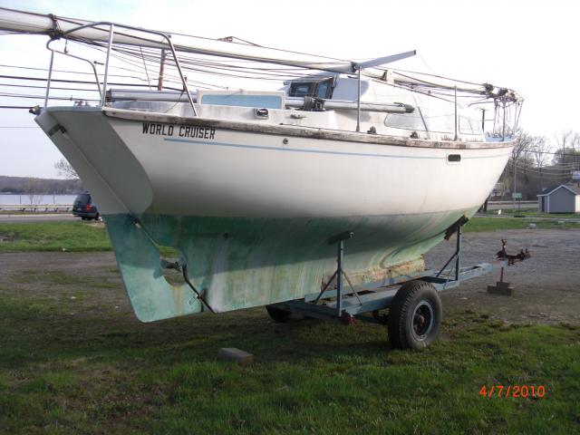

Here's a World Cruiser ...
I've been driving by this little beauty everyday lately and finally stopped to take a few photos. She is a Dockrell 27 and it seems that she will be making her home on tiny Budd Lake in New Jersey. While I was photographing, a fellow drove up and said he gave this boat away to the current owner (a guy with a small beachfront on Budd Lake) and that he has another Dockrell 24 that he could sell to me. I told him that I wasn't interested but thanks anyway. It was kind of weird to stop for just a moment (off Hwy 46 in Budd Lake, New Jersey) and have a guy immediately pull up in a pick-up and start talking about these sailboats.
8,010
There was a story like that here on LI. Everyone had been driving by this 37? ft. centercockpit for years. One day a guy I know stopped and pretty soon he was talking to the owner. The owner said if you want it, its yours to haul away. An so he did. A lot of sweat and some money and now's he got a pretty good cruising boat. You just never know until you find out the story.
