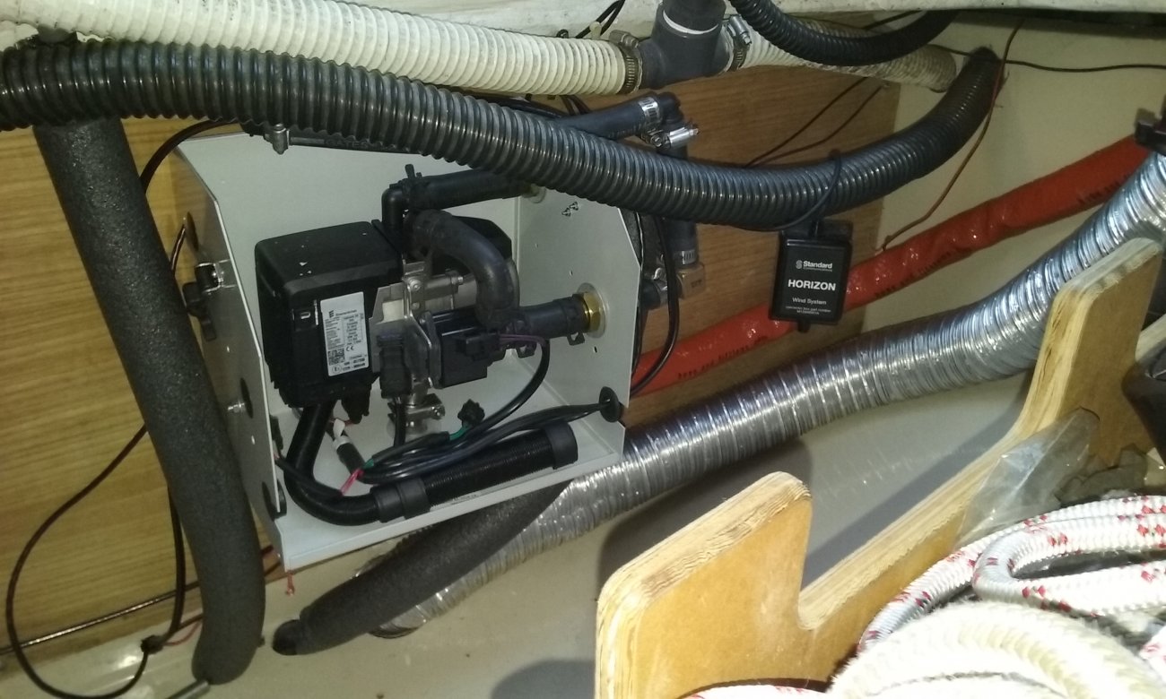

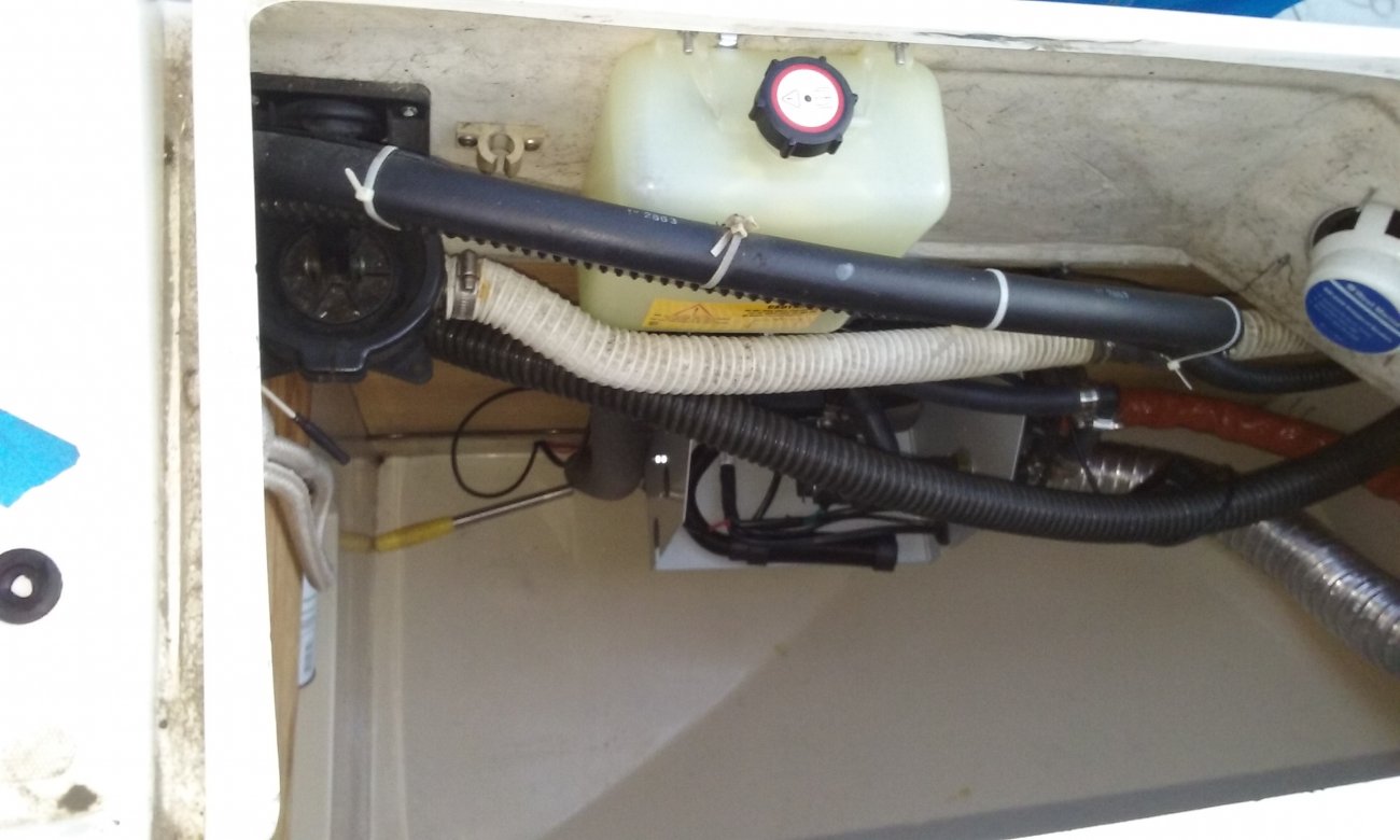

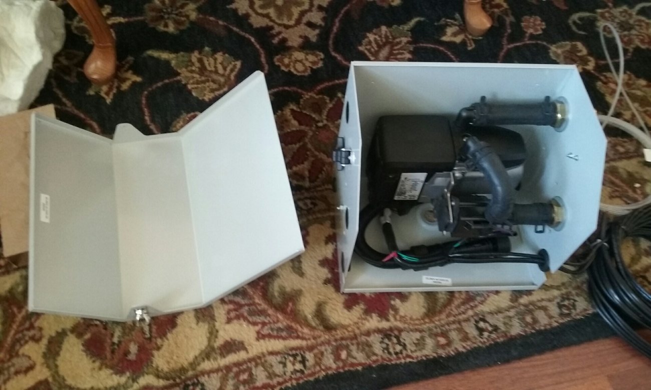

I have ordered the Espar S3 D5E boiler that provides stepless heat output from 8k to 17k BTU's in the boxed version so that it will have protection from all of the other stuff that goes into the port cockpit locker.

D5 should be a good one for you. It's better to have a right sized unit working hard than to have a bigger unit that doesn't need to. You get way less carbon issues in the burner unit when the machine is working hard. Good luck with the installation. Boxed version you ordered sounds like a smart choice.

Thanks Lurker. I have been reading the specs on the S3 and it is really impressive for such a tiny unit. It is only 8.5" x 5.5" x 3.5" and weighs about 5 pounds. I also found out that they have eliminated the atomization screen in the firebox which is what usually gets plugged up with carbon. They claim that it is 85% efficient which is very impressive.

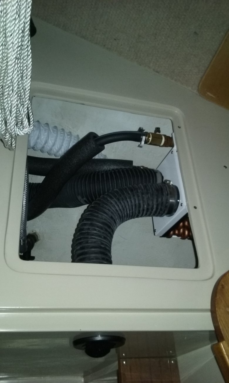

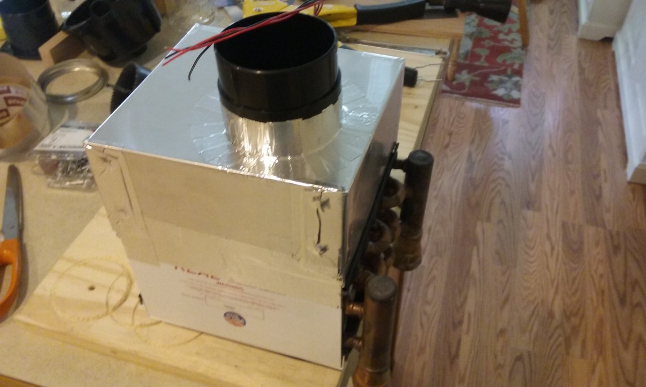

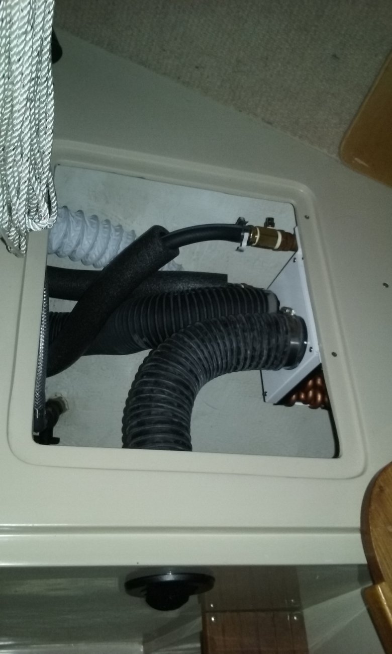

Espar hydronic-S3 D5E.jpg fan-coil shroud.jpg Here is how my install is going. We are hoping to fire the boiler tomorrow. We have one 10k BTU fan coil under the Quarter berth and a second under the V-berth. The V-berth fan coil has two fans / ducts that are kept separate with baffles. One of the ducts goes to the heat with its own thermostat, and the other duct goes to the main cabin and is controlled by the same thermostat as the quarter berth coil. The heater loop is controlled by a coolant thermostat that keeps all of the hot water for the heaters until the temp gets to 70C when it starts sending it to the water heater and engine loop. That way we should get cabin heat much quicker on cold starts.
Apr 5, 2009
3,329
I got my system fired up today and like it. It is no louder than my old Arctic but runs on less amps for a longer time instead of the 10/20 on/off short cycle.
