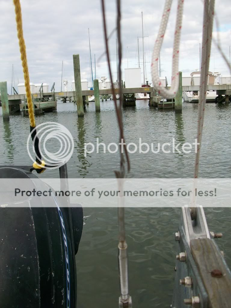

Then I notice a small tear in the main, about 2 inches long, 2 feet above the foot and 2 feet back from the leech. It’s not getting worse, I can patch that after I get in. But that’s nothing, I looked down at the backstay – I could not believe it – it’s completely frayed with only six tiny strands holding it together. Holy Smoke, I need to drop sail now, but I don’t want to turn into the wind and increase stress on the rig, so I head DDW and center the boom by attaching my pig-tail topping lift and pulling the mainsheet in tight. This effectively gives me a temporary backstay, but the sail must come down – so I release the halyard and pull the main down by hand – not that difficult on my boat, but doing all this while the auto-tiller is failing to keep me pointed downwind, and the steep chop threatening to toss me out the boat altogether. Once the main is down I tie the main halyard to the left over end of the jib down haul and tie that off to form a new backstay.

God is in control and arn't you glad those engineers used a safety factor?
Your pic looks like all the strands seperated at the same place so I'm thinking you have a "firend" at the marina that really wants to win the next race or something scratched the backstay and nicked those strands. Cables normally don't have their strands all go at the exact (like a cut) same level.

Do you think that it might part that was if the wire had been kinked at some point in the past?

There was a kink there, as I recall...so let's see, I'm over 50 and did not start drinking until after I got back in that day, so what does that leave? :D

Glad to hear you made it back safe and that was a close one. I looking at that fray I would suggest two things:
1 - Keep an eye out for whoever wants to kill you.
2- Buy a lotto ticket because you're a lucky man.

A common cause of kinked shrouds and bent turnbuckles on boats with hinged mast steps is raising the mast too quickly (trying to get it vertical to lighten the lifting load) without making sure the turnbuckle and shrouds aren't hanging up. Always a good idea to have a person on hand to keep an eye on them and straighten things out as the mast goes up. Also, if your shrouds have a lot of twist held in place by pinned turnbuckles, when you raise the mast, a loop in the shroud could draw up tight and kink. Might be good to, with the mast up, go around to each shroud and loosen the turnbuckle (counting turns) until slack, allow the shroud to relax it's twist, and then re-tighten being sure to keep the shroud from turning, then re-pin. Might make the next mast-raising go a little smoother.
You know your stuff. I don't raise the mast on my trailerable boat often as I keep it at a marina (done it twice, with a third time coming up), but I have a bent shaft on a shroud turnbuckle - I always wondered how one of the PO's did that - must have taken a LOT of force to bend if (it will be replaced).
I also never gave the kink in the backstay a second thought - my mistake, pay attention you trailer sailors.
