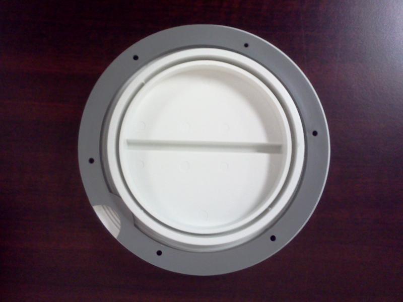

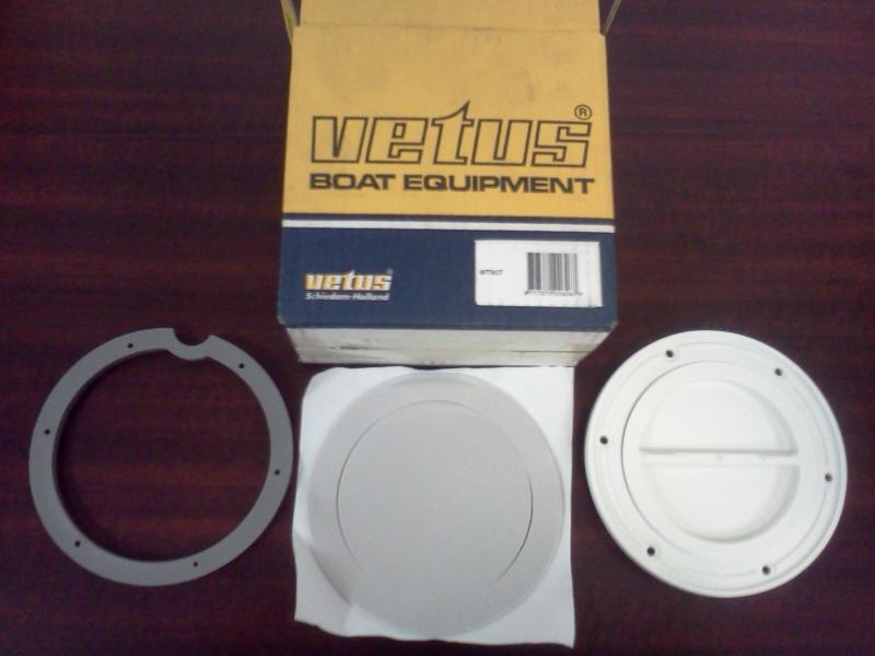

OK - here's an idea for a better mousetrap. Instead of trying to glue, mechanical means seems better and a given/known.
Use an inspection plate with a backing ring that fits inside the tank that you can screw into or throughbolt to, - essentially clamping over your newly cut hole.
If you need bigger, fit a bigger plate with an inspection porthole in it somewhere - your inspection port hole allows you to get a hand inside to fit any backing hardware inside the tank.
Availalble from any Vetus distributor - part number WTIKIT - comes with an inspection plate (white), foam gasket (light gray with a center punchout), and specially notched backing ring (dark gray) to allow you to sneak it through a smaller hole. Clever Dutch...
Here's some pics that explain better...
Hope this helps.
Dave
