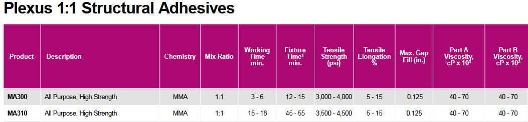

Plexus MA 300 (Devcon packages it as "Plastic Welder") should be available in small tubes. A methylmethacrilate, it is better than epoxy for most plastics, including acrylic. Nicely thickened and as fast as 5-minute epoxy, but without the lower strength of 5-minute epoxies. One of the most common adhesives in the boat and plastic bonding industry.
Obviously, very, very similar to MA 310. The difference is the cure time. MA300 is too fast for large assemblies. Another advantage of MA300 (Plastic Welder) is that it is easy to buy small amounts.
(from ITW)
