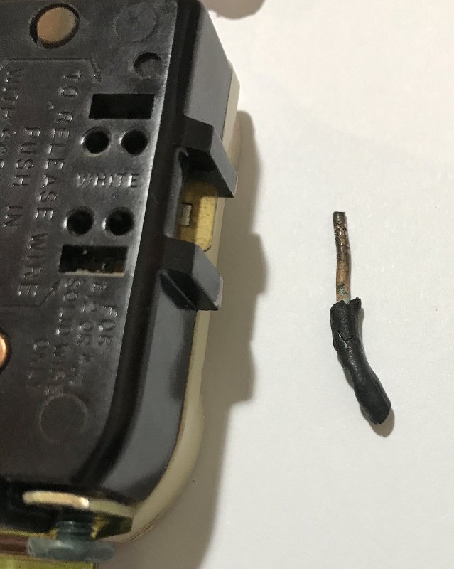

Some folks won't recognize or address a problem until the boat or marina burns. I had a guy today (a favor for a friend) who was trying to run a 1500W commercial microwave on his vessels 15A AC circuit. The circuit quit working. I found the outlets the production boat builder used were "stab-in" style and so cheap they did not even have screw terminals. The outlets were daisy chained and the first outlet smoked itself under the load on the hot wire creating high resistance and the owner claimed he smelled "burning electrical" just before the microwave shut off. I also found a fractured 120V hot solid conductor "jumper wire behind the AC panel that was causing "intermittent" charging issues unrelated to the outlets....
I explained that if I touched the electrical system, beyond a diagnosis, what ever I worked on had be brought up to current safety standards. There were numerous other safety violations, no less than at least 15 on the AC system alone. Some extremely dangerous such as a neutral ground bond on-board the vessel and a 30A service using 14GA solid conductor wire to feed the 30A single pole main breaker.. He decided to do none of that and grumbled that wire nuts are cheap.
Why builders went to this level of cheap is simply amazing. "Stab-in" only...
