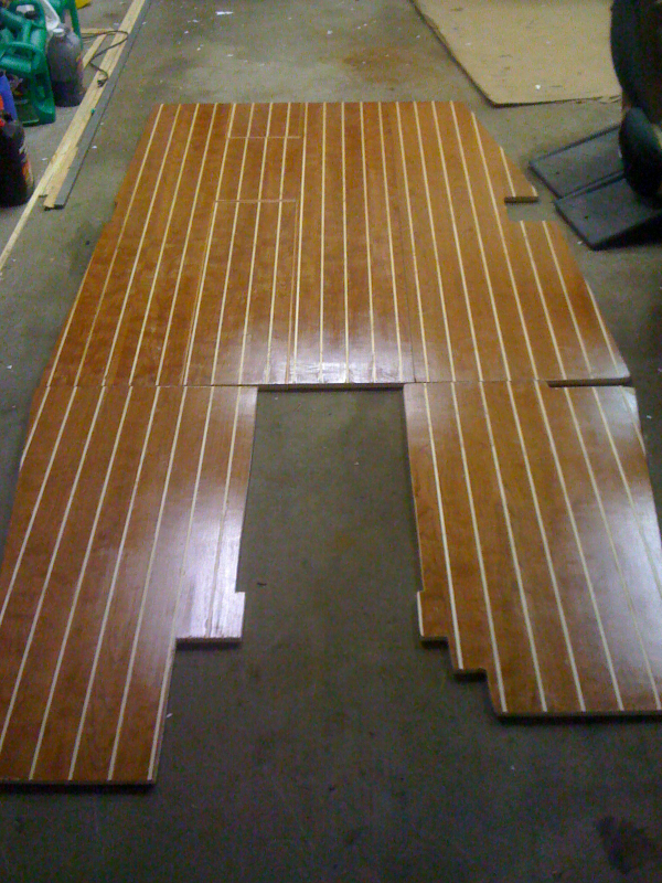

As a cost effective alternative to teak and holly I used 3/4 marine ply with a cherry face veneer. I put 1/4 inch grooves in it and then inset strips of maple.
