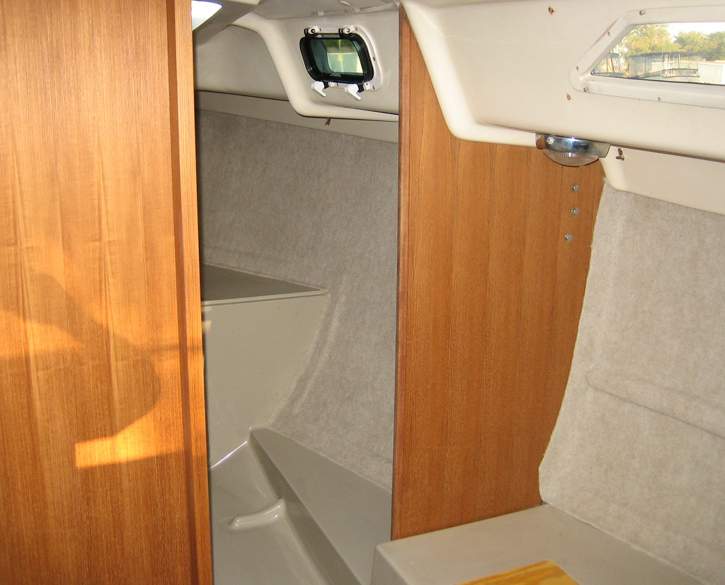

The carpet-like headliner material is what I used when I replaced my hull liner. Looks and works great. It's what several of us on this forum have used. I used a spray-on adhesive. The material stretches a little so you can push it into and around corners.

This is the supplier I used. http://www.yourautotrim.com/marboatcar.html
There r some great threads on hull liners and cabin liners in the o'day owners threads.
It is really worth the effort. And not hard if you get the right material: thin, stretchy, and flexible. Outdoor carpet is not stretchy enough IMHO.
Rich
Rich the Maestro

WOW! That is exactly the look I'm seeking. I think I found the same material as you but with a hint of blue in it. Just found and the company is sending me a sample. Thanks so much!
