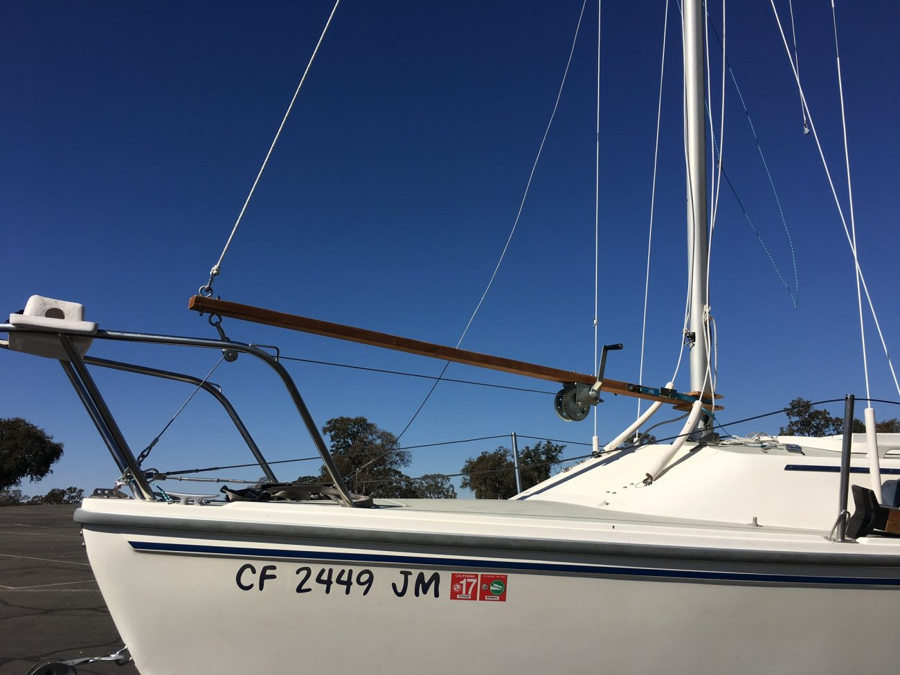

T_Cat's setup look similar to the one Blue Water Yachts sells for $$. I had one for my 26S. The winch with baby stays makes it easy for one person to raise and lower the mast even with a cross breeze.

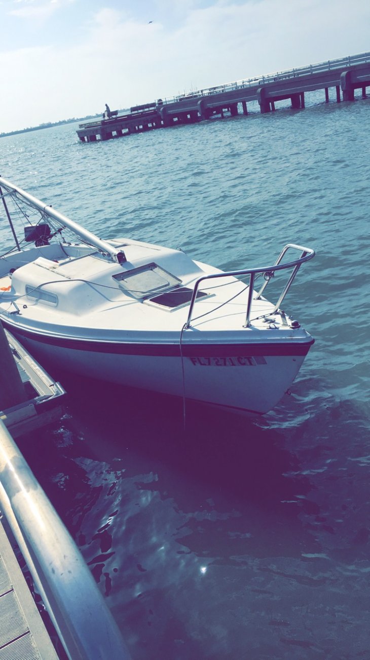

A small tender boat on the water is always going to be more difficult to step than that same boat secured on a trailer.....Years ago when we did gin pole step we di it thusly:

My pole looks a lot like @T_Cat's. I used a brake winch (like the keel winch on most of our swing-keel trailer sailers), so we're not at risk of anyone's fingers slipping off the winch handle while lowering. :yikes:
A brake winch is more expensive than ratcheting trailer winch, but usually less than $100 (I think Fulton and Dutton Lainson are solid brands). You can decide if the the extra $$ is worth it. I lost my grip on the winch while lowering our kayak in the garage one day. I just about broke my wrist trying to grab it - that convinced me to go for the brake winch for the mast.

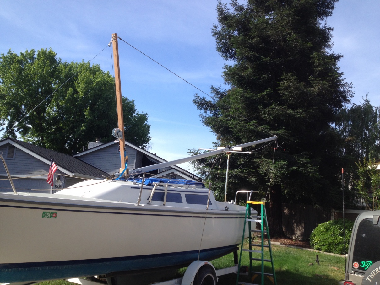

Here is a setup I had on my O'Day 23. I've modified to use only the mainsheet, instead of the winch on the trailer, on our S2. I second the brake winch. If you do use the mainsheet use a hand over hand method when lowering instead of letting the line slip through your hands. Ouch!
