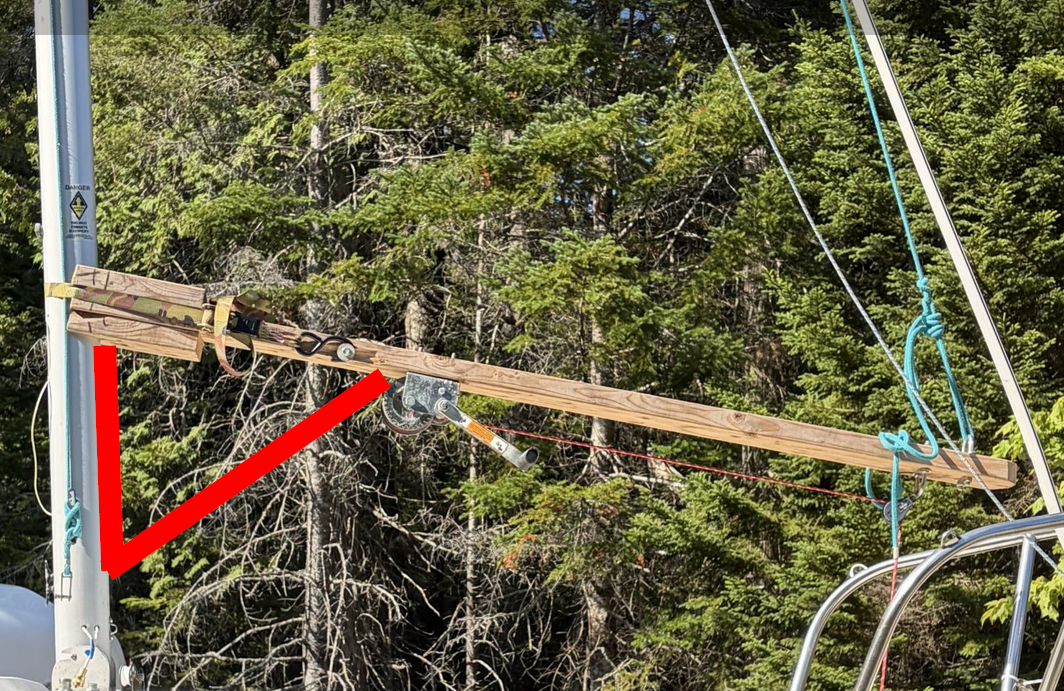

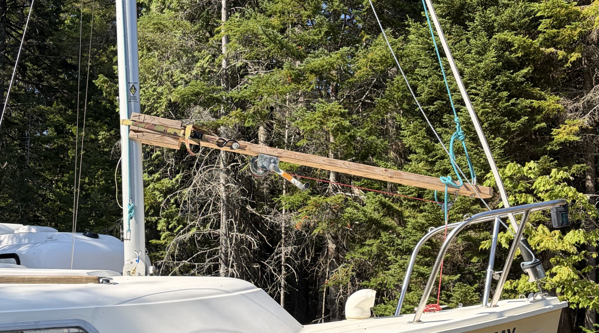

So many different gin pole setups all with individual issues. I cannot for the life of me get the gin pole to stop slipping where it attaches to the mast. I’m using a 5’ 2x4 with a saddle notched for the mast and, I use a ratchet strap to secure it to the mast. I cut 2 smaller 2x4 sections and notched those and added one top and bottom of the mast end of the gin pole for extra support. The lifting end of gin pole is connected to the mast by the halyard. The gin pole has a winch and a line from the forward end to the chain plate on the bow. I also have baby stays from the mast to the pivot point on the deck.
Any Solutions for getting the gin pole more secure on the mast? I am fully aware that the mast can be lifted manually but not by two 5’1” 64 y/o women so let’s forego that suggestion. TIA

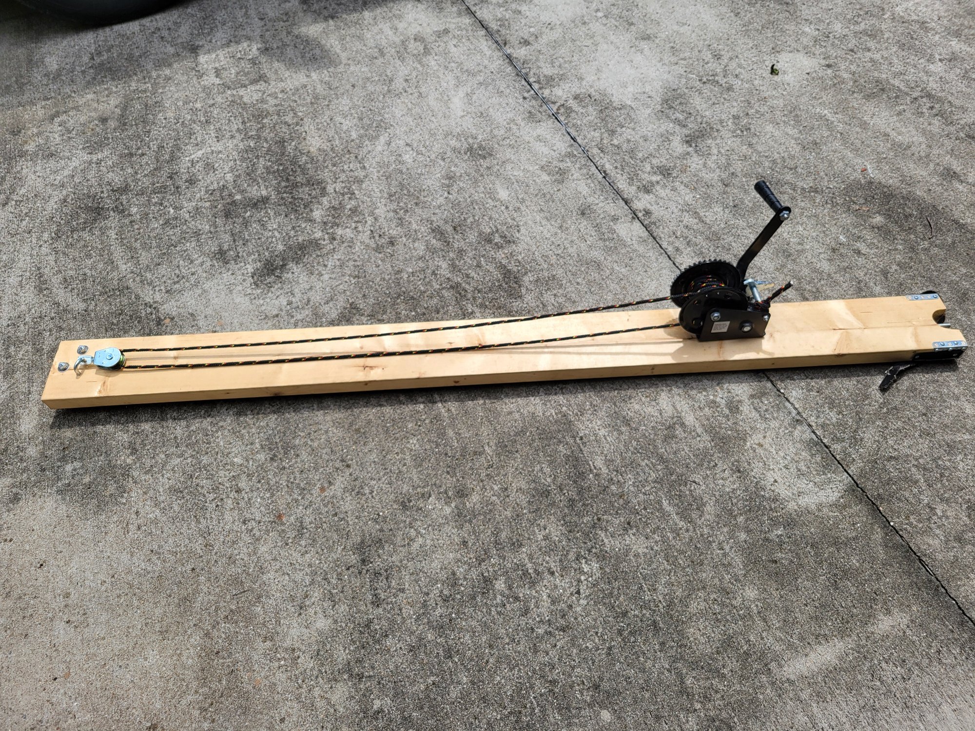

I went through what you are going through to try to get a working gin pole for mast raising. I was contemplating putting bands around the mast to try to stop it from sliding as I set up the gin pole. Seemed like a lot of trouble and not likely to work well.
Then I spotted a hole at the front of the mast - a little lower on the mast than I had planned, but workable. Measured the hole at 5/16", trotted off to Lowe's and bought some 5/16" threaded rod, and a 5/16" T--Nut. Cut the threaded rod to about 8" (double what I would bury in the mast) with my trusty hacksaw. Drilled and inserted the T-Nut into the saddle of the gin pole, and screwed the rod in at least half its length. Epoxied T-Nut and rod where it entered T-Nut to prevent anything from coming loose.
When I go to raise/lower the mast, I take the gin pole with the jib halyard already attached, insert the threaded rod into the mast hole, and tighten the Velcro clamp around the mast as tight as I can get it. Works like a champ.
You can see the threaded rod in the center of the saddle, and the velcro straps around the edge of the gin pole. My original gin pole was 2x4, that was not strong enough around the saddle, and the saddle broke in use (with mast crashing down, this was before baby stays). Rebuilt with 2x6 as shown in photo, and reinforced corners of saddle with angles from Lowe's.
Photo shows gin pole bottom side up. On the top side of the front (left) end of the gin pole is are 2 eyes - one in center for jib halyard, and a second eye to shackle the forestay to so it's accessible when I have the mast up. You can see the nuts for those 2 eyes on the gin pole bottom.
In your case, I would drill the mast hole between 1/4" and 3/8", and use the appropriate size threaded rod.

I suspect that your halyard is stretching as load is applied and that is the reason it is ending up at an angle. That may be a contributing factor.
However, I think we need to define exactly how it's slipping. Is the 2x4 assembly slipping, the strap or both? I suggest moving the bolt that the strap hooks attach to, closer to the mast end. The strap is less likely to stretch and is less likely to end up at an odd angle

Thanks for the suggestion. The halyard is stretching. I’ll try angling the gin pole up a bit and move the attachment.

If you have multiple halyards on the front of your mast, use both to reduce stretch.
Forming a 90 degree triangle out of 2x4's (with an additional ratchet strap at the top corner) would be more stable than angling the gin pole. Angling the gin pole reduces stability. Such a triangle would also help spread the load on your mast which is a good thing. If you can attach the gin pole lower on the mast, it would reduce mast bending under load but it looks like your furler might interfere. It's not a big deal if you can't lower it. It's just easier on the equipment and makes it a bit easier to crank the winch.
When stepping the mast on my O'Day 25, I had to loosen the side stays as much as I could as they would otherwise become taught halfway through the process.
However, we still don't have a clear understanding of what is slipping and how. Can you please elaborate?

Sure. If you look at my original pic, you’ll see that aft end of the the gin pile is slipping on the mast. Even when I added a second ratchet strap around the top block on the gin pole, it was still slipping.
I have added baby stays, which I discovered do need to be loosened partway up, or maybe I’ll use nylon line to help ease the tension.
I think what’s happening is that the blue line, the main halyard, is stretching a good deal. I angled the gin Pole upward on my last try and that helped even out the angle I needed what’s the halyard stretched itself out.. I wish my halyard were long enough to go from the attachment at the mast up through the sheave and down all the way to the fore deck, but it’s not. The red line I’m using to attach the gin pole to the stem head fitting does not stretch and is causing the gin pole forward to angle downward where everything is tightened up.
I wish I could configure asimpler set up I’m using employees five ratchet straps.

Stretchy halyards do make it difficult to keep the gin pole at right angle. Using both halyards can help, but I prefer a different configuration to allow me to adjust the geometry. Instead of dead-ending the halyard at the end of the pole, put a turning block there and a cleat on the top of the pole near the winch. You can then run the halyard through the block and back to the cleat. Keep adjusting to maintain the right angle as you load and unload to account for the stretch. I can pivot the mast with either halyard, but if both are available, I use them. A quick link on the pole end and another cleat is needed for the second halyard.
