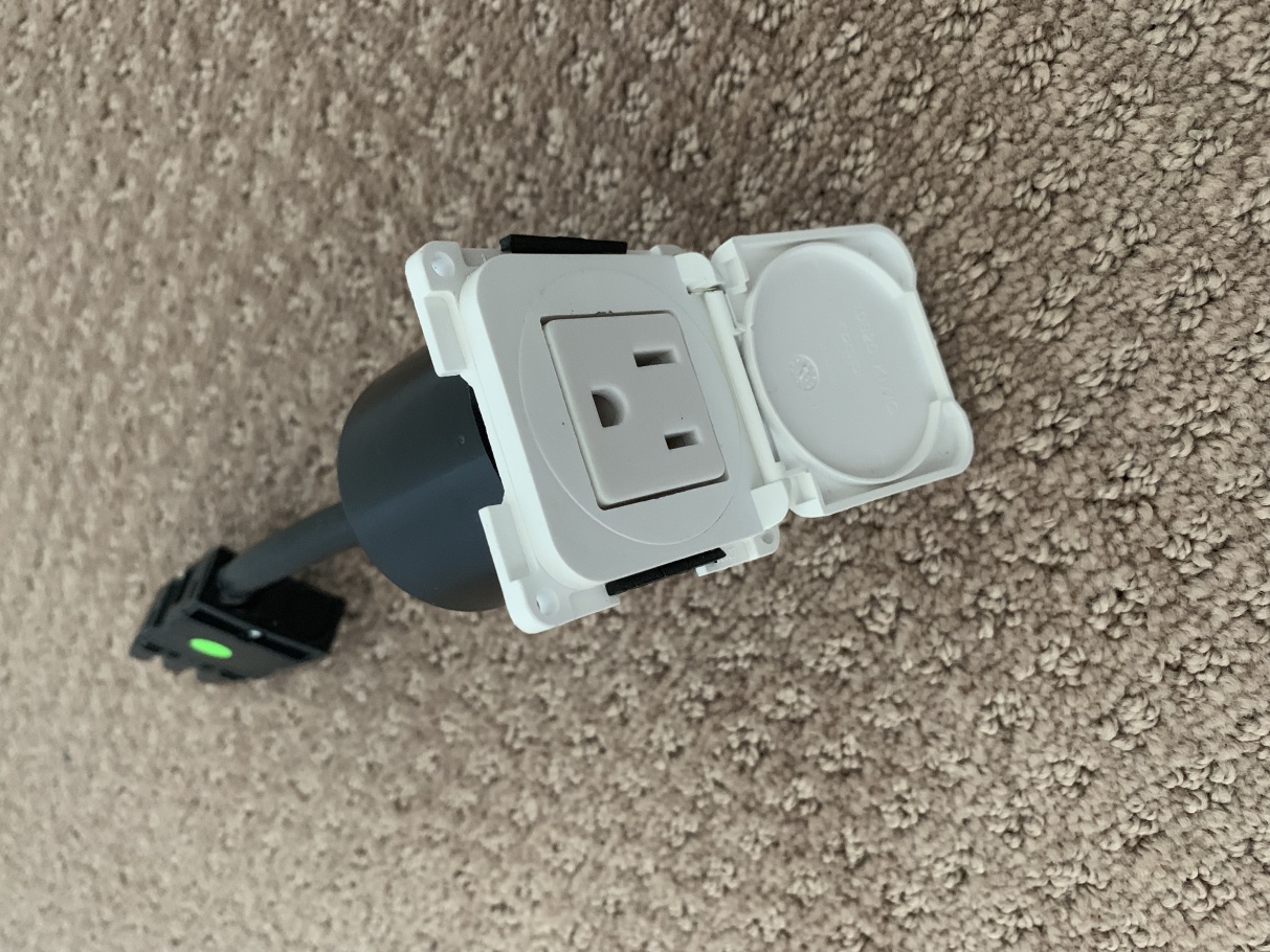

    and I'm pretty sure I won't find a GFCI outlet that fits where these are. I'm considering adding a GFCI outlet somewhere fairly hidden, which I'll never use... but will comply with their request...like in the back of a locker somewhere OR wondering if anyone has experience with a device that adds GFCI to a circuit but does not actually function as an outlet/receptacle... essentially just the switch part of a GFCI outlet.

Can't see the size or actual shape of the back of your outlet but might this fit, or be made to fit :Tamper Resitant Self Contained Sillites Outlet - BatteryJunction.com

@dlochner : I'll make sure it is somewhere "accessible"... but remember, I NEVER use A.C. outlets, as I'm on a mooring, and have no inverter... but yes, out of consideration for some future hypothetical user, I'll make sure it is somewhere reachable. I'll check out Xintrex and fireboy both... the more I read the more I think the main difference will not be BETWEEN marine detectors, but between marine units, and household units. Interesting about the "motion" of a boat impacting CO detector performance, I would not have thought of that... I assumed it was just 12v vs 9v, and maybe some corrosion resistance.

@Richard19068 : The outlet you linked to is not a GFCI outlet... but yes, a single like that is what I'd ideally find... I suspect it doesn't exist though.
