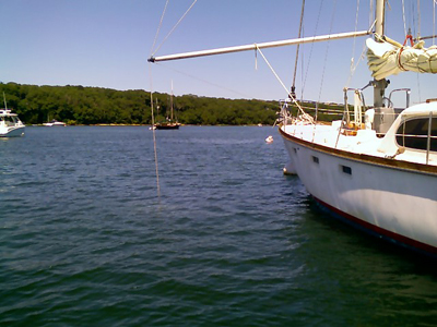

Have fun with the solar install. I've had solar systems on our current boat and the 2 before it. As far as placing the panels, your pic doesn't show a bimini, which is an obvious choice for flexible panels. I currently have 420 watts of panels on mine. Maybe a swivelling (fold down) rail attachment or pole setup or over davits, if you have them? Just pay attention to shading. Anything under the boom will give you poor performance, worse than you might expect.
