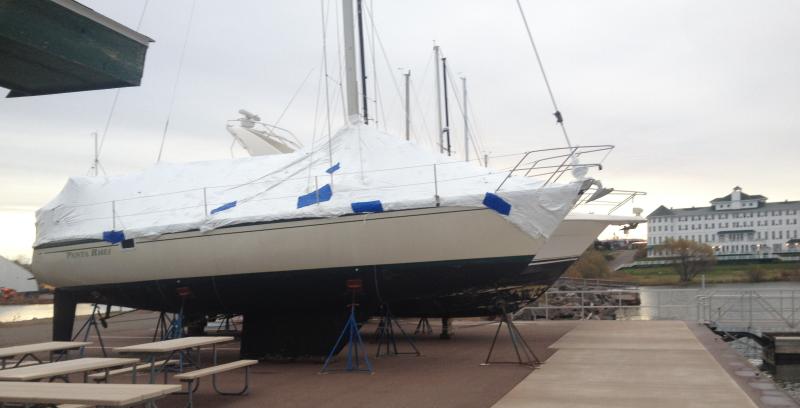

Still far from perfect, my shrink wrapping is getting better. I'm getting better at the wrinkle free finish I need. I modified my torch which helped a lot and used up the last of the white material. My tutor and professional shrink wrapper says the blue material changes color slightly as you reach the temp where it shrinks allowing you a better chance to get a smooth wrinkle free job. Structurally, I'm there, it will hold up until June withstanding the worse Lake Superior snowfalls can dump on her. It's cost me $130 per year to do a 40 ft boat. At that rate , I think I have the best way to go for me and Panta Rhei. I've got more cost info herehttp://panta-rhei.weebly.com/whats-new-with-panta-rhei--crew

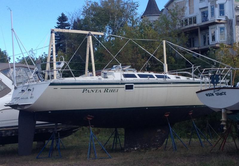

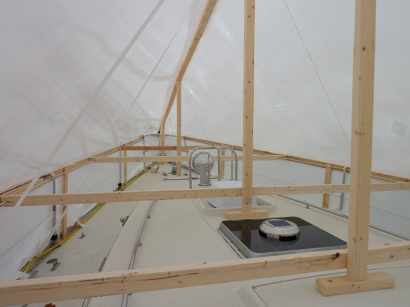

Unlike last year, I have the mast up and the boom on. I'm using the same sawhorse connection kit to support the aft end of the boom and extend support over the the cock pit. This also supports the middle of the bimini structure so I don't have to remove the structure. This is a bit controversial around the marina some think I should take the bimini structure down. I think it helps support a place where I could get a big snow load if it starts to sag. (I guess we will see when the first heavy wet snow comes) I included a photo of the structure from last year when the mast was down. The same 2x4 structure exists for 2014 holding up the aft end of the boom.

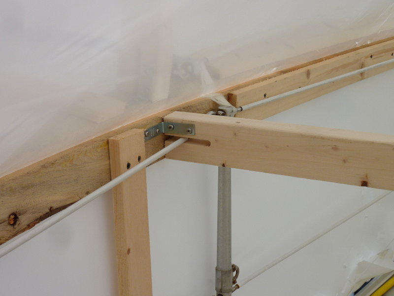

I need extend my messengers for the halyards so I can tie them off either forward or aft. My pro calls it four pointing the halyards. This year's arrangement is lacking and could cause some contact with the mast.

Another lesson I learned was to use spray on contact adhesive in cold weather. Spraying some on the shrinkwrap will allow shrinkwrap tape higher initial tack in cold weather. It also allows you to reinforce with sheets of material vs many side by side strips of expensive heatshrink tape. You can see many blue pieces I used to reinforce places or where I stretched the sheet too thin.
