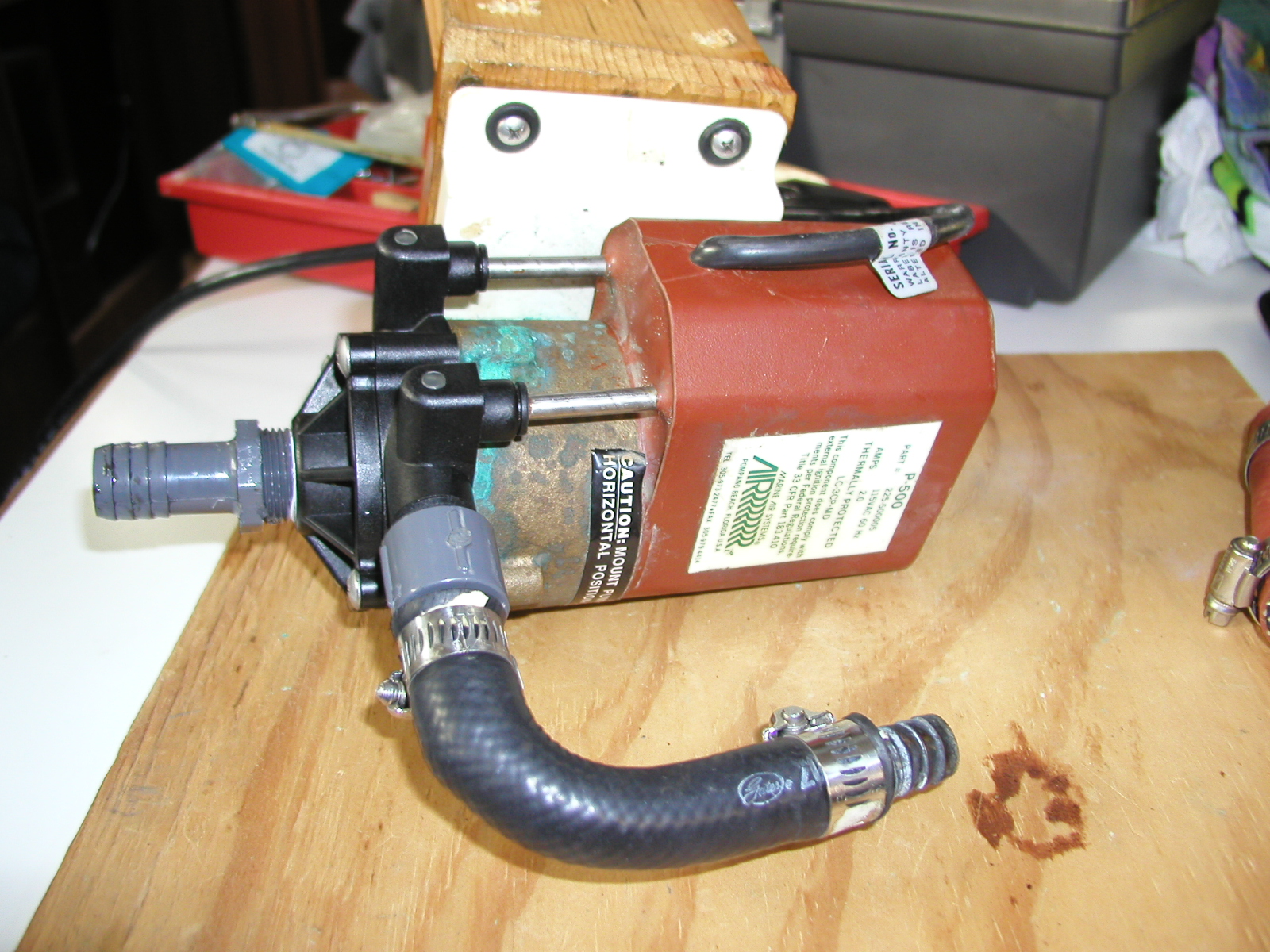

Hey, Tom.. Most air conditioners are installed by owners or dealers and that results in components being in different locations.. There should be a thru-hull fitting and valve, a hose to a water strainer, then a hose leading to the pump. You'll have to follow the hose from the middle of the pump back to the thru-hull valve to shut off the water before changing the pump. The hose from the side of the pump is where the water goes to the air conditioner, then through another thru-hull, then overboard. It is a good idea to check the strainer monthly for clogs.. The shore power should be disconnected when you change the pump, unless you have a voltmeter and can verify that no power is on the pump wires. Picture is of a typical March pump, left side where the water enters the pump..

thank you all for the help on the AC system Hunter 306. I took the deck floors up and traced the one hose from the thru hull seacock to the pump. I traced the hose from the pump to the in line to the compressor. I see the line reading out from the compressor to the thru hull on port side very forward. That line has no stop cock which i believe should. i will connect the new pump this weekend. my big question is the present pump has a two way fitting on the out side of the pump. not sure where the second hose would be going as there is only one hose going to the compressor. can someone take a pic of their pump with line in and one going out or am i wrong. thank you tom

I'm confused you seem to consider the discharge line as the "in" line but the "in" line in my estimation is the pickup line between the thru-hull valve, strainer and the compressor with the "out" line leading to pump and discharge port. I believe the pump may have two "in " line ports two service two A/C units with a single "out" port. If that is correct then one of the "in "ports should be blocked off with a plug. I reiterate that the A/C should start even though it may only run for a couple of minutes due to lack of cooling. Failure to start points to other issues and to the possibility that the pump may or may not be bad.
