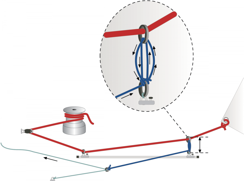

My 78 H30 doesn't have tracks and has blocks mounted on the toe rail for the Genoa sheets. I would like to rig twigs with friction less rings with a mechanical advantage to the toe rail to haul in the ring (down) for light winds and release it (up) for heavy winds allowing the rear sheave to dictate the sheet angle. I have seen this on a lot of racing boats and I think it is a good compromise for a track system that won't work on my boat due to the sheets being outside of the stays. I am interested in any input on experiences with this set up. What worked and what didn't. I figured I would make the twig a 3:1 and add a clam cleat after to secure it. I would use a ring for the sheet with blocks for its downhaul (not like the picture)

The idea is sound, but the devil is in the details of how you execute it and what hardware you use.
If you use blocks instead of the rings shown in the picture, the blocks will be flogging violently when the twing line is loose or when it's on the lazy side. The blocks will gouge the surfaces of the sidedeck and the cabin.

This is the input I'm looking for. Yup twings. So you recommended using rings only?

Mike... I think you are also talking about a Barber Hauler.
http://www.nauticed.org/sailing-blog/how-a-barber-hauler-works/

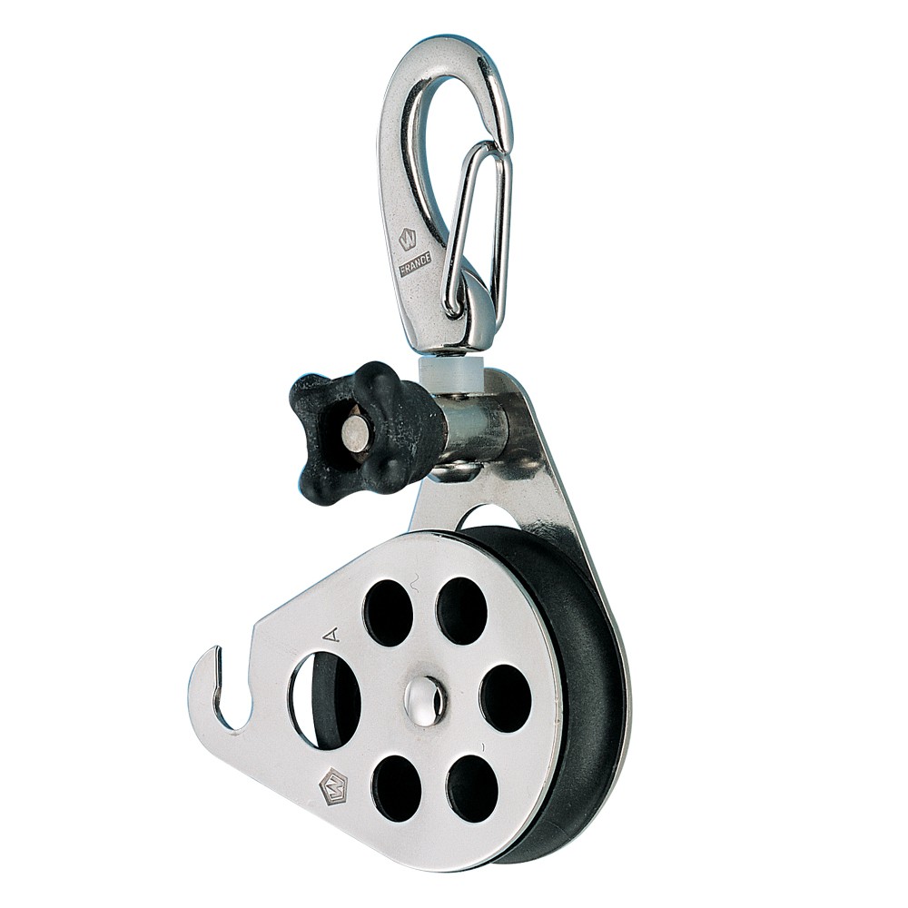

You can do it as you suggest. You can also carry a snatch block. If your aft block is not the right angle you attach the snatch block to the jib sheet and then locate it along the rail where the line needs to be.

If your current blocks are fixed, I'd suggest to move to snatch blocks so they can easily be moved along your toe rail. Your toe rail has a lot of holes so you can get a lot of adjustment that way. I agree with DrJudy in that if you start getting more complicated, you are moving into a difficult to control system that may well flog your boat. Plus all the complications of the lines etc, and that's on both sides of your boat.

My thought was to place the ring rigging forward on the toe rail in a place good for light wind and a aft block proper for heavy like described above. When on heavy wind I could release the ring rigging, allowing the ring/sheet to rise and conform to the aft block angle. Maybe I'm missing something?

So I set it up today like the picture I first posted but went with a 3:1 between the two rings.
There was light winds so i was able to set it up a little bit not enough around for consistent performance. With the ring system soft shackled foward off the clew location on a beam reach, the system worked well to adjust the slot and also adjust the twist off by tightening up the luff. No flogging of any of it when I released tension on the system because the ringa would slide down the sheat and sit on the gunwale. The whole system is attached to the toe rail so it it outside of the lifelines so it cant hit the cabin of the boat. More to come and I'll hey some pictures.
