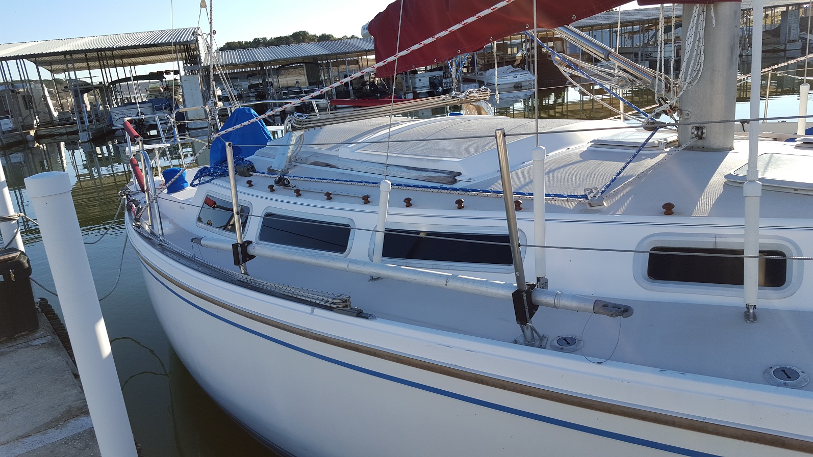

840
Catalina 30 Stillhouse Hollow Marina
Not even a hint of binding here. These are curve a lot more than you would need to.

John, I have a 1980 Mark II very similar to your cabin design. When I redid my deck, I did not want to use the toerail t-track for my ginney.
I installed a new t-track along the curvature of my cabin & have NOT had a problem with adjusting my cars.
I do find a better inboard angle for sailsets & all has been well the past 3 years.
My one suggestion is adding proper backing plates below to take up the added strain.
However, it's quite easy to slightly curve your ginney track.

Cloud,
I don't see a radius angle so, a straight track should work in your setup with no problems.

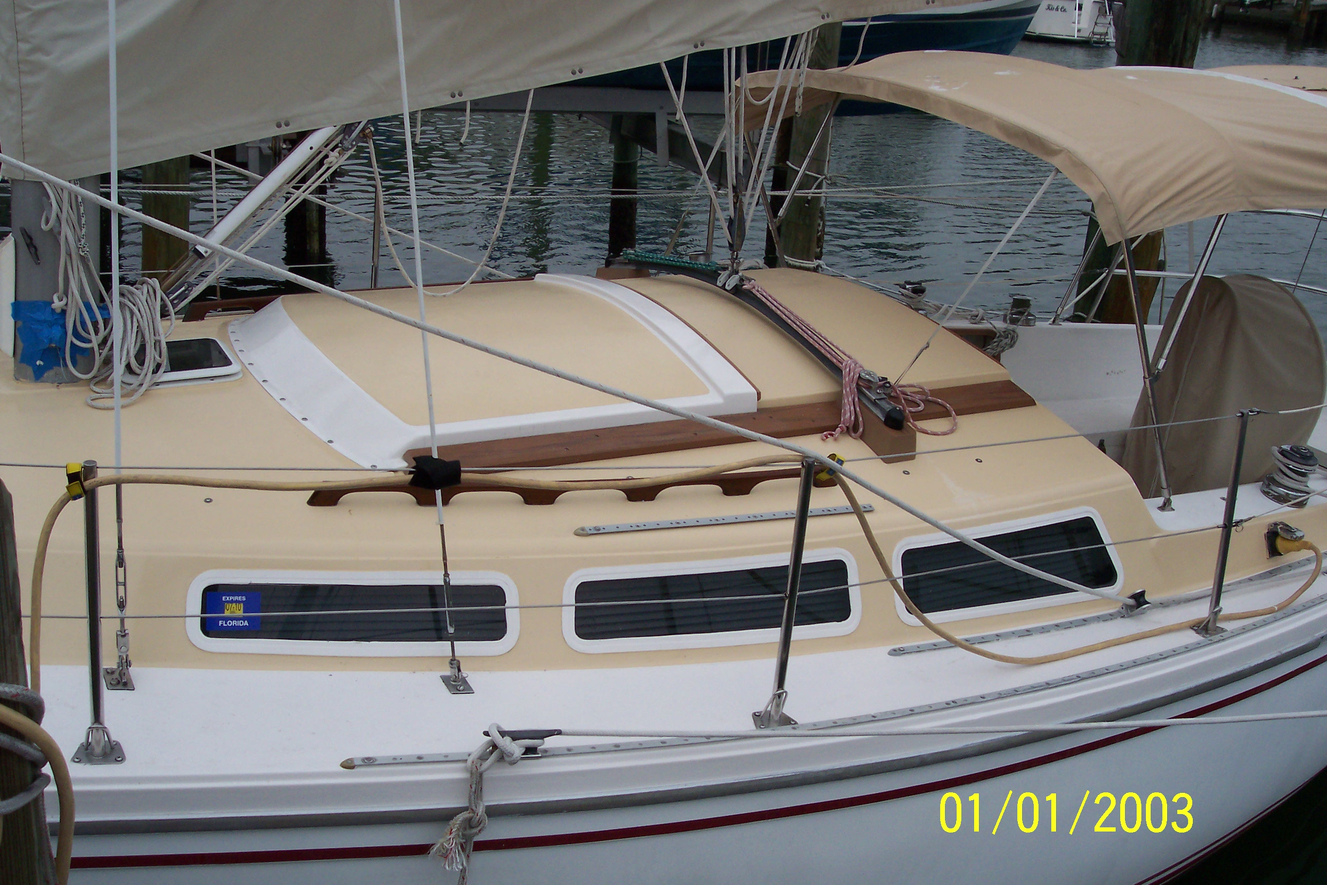

John,
The only pic I have was when I re-did my deck.
As you can see, the track was offset enough to not impede my car.
Note the changed color format not found on other Cat 30' Mk II.
CR
I think Ron, that John's question is exactly what your track shows; that is your car is shown in the only position that makes a fair run to the winch. Without a turning block to help, the rest of the track is unusable. It looks like you might have one, but out of the picture.... where does the sheet go?
CR
Also Ron, you said your boat was a 1980 MK II. They didn't change from MK I to MK II until 1986. Even though mine is a 1986, it was built in October 1985 and still of the MK II design. MK II has two large windows, and 2 small each side, vs the 3 large and 1 small on the MK I. Also the MK II had t shaped cockpit at the rear. Am I missing something?

John,
The paperwork I have states a Mark II. Not a big difference from Mark I. The design is close.
Jack good question pal,
My turning blocks are now aft the winches & located on the rear of the toerail track. The beauty is that the line from the cars runs close inboard along the cockpit coming sides then angles to the turning blocks back forward to the winch. When stepping out of the cockpit now to go forward, there is no angled line to my winch that interferes. My orig. line went from the car & angled to the winch which was not good for leaving the cockpit for deck work. But that was the orig. setup.
Catalina 30's have a narrow deck for going forward especially stepping out of the cockpit. Now, I don't have to deal with stepping over an angled sheet. I have a double winch setup on my cockpit coming top, one for the ginney & one for the staysail. My spinnaker track is on top of my cabin. I just found that this t-track relocation was a better way for giving better access forward & not having trip points mostly for guests.
Using car marks from my orig. toerail track, I positioned the inboard track parallel to the toerail track for adjusting the t-track length to work with my cars @ different points of sail. My tracks are 6 ft. long & I've been very happy with the positioning & the length.
Stepping out of a Cat. 30 cockpit, you only have about 10" of foot room. That's not that much especially on a heel or in spirited conditions.
