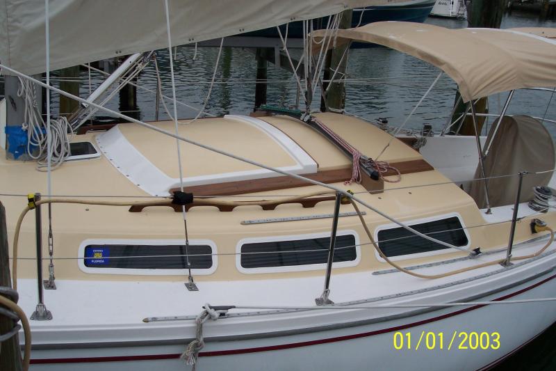

I installed new tracks inboard & I get a great sail shape now. Also being inboard, I can adjust the fairlead mostly from the cockpit. I looked at alot of newer boats with inboard tracks and patterned mine after them.
Check out my setup.
Also shown is the teak changeout using "sensibuilt" a manmade decking & facia board composite. I used the teak as a template for making everything. The only exterior teak left are the shortened handrails. The original length rails were always a trip point around the mast area, especially my guests would always trip over them.

my factory track is way further forward and way longer than the one you installed.

Thanks for getting back with the photo Captnron. Your boat looks great. You have installed the new track exactly where I wan to put mine. Questions: When drilling to mount the track how did you handle the cabin inside panel covering the bottom of the deck? Did you cut it away to get to the deck underside or just drill through it? Also, what did you use a bedding for the track and have there been any leak problems?

On your earlier post, when I installed the new tracks, I drilled thru holes and had easy access for securing the nuts from below. I had some old 1" track with matching holes with the deck top track. I was able to use the old track below instead of washers for linear support, but you decide how you want to secure it from below. I don't feel that with the sail loads, washers are the best way to go, but rather a better or continuous backing plate of some form.
Not sure what you mean by "Did you cut it away to get to the deck underside or just drill through it?" As for the bedding, I like the Dow Corning 795, a good UV construction caulk. There was a thread earlier dealing with best ways to bed thru deck fittings. Check out that thread, there was some good info there. As for leaks, no I don't have any. It's all about the prep & application.
Don,
I assume you have your track on the toe rail as me. With my inboard track, look at my pic, the sheet doesn't interfere with the lifeline or stanchions on a variety of settings. I don’t know what size sail you use, which could put the track in a different location. Or, just get a longer track. I started out from the rear hole. I drilled it then flexed the track to match the cabin radius as I went. Drilling one hole at a time. The track flexes rather easily. Also, the camber in the track doesn’t interfere with sliding the fairlead.
Mort,
You have a newer boat, and design changes were made, your tracks were already inboard of the toe rail. The builder will have a longer track as it gives you options on using different size sails. I needed to add the inboard tracks for better point ability. My track was on the toe rail, that was my only option. If you re-read your earlier post #4, I'm not clear on it. The best would you to supply a pic of you boat, or revise your earlier post with more detail pal. Also, I never pulled my toe rail track as it doubles as the hull to deck attachment. I also use it for my spring line cleats.

captnron, one of the things i was gettilng at is that my track is recessed in a substantial groove to keep it flush with the deck, did you create such a groove or is your track laid on the deck? unfortunately, as i said, this groove eliminates use of the garhauer fairlead system,
