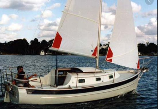

The photo below might help describe how the jib/geneoa is rigged on a Seaward 17. It appears to show jub sheets going to a turning block on each side of the boat's deck next to the cabin then to a winch forward of the cockpit.
