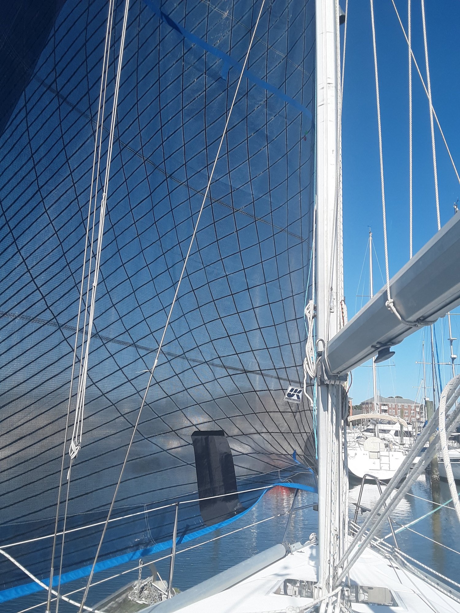

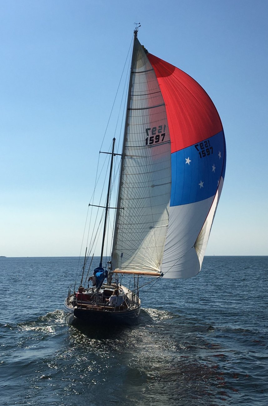

so i go to their web sight. they say good to 12 knots of wind. apparent? true? we will assume apparent which works out to maybe 8 true. their whole sales pitch and the name talks of sailing in very light winds. very limited usage in the real world i think.
my old alden will sail up to 45deg true wind, using jibs, up to 155% genoa. let's remember that we increase app wind driving to weather,
on my old alden my Aspinnaker will sail from 60deg true wind.
on my old alden my spinnaker will fly from 80deg true wind.
the symetrical is way faster than the Asymetrical.
the Asail is easy to fly.
the "generater" (i hate marketing wizards, hate the name) has a very small use range, very light winds and once your in the 60deg true wind zone the Aspinnaker will be faster. remember, your jibs will work fine in 6mph app.
on modern racers they just use Aspinnakers, they are that fast.
on modern cruisers the aspinnaker is easy and faster off the wind.
so, your jib will work to weather in about 3 to 4 knts of true wind, in a beat. at 60degs of true your Aspinnaker will work all the way to deep off the wind.
I vote Aspinnaker. the generater has a very limited work zone.
those MBA's, always trying to sell us stuff we do not need.

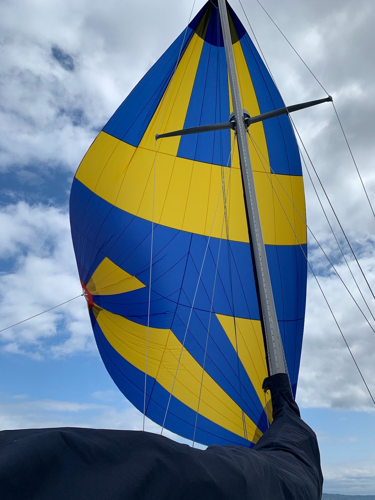

With a sailing location like Nova Scotia, I suspect you see a fair amount of breeze up there. Looking at my suit of sails, the decisions are money, sailing weather, boat usage, and compatibility. Not necessarily in that order, but all are interconnected.
The "Generator" is a new name to me. There are a lot of new marketing names used to distinguish the product in the market place. The one identified here would have limited usage on my boat. I try to get maximum usage out of the gear I buy of the boat.
Here is an interesting link discussing different sail types for different uses on a Catalina 36. The descriptions and the chart of their applications on a boat might help to guide your decision for your Hunter 306.
In my waters and based on crew skills I selected an Asymmetrical for my light wind sail. I found that the specific cut did (in light wind) get me to sail at about 75 degrees to the wind. Better than I expected. As I pulled further off the wind (below 90 degrees) the sail found it's zone and I was very happy with my purchase.
