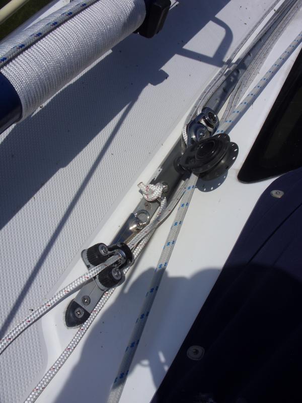

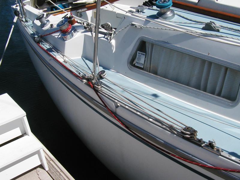

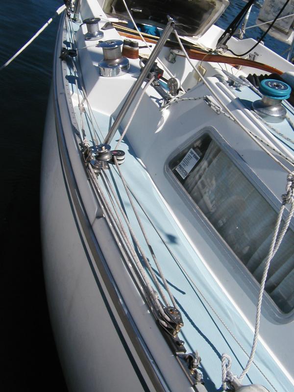

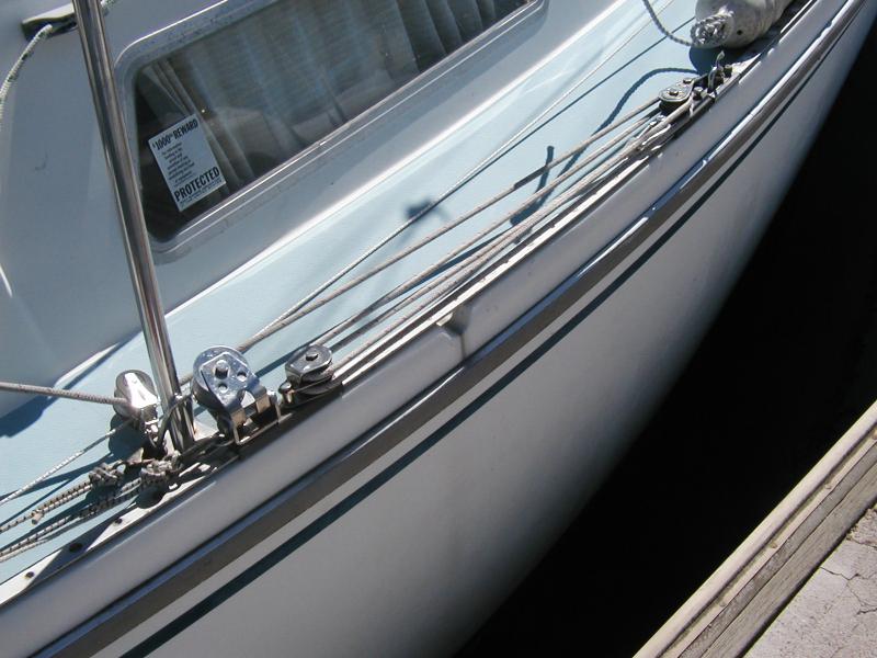

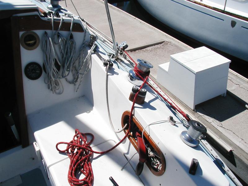

All of us who have the Garhauer EZ glide system will give it a huge thumbs up.... the price is especially attractive when compared to competitor system. Like more than half!!!!
The system will allow you to pull the car forward while the headsail sheet is under load..... a huge advantage... and, theoretically, the upward pressure from the loaded sheet, with a little help from an elastic cord, will push the car back when the control line is uncleated. In truth, though, this does not happen unless the sheet exits the lead block straight back, without angling up to a winch.... as is the case on my boat.
The solution was to lead the sheet back to a turning block before turning upwards to the winch. That eliminates any upward pressure from the sheet preventing the car from moving backward. In pic 2, note the path of the red genoa sheet....
The elastic return line is doubled through a small block clipped to a stanchion base few feet behind the system and anchored to the car and another stanchion base. The doubling allows a longer range of travel.
Finally, to prolong their life.... it is recommended to remove the control lines and elastic cord when the boat isn't being sailed for any length of time. I've had this system for well over ten years and the rigging is still in excellent condition. It only takes a few minutes to set it up.

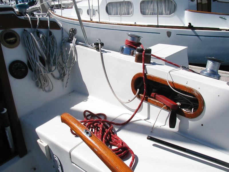

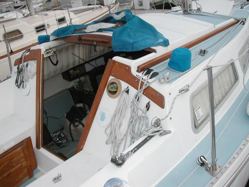

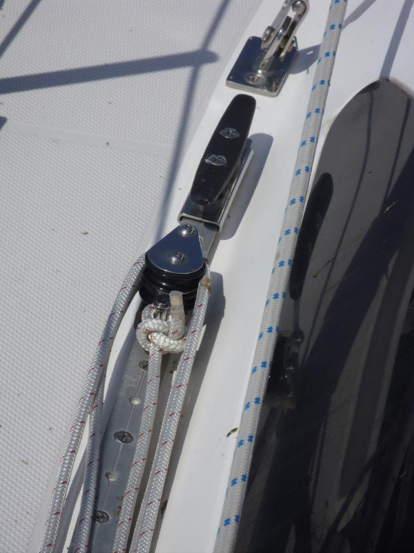

I bought them....... a good deal for $50. However, I don't use them the way they are depicted in the catalogue.... because that would place the control line outside the coaming on my boat and directly in the path of the headsail sheet and the elastic return cord. I'll include a picture so you can see that I have them mounted on an inside track with the control line easily at hand and out of the way.
Unless you absolutely knew they would work for you, I wouldn't purchase them... you can always order them later.... that's what I did when I figured I could use the short inside track and avoid drilling more holes.
If you read my previous post in this thread you'll understand why you don't want the cleat on the same track directly behind the car.
