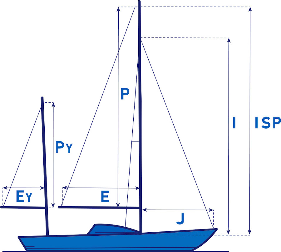

Hi again guys
Where to find the right measurements for new or used gennaker for my 1985 Pearson 303. Materials you recommend, weight, ect. How hih on the mast should be attached. Suggestions of used sail lofts or good pricing for new one

You will need your J , I or ISP measurements.
Put your measurements into an online calculator and you will have a basic sail plan.

The size of your gennaker will be determined by maximum luff. Most ready made gennakers are built to general sizes, like small, medium, large etc in clothing. The foot and leech measurements will both be shorter than the luff because the sail must float out and up and you want to keep the foot out of the water. Whoever builds the sail has this restriction factored in.. so they would not construct a sail with an exessively long leech that allows the sail to sag too low.
Your subject boat is a masthead rig, and thus must have it's spinnaker secured up top with a swiveling block mounted on a crane that will place the sail in front of the forestay. I trust you to do more research on this. Search with keywords like: rigging gennaker, how to set up an asymetric spinnaer, cruising spinnaker, etc. There's a nice little piece on www.thesailwarehouse.com about their spin packages and how to rig them. Don't forget you'll want an "adjustable tackline" and a pair of "tweakers" for the sheets. Again, these are good search keywords.

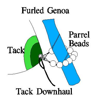

So how do those parrel beads or the tracker go over your sheets on the rolled foresail?
dj
Joe
Jun 1, 2004
8,207
dj
It's a free flying downwind sail. The parrel beads, sleeve or the tacker rotate forward around the outside of the rigging following the sail when you gybe. The sheets on the furled headsail are in the foretriangle over the deck, and downwind sails don't go there unless there's a screw up.

The sail operates outside the fixed headsail and its sheets. It's free flying, meaning the luff of the sail is not attached the boat's forestay. The sail is gybed, not tacked. Even when the tack is attached to the forestay via the beads, a sleeve or a tacker, it will rotate around the forward side of the stay or furled headsail. You never tack the sail inside the foretriangle like you do an upwind sail. The clew of the sail is allowed to fly out and around the forestay and its sheets are always rigged outside the other rigging. When you gybe the sail you ease the sheet out far enough for the forestay to pass behind the clew as the boat turns under the sail on its new heading. It's a downwind sail.
@Joe I understand how the sail flies, what I'm not understanding is the role the parrel beads or the trackers are doing - specifically if they are being used as a downhaul, how do they pass over the sheets on the foresail?
dj

The sheets remain attached to the clew of the furled sail, above the tacker.

dj, it's not tracker, it's called a Tacker... there's no R. The manufacturer is a company named Atninc and the device's official name is the ATN Tacker.
To answer your question: Neither the tacker nor the parrel beads would rise high enough on the forestay to be interfered with by the wrapped sheet. A few feet above the pulpit at most. The parrel beads were mentioned because they've been the prevailing attachment method on furled heads sails since the beginning. Along with a spinnaker pole, of course.
Anyway, it makes sense to simply observe it in operation. Here you go:
dj
There is a downhaul on the sail or the ATN Tacker. When jibing, the sail flies in front of the forestay. This was the precursor to the ubiquitous Asym flown off a bow sprit. I have one with a symmetrical spinnaker. It works, I never use it.

Great video, now I see where my confusion was. Thank you!
dj
