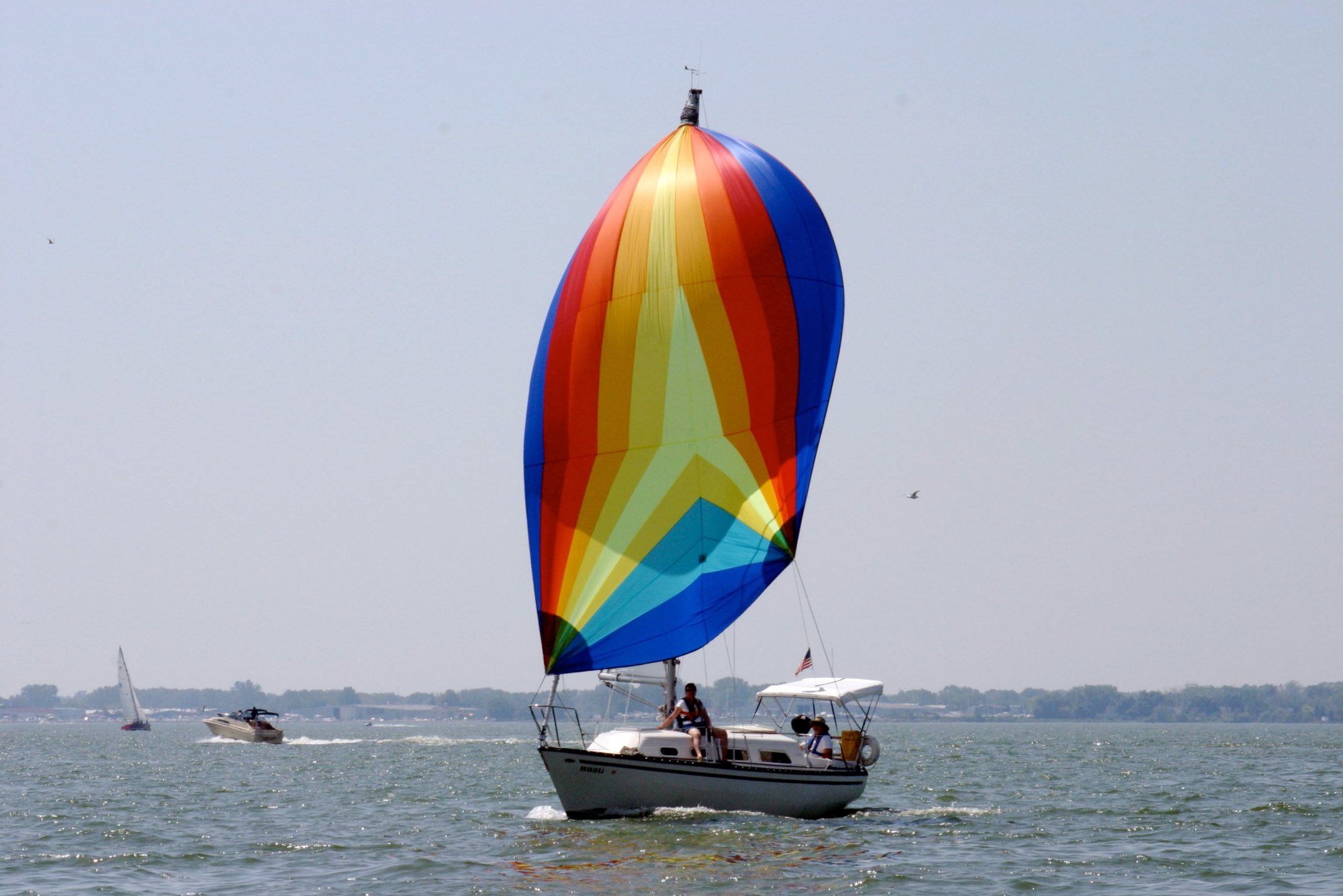

When racing, there is usually crew to make any sail changes needed. When cruising, we can roll up our genny and shift to the asymmetric in about 10 minutes. When it is the right sail, the asymmetric adds around 2 knots to our speed in light airs - conditions where the iron genny is often the only other alternative.
Here we are, near hull speed, wing and wing in Sandusky Bay:

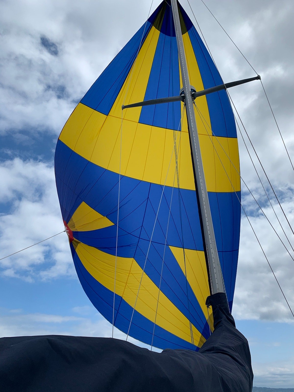

I went the Asymmetrical and Sock route. I solo sail. It is a practical and budget sensitive way of going. It provides good advantage in light to moderate winds.
Looked great when first raised and the wind caught the sail.
