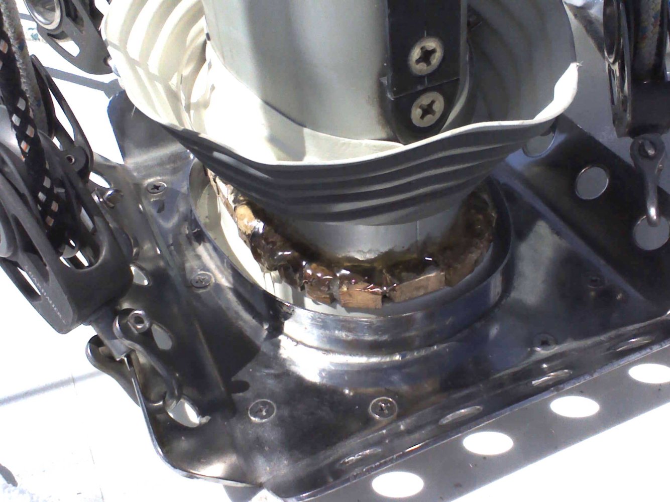

Something like these are already cut to perfect size.
Looking at the door stops in the link, they are not suitable. The part that holds the spar between the spar and the deck "hole" needs very closely spaced vertical pieces like hard rubber or wood. Our boat has a set of L shaped pieces of wood, each about 3/4" wide. The top of the "L" keeps the pieces from falling thru.
The steep wedge of the door stop would slowly work its way up and out.
Here is a link with our mast partner visible and the wood pieces, and the cover over it to shed rain.
I machined these out of some scrap pieces of teak, about 25 years ago. Most any medium or hard wood will do. No $ cost... just a little time.

The partners in @FastOlson's photo have cast in notches that are probably ¾" across. This design helps to keep the wedges in place and determines the number of wedges needed. Your partners may or may not have them. Wedges don't slip upwards, if they are too small they may slip down, but never up. Friction and the weight of the mast keep them down. The wedges should be very snug when they are installed.
The CR Marine wedges will probably work well.
