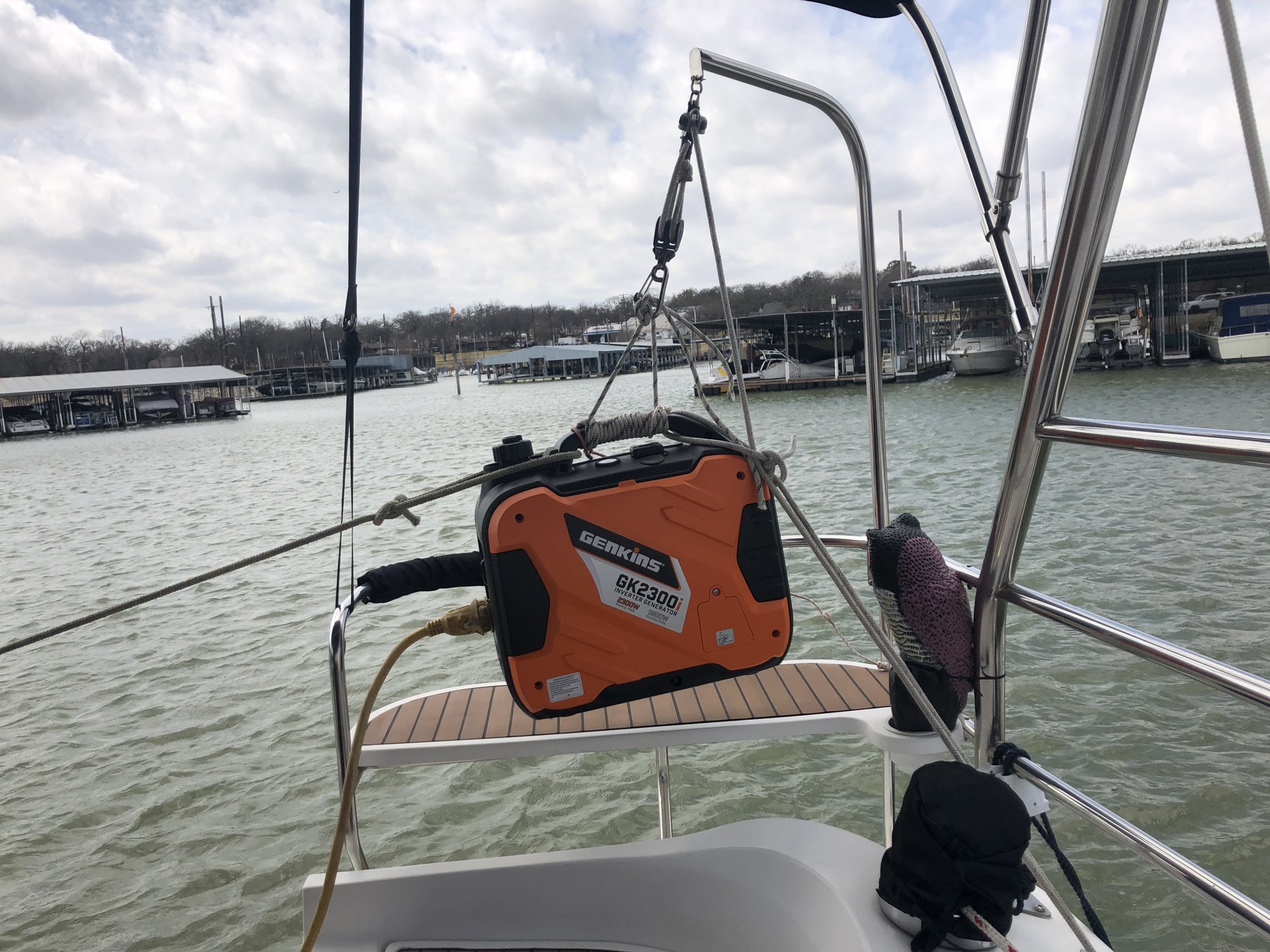

Very interesting approach to insulating the boat from portable generator vibration and noise - haven't seen that before. If you could post a photo there might be bonus points in it for you ;).
Also very interested in hearing about your experience with the WhisperGen 3500. That is exactly the generator I considered getting installed in my H36 in the port cockpit locker, where Hunter made room for a Panda install by dealers (a few folks that frequent these discussions have them on their 36-38 foot Hunters). Curious why you chose to install yours in the salon? The WhisperGen is supposed to be a more "advanced" generation of marine generators, and while certainly gaining no advantage in price over its competitors, it seemed to have some advantages in noise and efficiency. Having found virtually no one who had them installed or even tested independently I have only the manufacturer's literature to go on. I may reach out to you separately to discuss your experience.
Weather has been a bit on the cold side here, but today was warm enough to get a pic of the generator setup. Suspending the portable eliminates the vibration on the hull and reduces the sound in the cabin greatly. The A/C sound is louder than the generator in the cabin. The line put the generator under tension to dampen the swinging at anchor. Works well up to moderate swell.

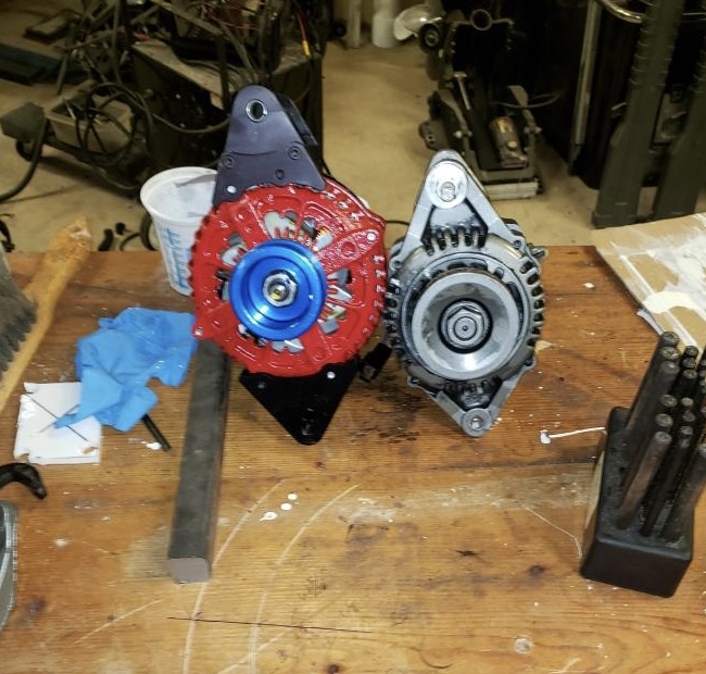

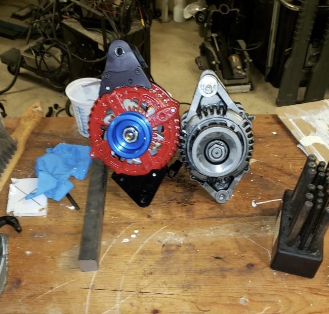

a major alternator upgrade would be less?
You might want to see what your existing generator is capable of with an external controller if it doesn't already have one.
I went from pissing along with a 10-12A input to:
On bulk charge. Same original Hitachi 52A alternator. Batteries were now always fully charged when we motored from anchorage to anchorage.
Likes: tfox2069
Jul 2, 2013
5
Hunter 36 Niceville
Actually…very interesting thought here. I priced a small genset install and with labor it was $15-$20k. On my 36’ boat I’d still be concerned about the noise and vibration, and I want to sleep through the a/c, not lay awake nice and cool. I wonder whether A proper LifePo4 install and a major alternator upgrade would be less? And silent when in use. Then I’d just need the one diesel motor on the boat. ;)
Same reasoning for me if you read my earlier posting
In the end the cost is probably close but intangible benefits make it a good option
No noise/vibration
Do not need to maintain another engine
No thru holes
I needed a bigger alternator for sure, and a capable inverter
Apr 8, 2011
774
Hunter 40 Deale, MD
