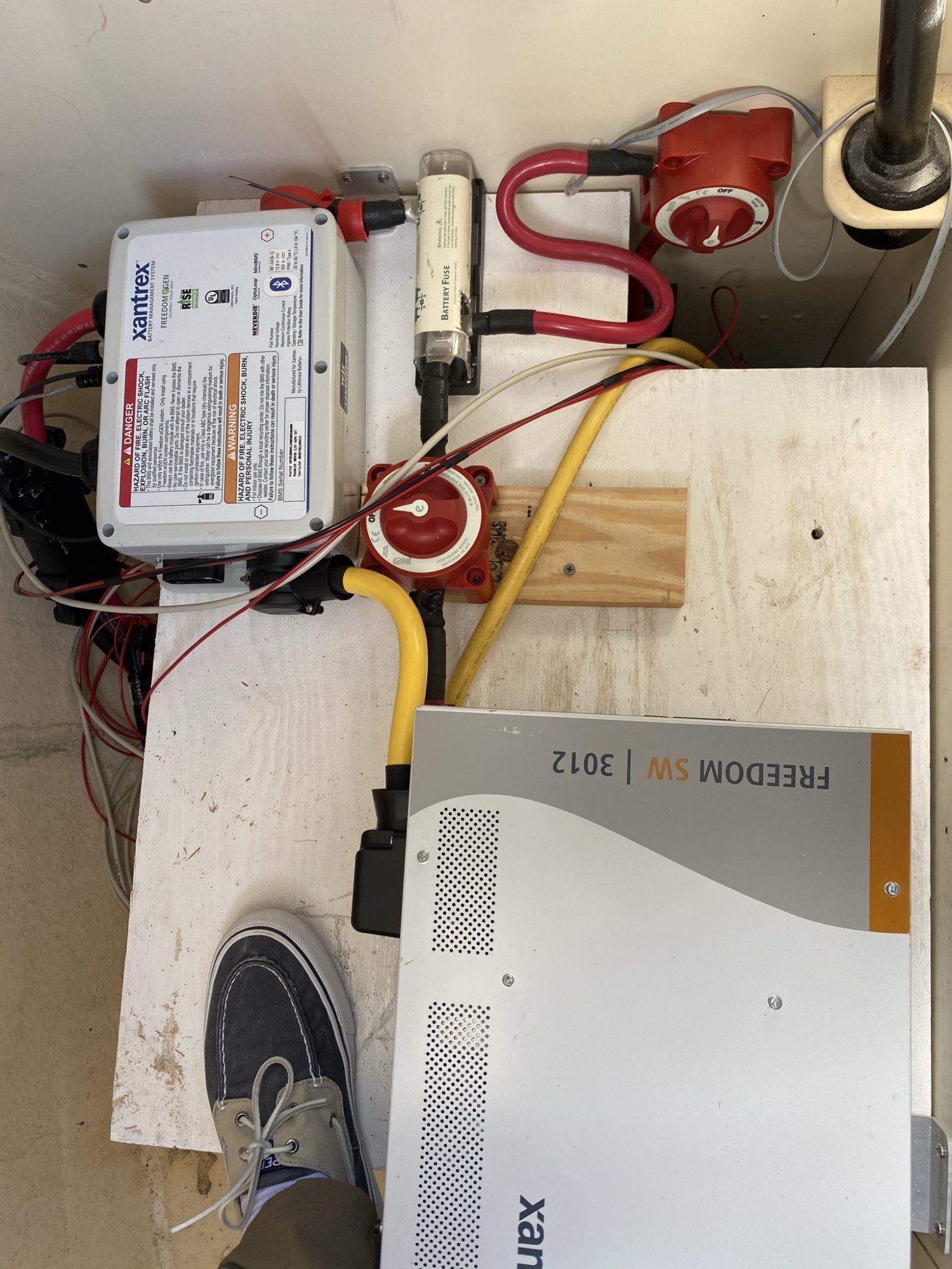

I am new to this forum, but i researched this topic a bit
Not exactly the same situation but my Hunter 36 has a 16 k BTU system and some nights here in the Florida summers you just have to have AC while anchored
Installed a 600 Ah 12 V LiFePO4 battery
It fits nicely where my group D batteries were(2)
Had to upgrade the alternator to a larger unit that can charge faster than the original, Balmar XT
With that , the AC runs 4-6 hours which is plenty
If Li battery is under 20% it shuts off automatically and so does the AC
With 20% the engine starts in the AM no problem and it does have no impact on the life of a Li battery, much different from other batteries
System so far has been tested one season
I would not have gasoline on my boat
Noise from a generator is too much
Do not need more thru hulls
Do not need to maintain 2 engines
Worked as expected on my boat, used space in lazarette intended for a gen

That’s impressive that you can run the 16k a/c unit for 4-6 hours. Assume you do that thru a big inverter? Curious to know. I’ve seen folks run a smaller (4k) unit just for the aft cabin off of 12v batteries, but still required a battery upgrade, as you did.
