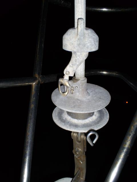

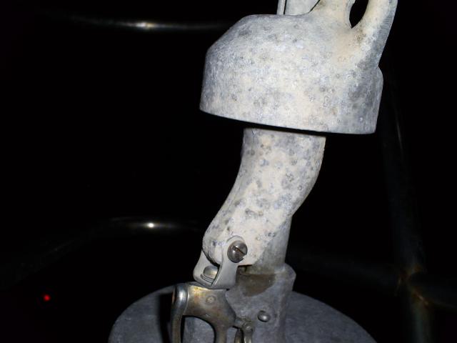

This is the part that should be able to spin. But I am not sure that it does.
This slides up and down the foil.
EDIT: I bet that thing does spin but it it seized up inside!

Yes that thing should spin freely
Scott,
That unit absolutely needs to spin freely or do not try to roll up your sail. Just hoist the sale in the luff groove each time until you can get a solution that works. Climbing a mast at sea to fix a jammed halyard is not a lot of fun unless you like being the weight on a pendulum 40 feet in the air.

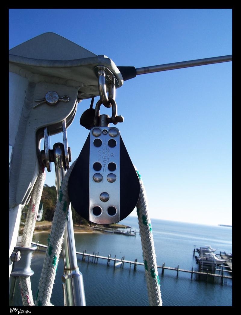

Please see the masthead photo on this link: http://stiletto.wildjibe.com/portfolio/Port_2009/photo_8.jpg. As stock installation for this boat.

I really don't know what I am looking at. IS that the mast head? What is that almost horizontal bar at the top right of the photo?
Is that pulley we are looking at there a halyard for a chute?
OK the halyard restrainer is just to keep the halyard at the right angle so it won't easily be spun up on the furler?
I thought the restrainer was a piece of metal that grabbed the top portion of the slide that goes up the furler.

Yes, the masthead.
The horizontal bar supports wind instruments.
Yes, the pulley is for the chute.
Yes, the restrainer is nothing more than a guide that increases the angle between the jib halyard and the furler.

Bill-do you know what kind of furler I have that's in the pic in the post on the second page (this page) at the top?
May 2, 2008
254
S2 9.2C 1980 St. Leonard (Chesapeake Bay), MD
It looks almost identical to mine - someone last summer identified it as a Streamstay furler (out of business but parts supported by RigRite). Mine was 'frozen' and I had to lubricate with spray (WD40) and 'work it' to loosen it up. There are bearings inside the top portion and it will swivel free from the 'shank' that comes down out of it.
