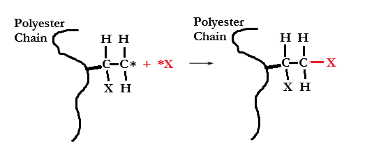

The polyester polymer chains have some danglers hanging off of the chain. The danglers have carbon-carbon double bonds (each dash in a bond = 2 electrons). The double bond region is electron rich. The hardener is benzoyl peroxide. Peroxides break easily forming a free radical (*). A free radical represents an unpaired electrons. Electrons hate to be unpaired. The Radical attacks the electron rich double bond forming a bond to carbon... and the "left-over" electron from the original bond moves to the end of the chain (see pic below) and the new free radical then goes on the hunt for a mate. It can pair with another free radical on a neighboring chain... or it can attack a double bond on a neighboring chain... or it can be "quenched" by another benxzoyl peroxide radical. The first two possible outcomes form a tether between two polyester chains. This is what is happening when bondo hardens.

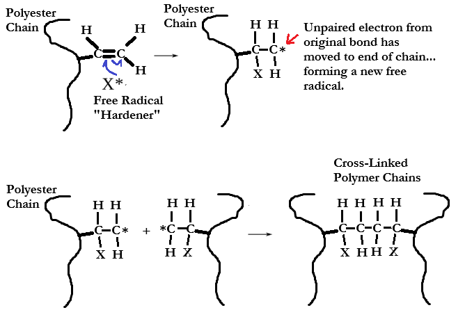

In the picture below, two terminal radicals on neighboring chains meet to form a bond. The blue curved arrows represent the "path" that the unpaired electrons (radicals) take. Ideally, this process occurs many thousands of time and in the end the resin becomes a single large molecule.
When you use too much hardener, you create an excess of Benzoyl Peroxide radicals (X*) and these will "sponge up" some of the radicals formed at the end of the danglers. This creates incomplete cross linking and weakens structural integrity of the final set.
13,609
Polyester resins cross link forming one supra-molecule.
