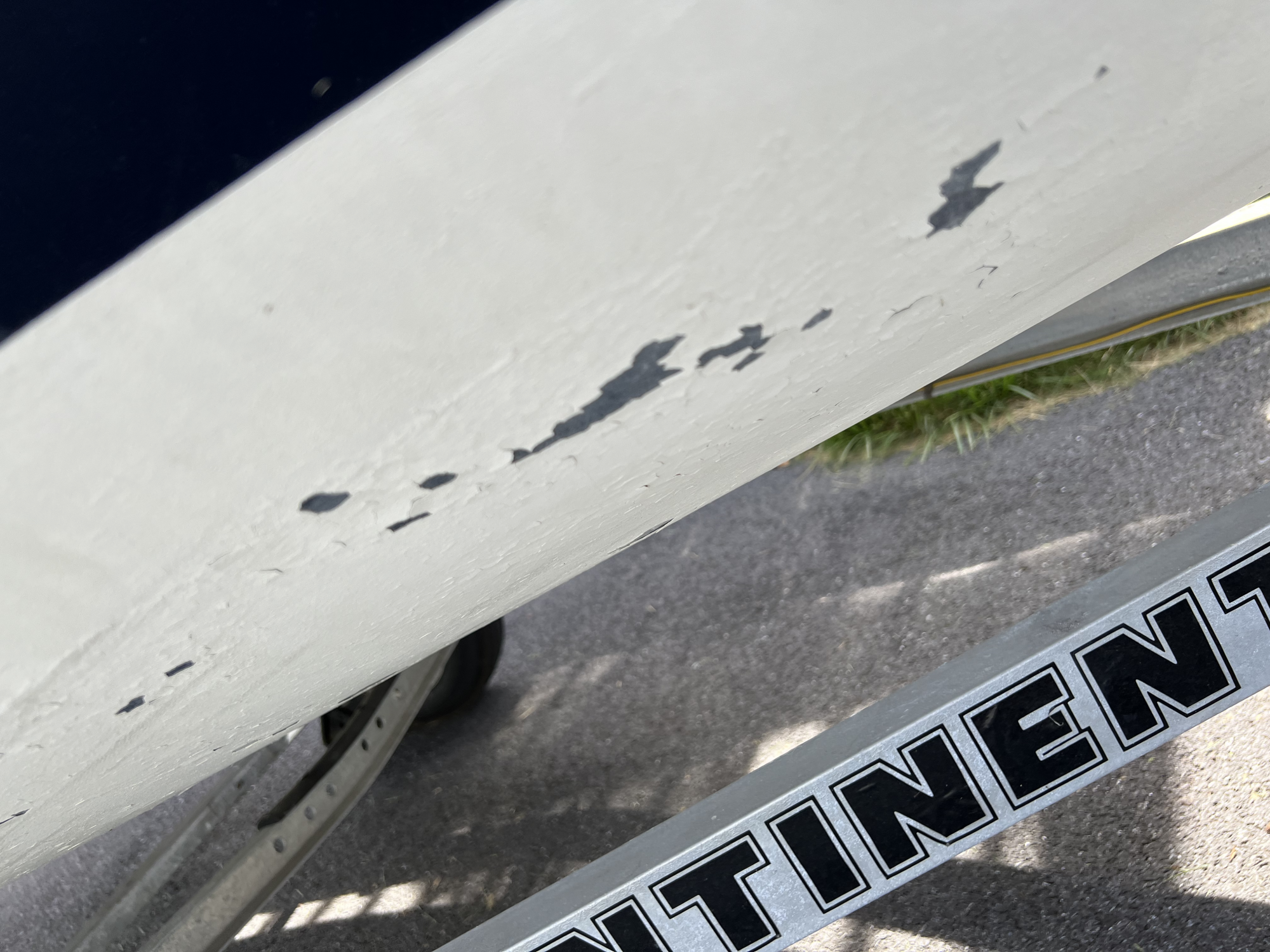

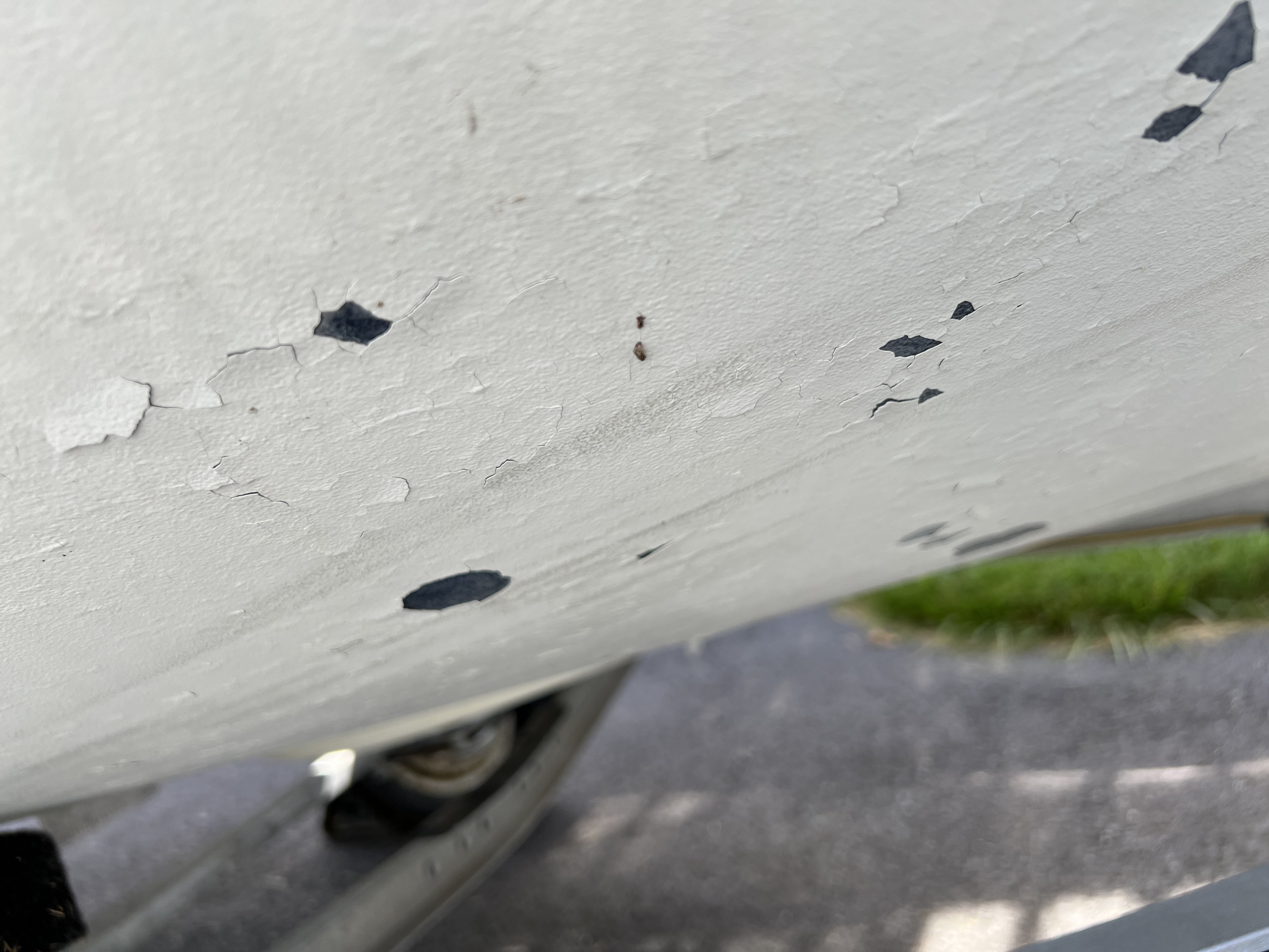

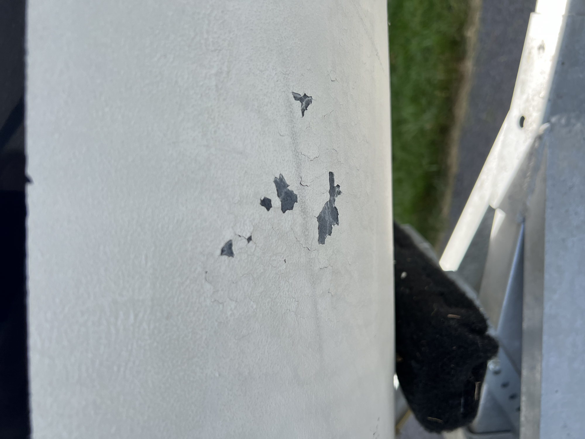

Hi - new to forum.
I have a MH15 (2018)- first and only owner. It sails in fresh water lake only. Last season it was in the water for several weeks continuously.
Now I have extensive peeling gelcoat areas. See a few representative photos attached.
What to do?
I thought boats were made to be in the water?
Thanks for any help

Ouch!!.............never seen gelcoat chip like that, sometimes it will crack. Is it that paint vs. gelcoat?

Looks like paint peeling to me too. I would be looking to a warrantee repair ASAP. I wouldn't do any DIY option until the warrantee situation is worked out.

Phone call would be my choice. Even if the warranty has expired, they should fix it... because that's some very shabby work. That's not gel coat btw. Looks like peeling house paint. Or paint that was applied with no primer.

With Dave’s comments, I think I would be sanding down the bottom, an applying a 2-part epoxy bottom paint (a few coats) and call it a day.
