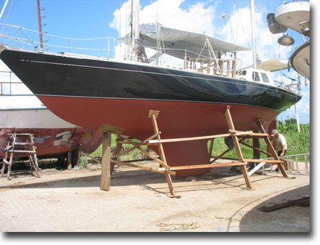

wile at dock it will have a/c, on the water I should be in the cockpit sailing I was going with a white or off white on top side and dark blue on sides with a red bottom. look up the Friendship 40 for color scheme. I live in New Orleans and my Macgregor was very hot in the summer and it was white. out on the water wasn't bad with the hatches open but on the trailer in the back yard you would sweat bullets. stuck a window A/C unit in the companion way once and nearly froze to death sleeping on it one night.
