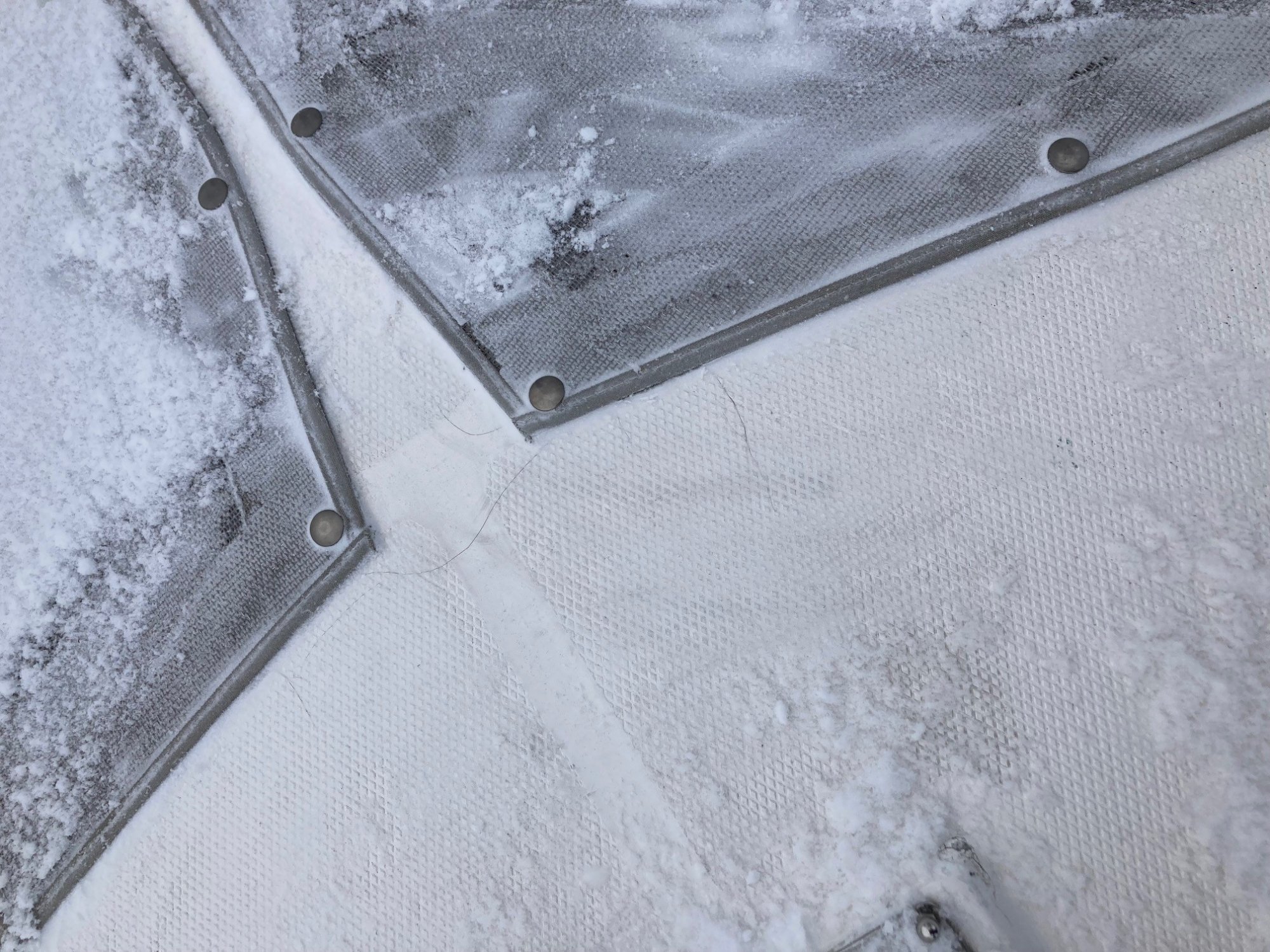

Hello,
I am interested in a Hunter 356, 2002. The boat will be surveyed in march but I would like your opinion on thin Gelcoat Cracks on the deck, between the two skylights. Is it only Gelcoat and cosmetic or could it be a structural or humidity problem on the deck? These are the only cracks I have noticed on this boat.

I think basically cosmetic. Unless you see that the windows are breaking out of their frames, or other signs of more structural issues. Gel coat cracks like those in the photo are common.

If you are really concerned and want to fill them, you can use Capt'n Tolley's Creepy Cure.

Are the sky lights near or over the cabin with the water leak?

You're going to want the surveyor to do a moisture check but most likely those are stress cracks in the gel-coat only and not a problem.
