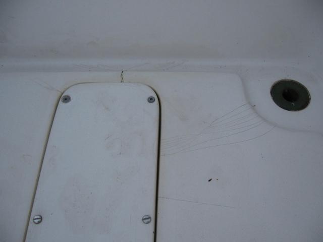

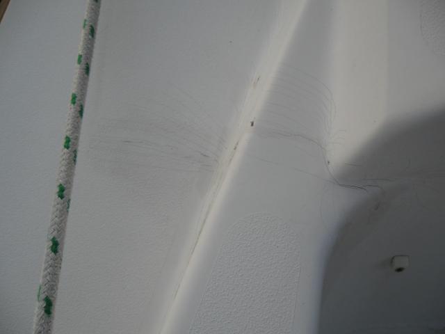

Sailor Dave, there is one other consideration and that is whether the cracks in the second photo have allowed water to enter the core beneath the cockpit floor. If that is the case, there could be considerable damage and it should be sounded for structural integrity by a professional. The first photo shows merely stress cracks that form when there is insufficient support at a juncture. Those shouldn't be a problem. Good luck and good sailing, Ron
280
Hunter 25_73-83 NORTH POINT MARINA/WINTHROP HA IL
What would be the recommended procedure for repairing cracks like those?
Firstly, you must determine that there is no damage to the core by sounding and/or drilling a test hole to check for water damage. If there is none, the cracks need to be ground out in a v-shape with a dremel, filled with thickened epoxy, sanded and faired and then either painted or gel coated to finish. West Systems has an excellent guide you can obtain that will show you step by step what to do. Good luck and good sailing, Ron

The cracks in the second photo look a bit like the kind that develop when the fiberglass is flexing. Is the cockpit sole soft around there? If you're getting the boat for 500 bucks then no big deal, if 2000 then you might want to check it out more thoroughly.

Sailor Dave, one final thought based upon many of the comments and suggestions. If you are new to boat ownership, you must decide how well you choose to maintain your boat. There are many ways to skin a cat based upon your personality, commitment to the boat and time you're willing to devote to it. I have always preferred the "fix it right the first time" approach which always entails more time/labor but if done properly the issue should not have to be addressed again. Captain Trolley's is a good bandaid that will prevent egress of water until you have the time to fix it correctly. I do not believe it is an any way a proper solution or permanent fix to gelcoat cracks. Good luck and good sailing, ?Ron

Had those cracks professionally investigated. He said "they look worse in the pictures" and there is no damage below. Like some of you, he too recommended having them properly filled. That would also improve the overall appearance. Thanks all!!
