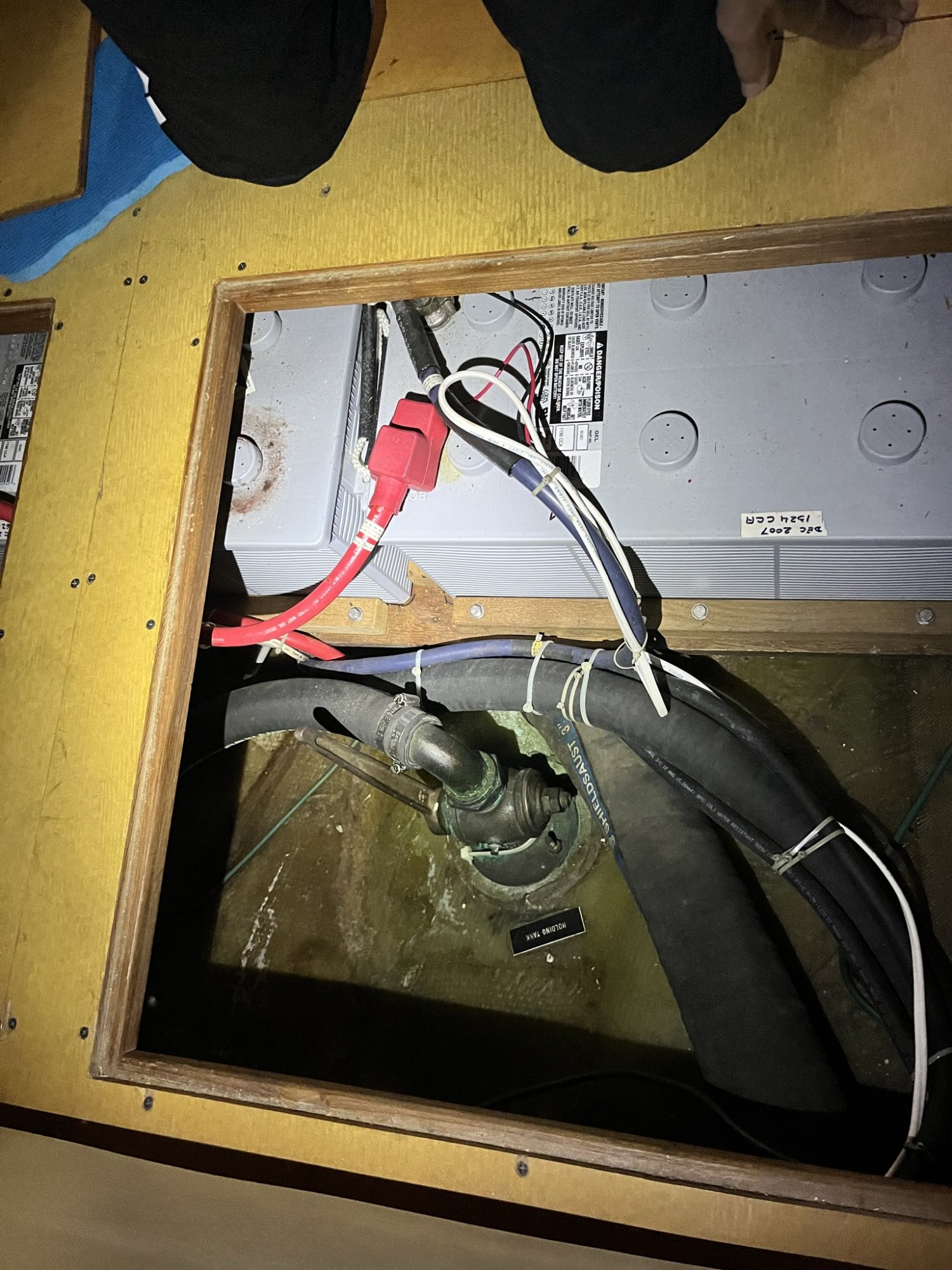

Hi all,
I just replaced my gel batteries in bank two, installed in 2007. I‘d say they were due but one had some life left because it was the last in line. Nice having all new.
That’s the old battery.

It looks like the boat was built around the batteries. How did you get them out?
There were some wood blocks we could unscrew and jiggle them out. I say we because I hired Treasure Coast Marine to get the batteries and install them.
