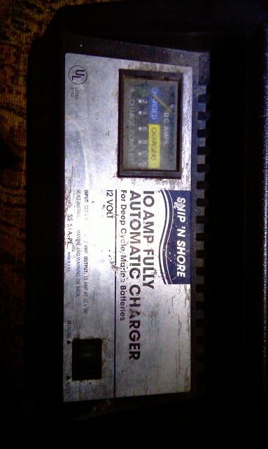

I have recently picked up couple of 12 v gel batteries. I am not sure if I can replace my old wornout starter cranking batteries with the gel batteries. I am affraid to burn and over charge my gel baterries with the alternator(picture atttached). Also, while they are out, can I charge them with this portable charger( http://picasaweb.google.com/yuriytymo/GelBatteries#5540245588940470818)?

I do not believe that using a "car charger" is recommended or wise. You should be charging them with a multi-stage smart charger that is designed for Gel Cell batteries. If you had purchased AGM batteries, you can use these chargers, but they would probably not give you the full benefit of the AGM technology either.

I am in the process of changing batteries on my 1984 Cat 30. After many questions, reading and asking, I have decided to stay with the wet cell design battery. Much of the battery choice comes from the type of sailing you do and the use you apply to the battery. The charging requirments are different between each battery type and do require different charging sullpies and controls. This is one reason I choose to stay with wet cells. The cost was not necessarly a fact but there is a hugh difference. The charger you show was probably designed for wet cell batteries and may not charge a gel cell to its' full capicity. It would have a selector swith or specify gel cell charger. It won't fry the battery, it just won't charge it completely. Not sure of the alternator, but I didn't want to go there with mine. Hope this helped and good luck.

Using a car charger on gels can ruin them. That alternator regulator is likely factory set to 14.4V so it too would not be a suitable charger for gel batteries if you want to get your money's worth.
