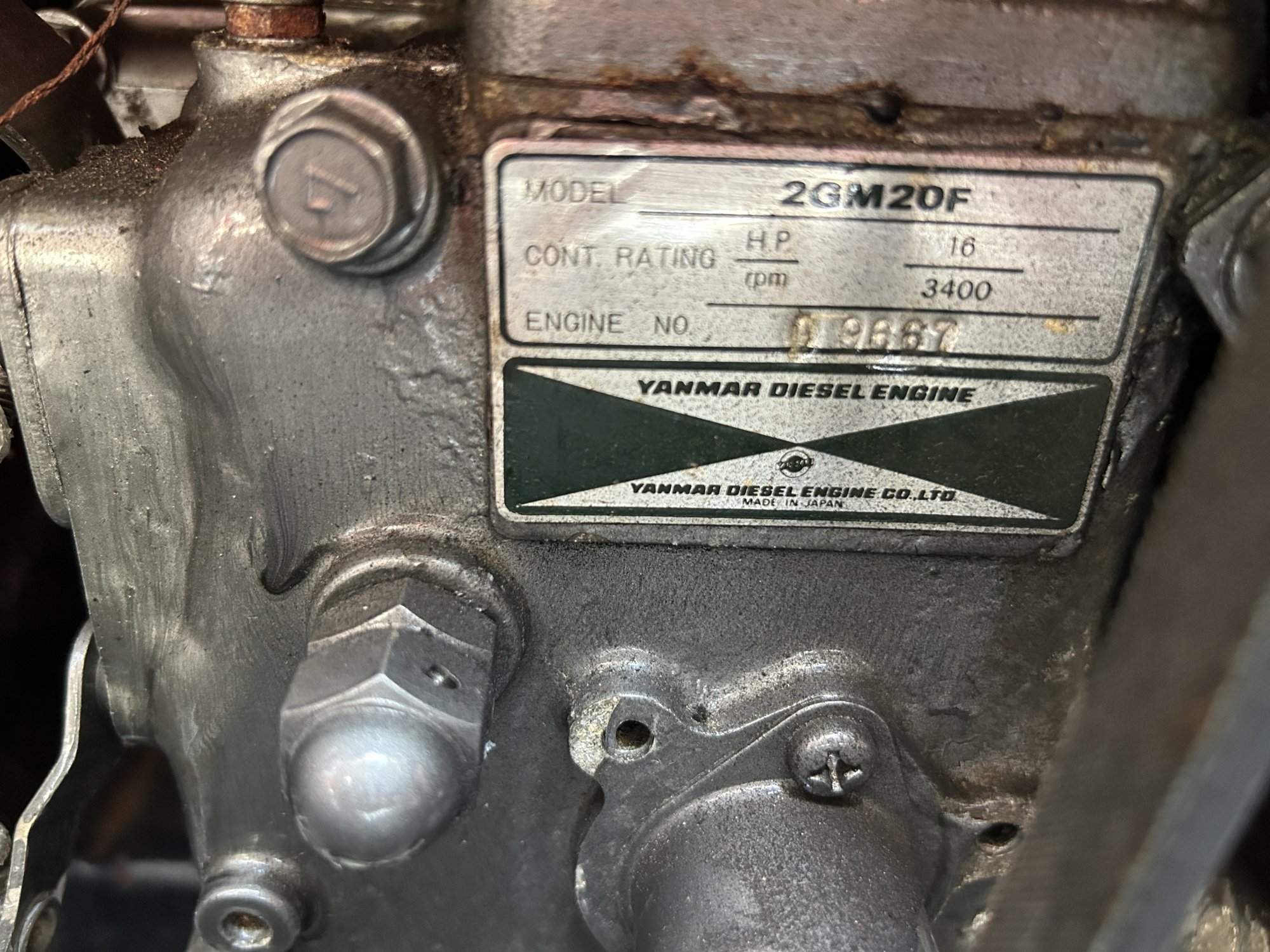

So, my 10,250 (5 ton) O’Day 322 could use a 20 HP engine. My boat came with an 18 HP MAX, 16 HP Continuous rated Yanmar 2GM20F…so a little under powered I guess. I am fortunate to sail Lake Michigan, so no tidal current to worry about. But I wouldn’t really want anything smaller.
Greg
