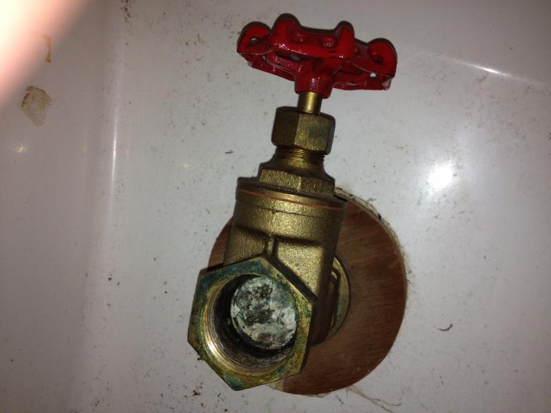

I'm in the process of replacing my gate valves and thru-hulls. The gate valves looked good on the outside but the first removed showed that the valve had rotted through.
The thru hull is bottomed out with the seacock so I need to cut the thru hull down to size.
What is the best way to cut that thru hull to size evenly and without ruining the threads?

Tom before you cut that gate valve out I would suggest you remove the bonnet and gate. When you do that you should be able to see the threads on the water side of the valve. Apply some penetrating oil (WD-40) to the threads and let it soak for awhile then try to turn the valve body off. Repeat the process a few times.
If Option 1 above does not work the next would be to cut the valve body in two being careful not to hit the threads. You can use a dremel tool or the like to do that.
IMHO the last resort would be to cut the thru hull out.
Good luck

I have the thru-hull out and have a new one ready to go in. I did have to cut the thru hull out after two hours of trying everything else. Took 2 minutes to cut it out with an angle grinder.
The thru hull needs to be shortened so it will not bottom out in the seacock.
