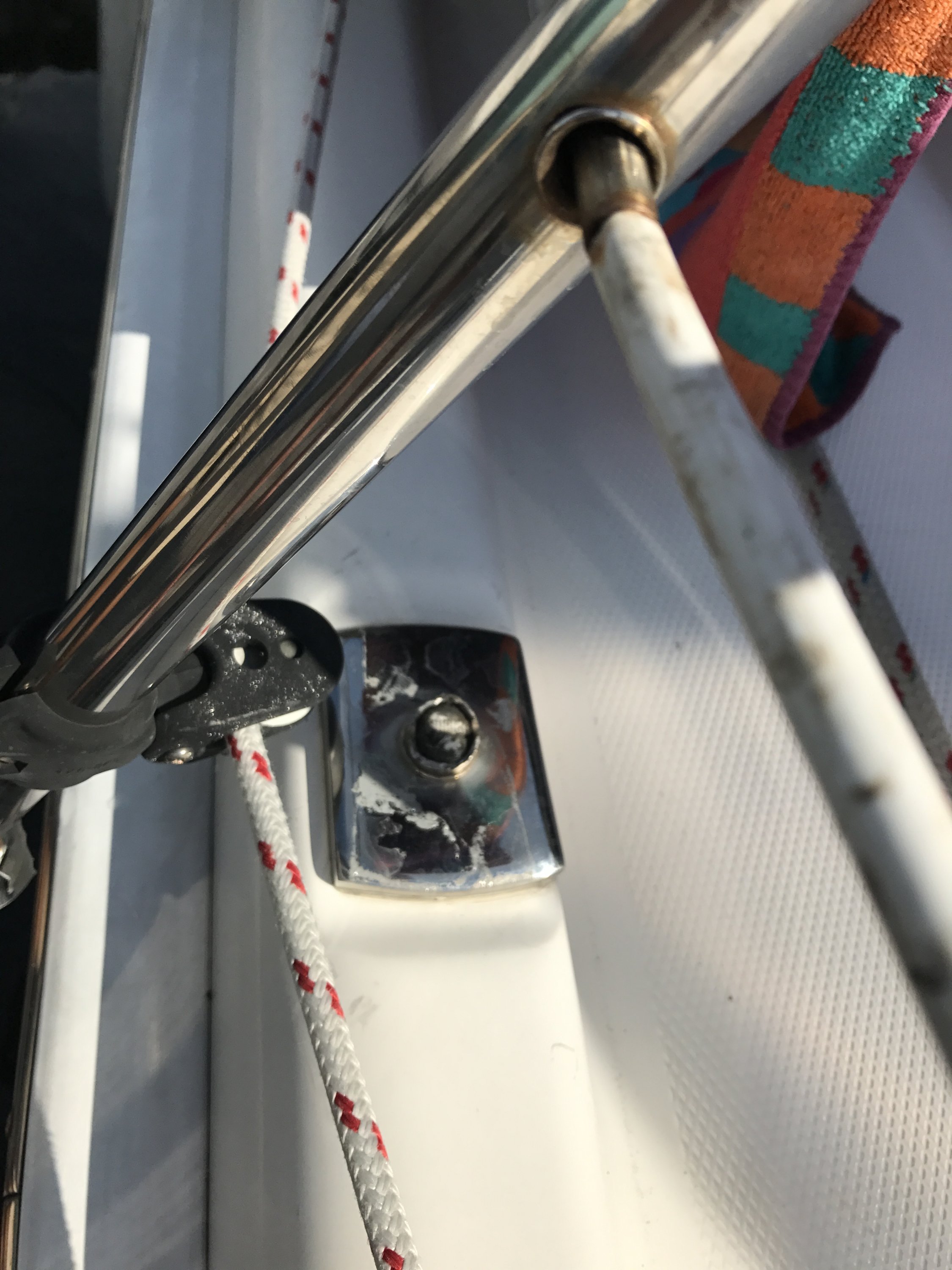

I have a starboard gate stanchion on a 2006 Hunter 38 which broke off at the base plate. How do you go about getting to the base plate to replace it? I have the replacement parts, but cannot seem to find a way to get to the interior to remove the damaged baseplate.
24,759
CB That is a bummer. No experience with hunter stanchions but as I have read Hunter uses an in fiberglass metal plate to attach hardware. The items I have seen all have screws that go from the top into the plate. This does not look to be your case in your photo.
I would start looking for a through bolt or bolts underneath the deck in the area of the stanchion. This my require some headliner removal to see the area beneath the deck where the bolts may be lurking.
My experience with stainless stanchions is that the base can be welded back on to the post. Usually, due to the weld, a stronger connection than the original design. You might examine this as it may save you a few bucks in new metal. Stainless can be polished after the welding and look bright and shiny new.
These things never fail at the end of the sailing season.

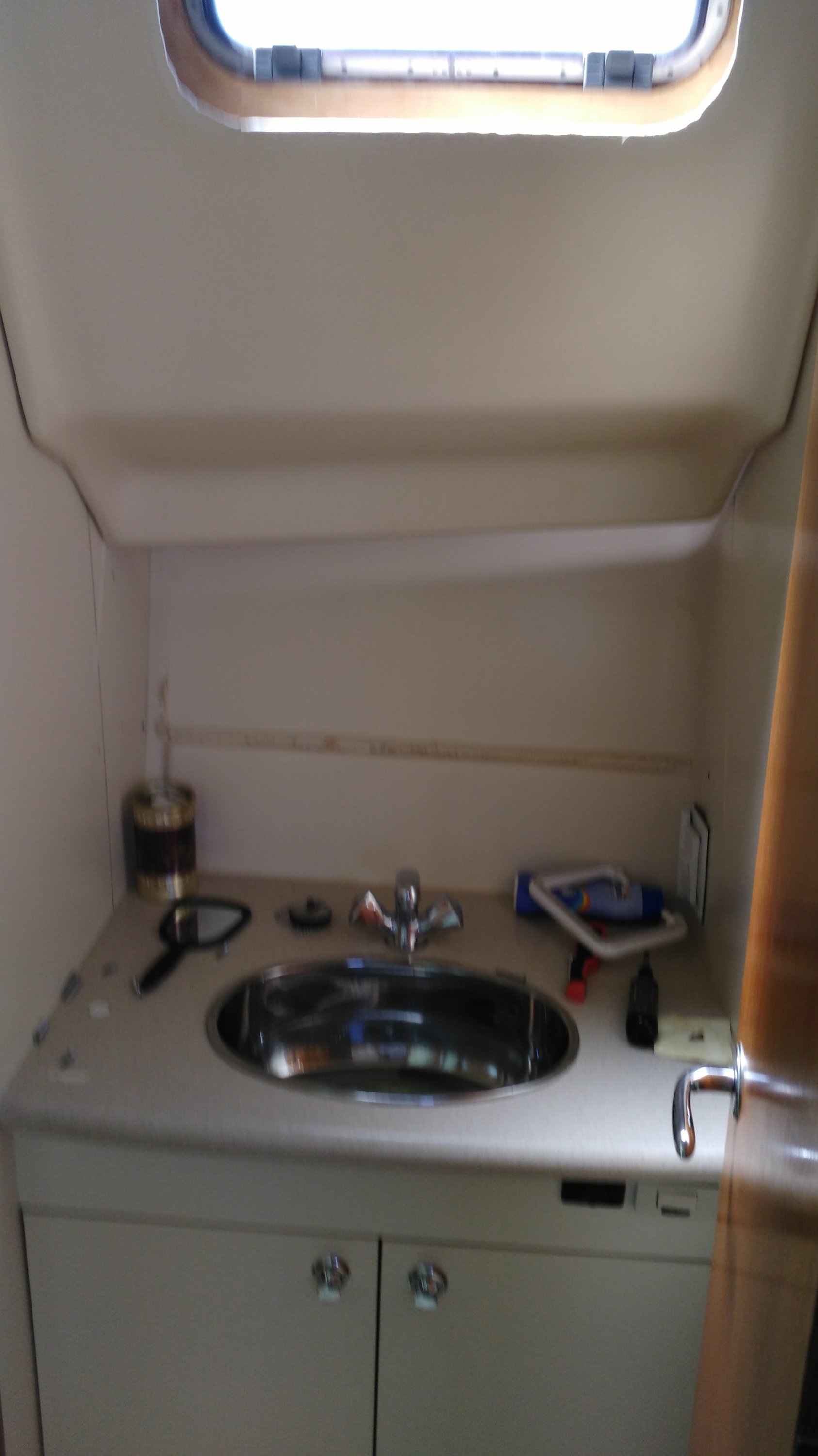

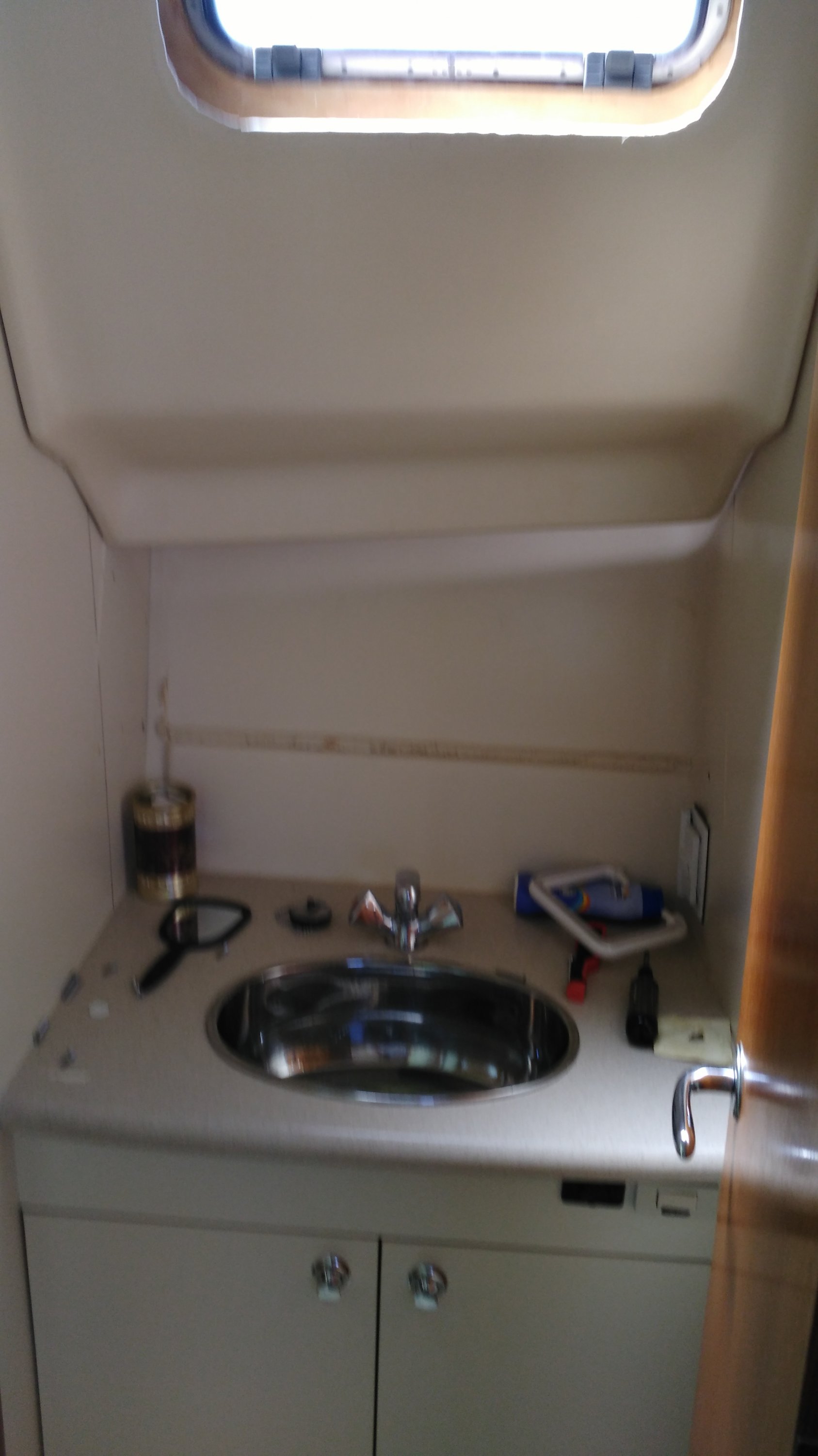

I just did the one near the head (bathroom), was a PITA, but i have two other more to do (near front cabin and midle near sink) i really down know how to get to them!!

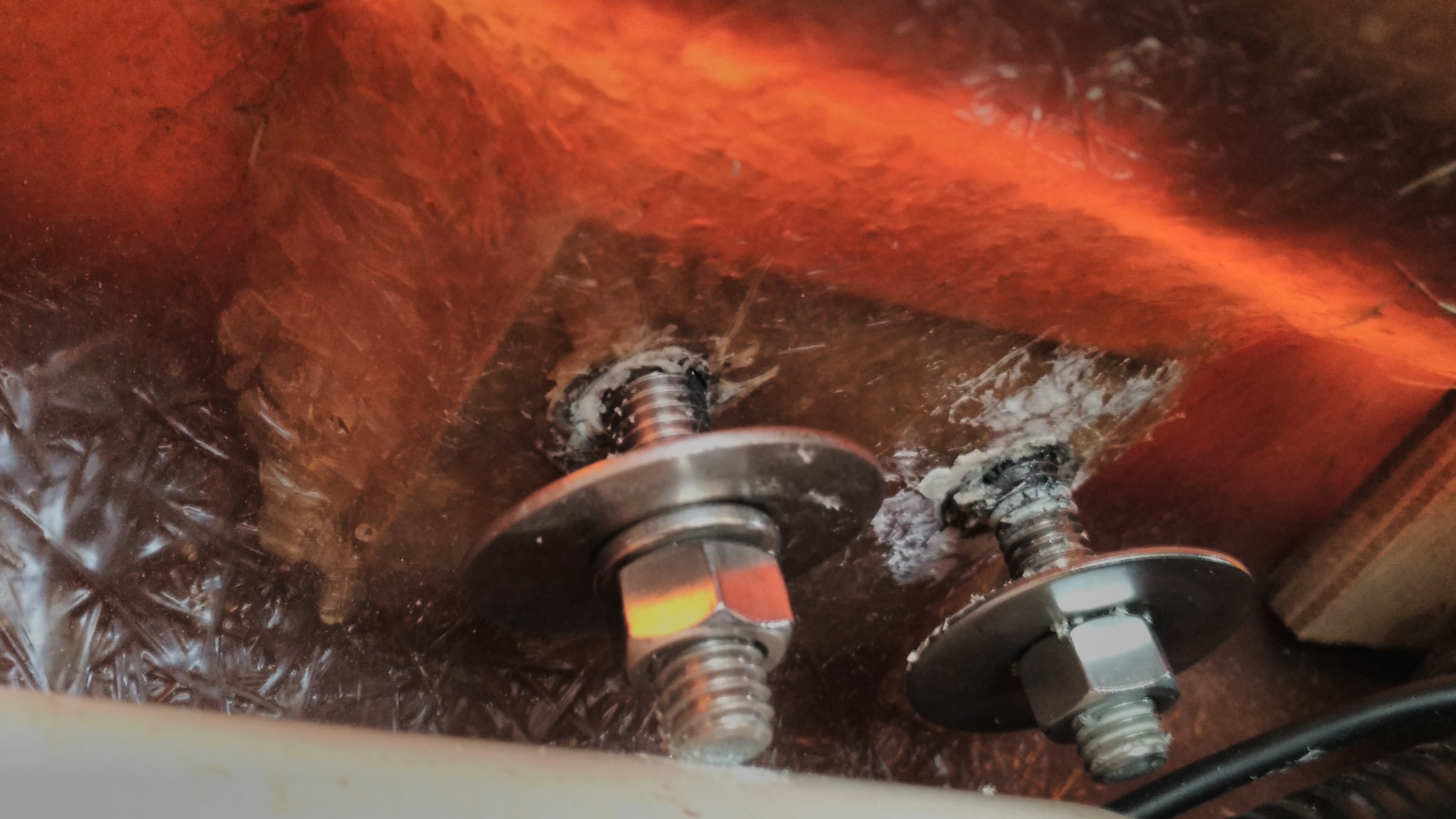

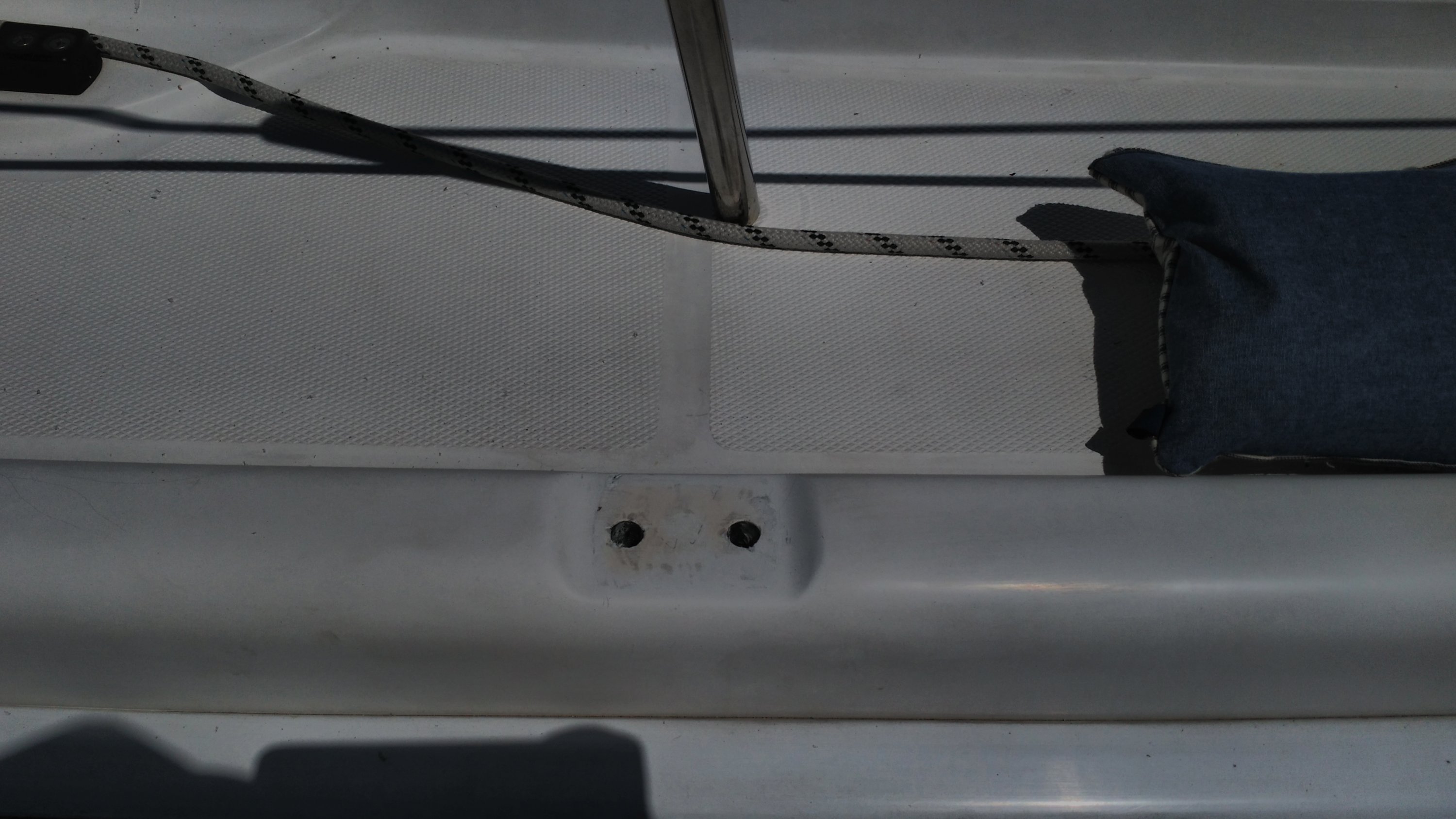

I can see how to get to the one over the head sink. Mine is on the starboard side and is the forward gate stanchion which is connected as per your photo with two bolts. I cannot for the life of me figure out how to get to the bolts.

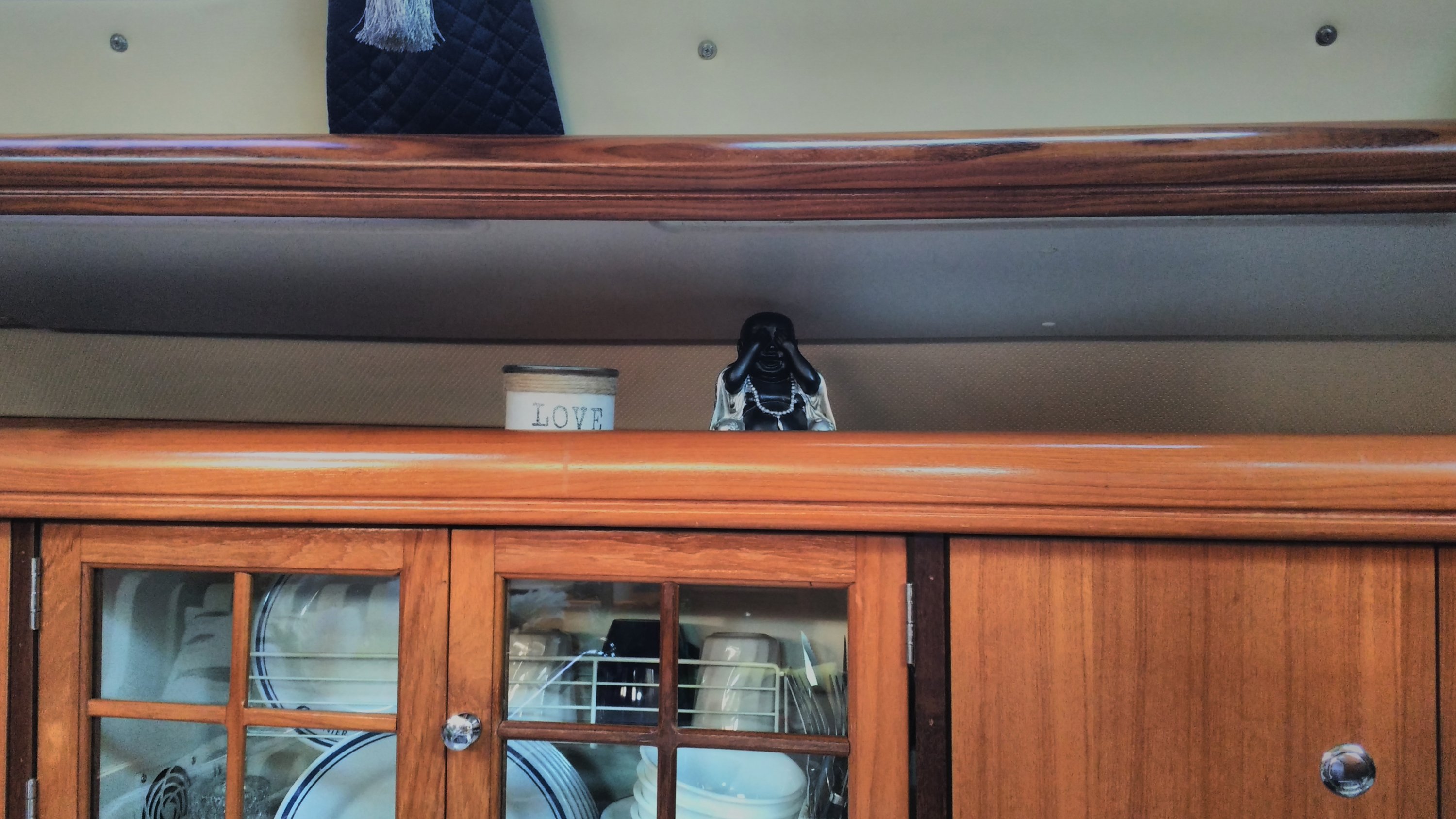

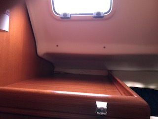

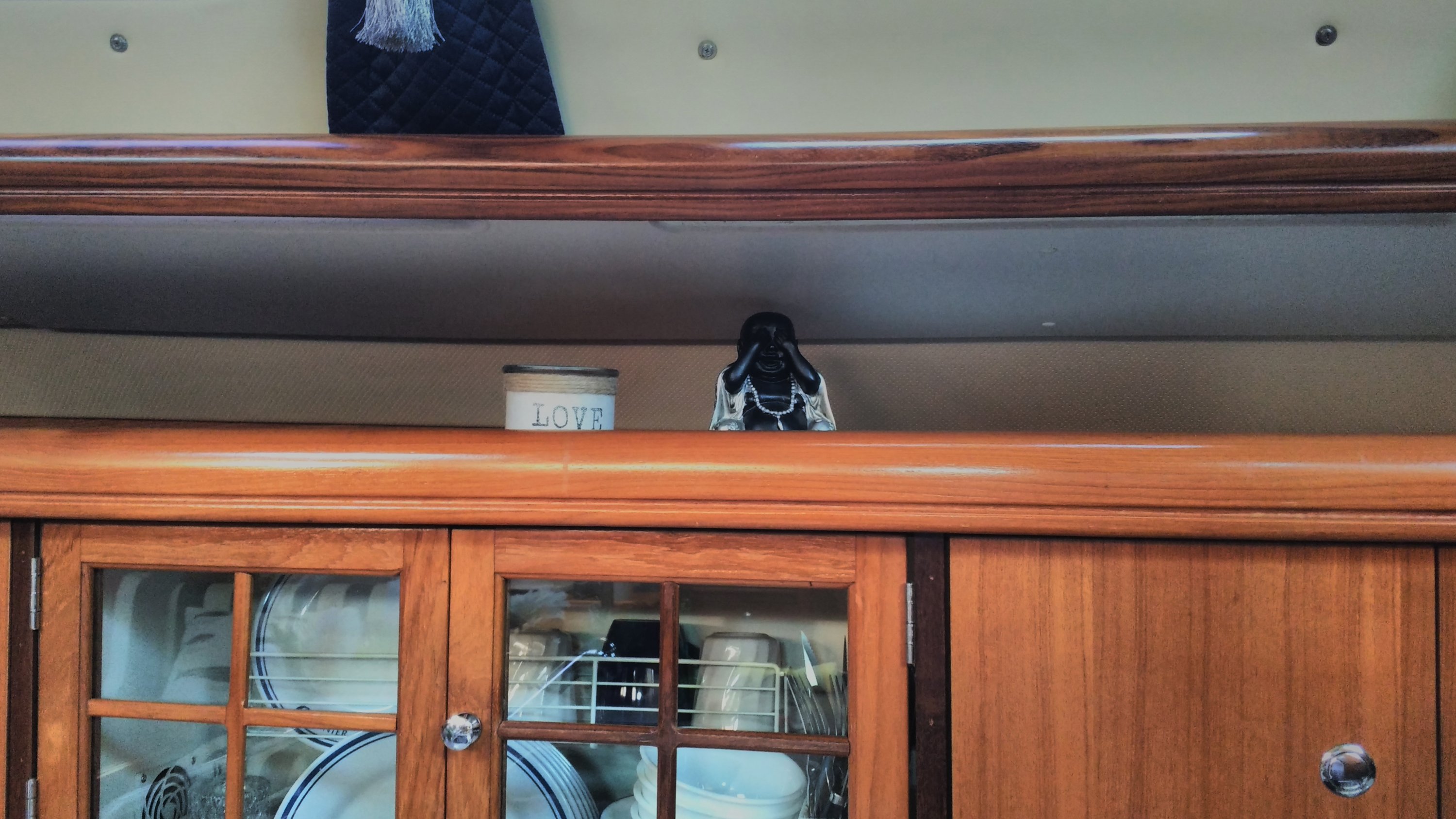

Is this the front bedroom starboard side? Looks like rear bedroom from out boat..
Ill need to get a look next time i go back, hard to say from this picture.
I found the way to fix the other ones, but i'll try to get back to you for this one!

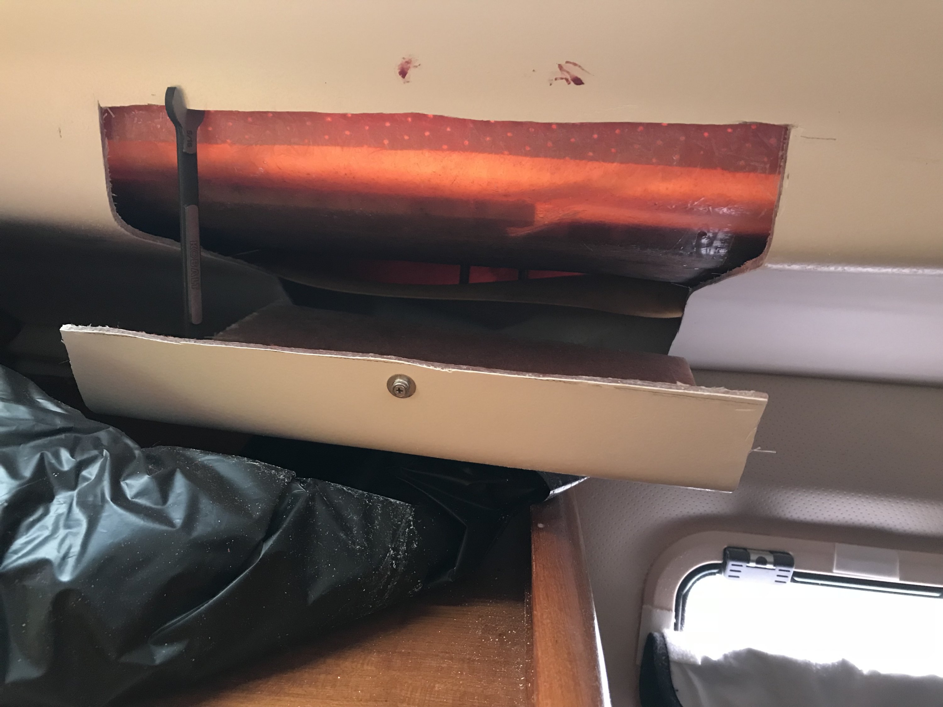

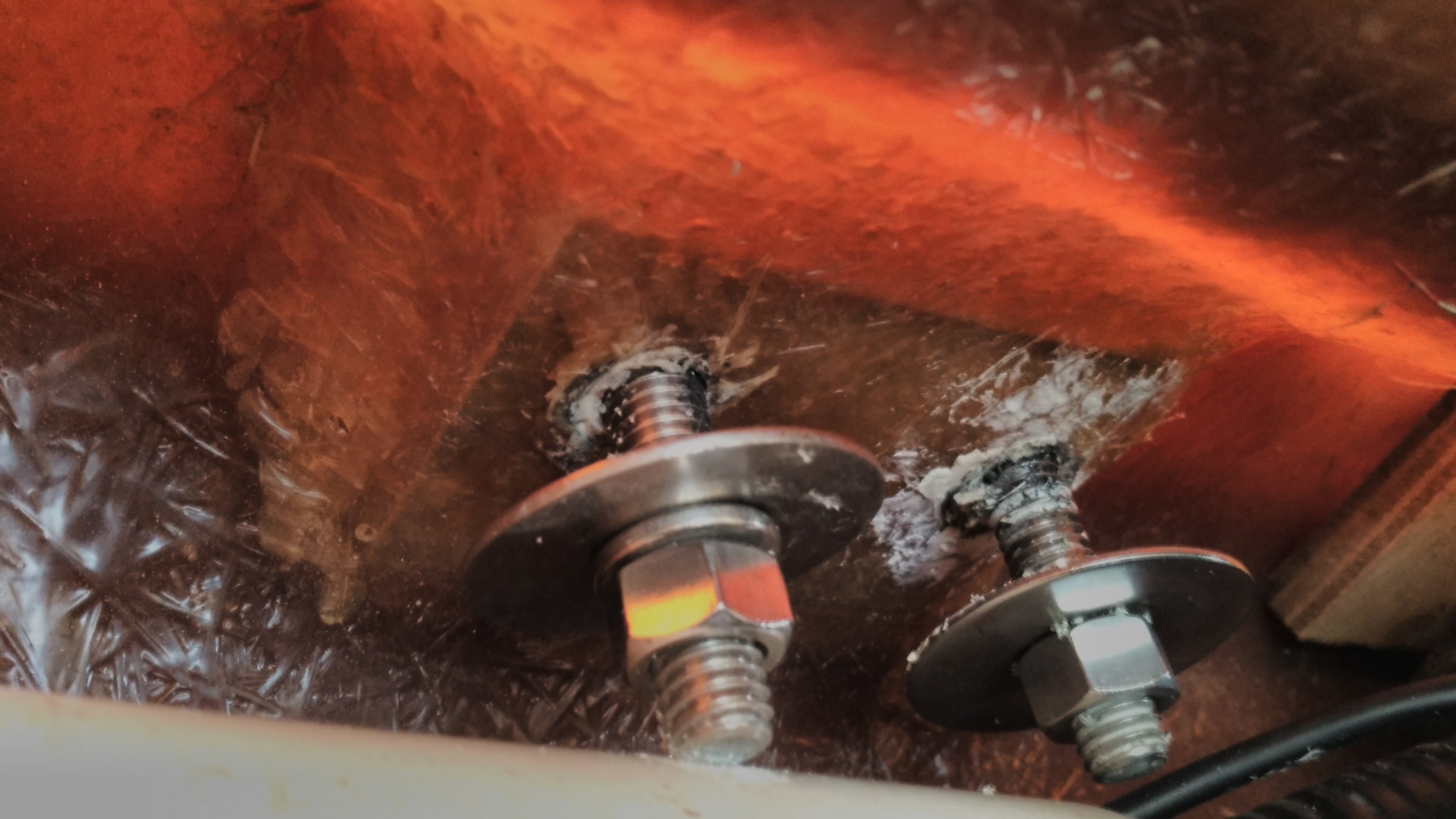

Just to close this out, I had to cut into the headliner of the back berth to get to the bolts holding the gate stanchion in. This was a delicate job due to the proximity of the outside fiberglass -- the clearance in places is less than an inch. Once this was done, the remainder of the job was a snap.
