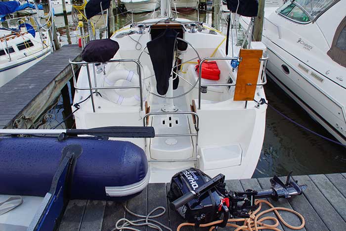

I have a gas can in a swim platform locker that I want to transfer fuel from, up to an outboard on the stern rail without hauling it up there. A simple manual pump I guess but which one?
