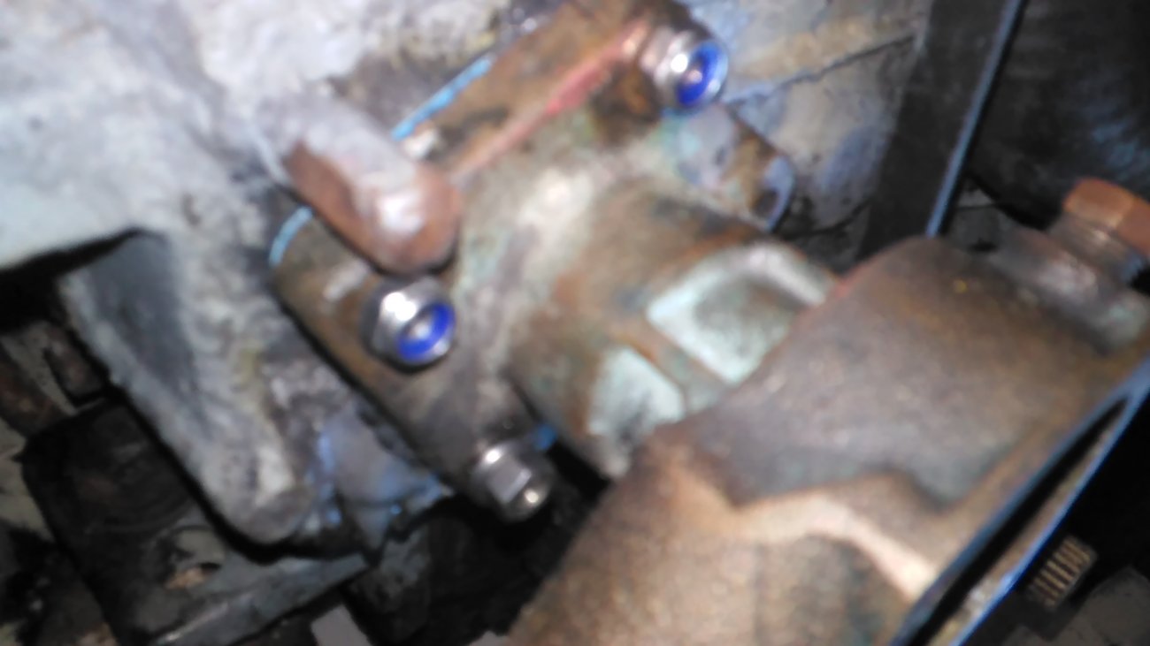

Do you have studs sticking out from the engine? My ObeRdorfer is mounted with four studs. The gasket is provided by the engine "side" not from the pump manufacturers. For my M25 I get them from a Kubota tractor dealer for pennies on the $ compared to Universal prices, but you get them from the engine dealer.
The goop is Permatex Ultra Black and I still used a gasket on the pump side.

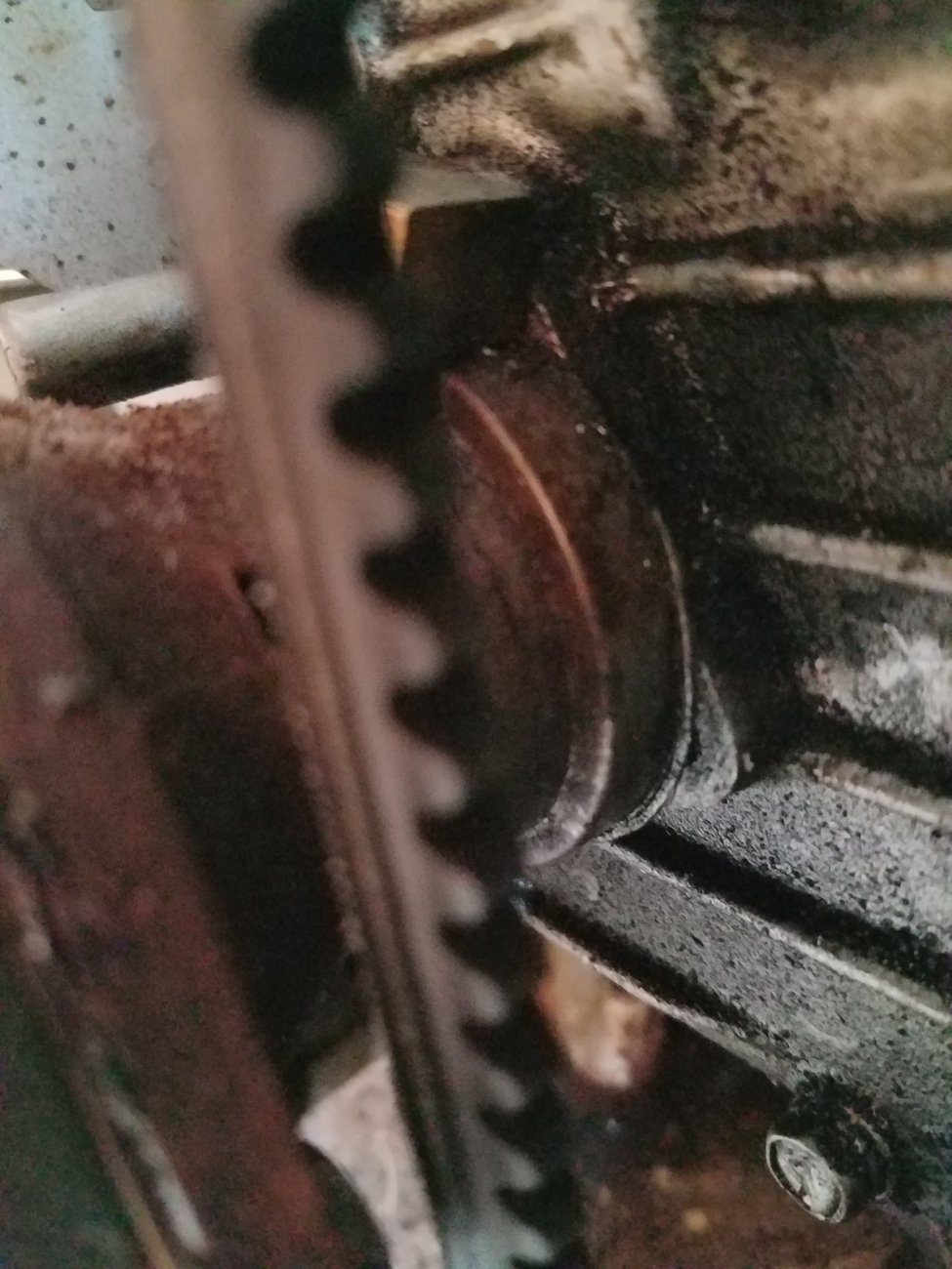

I do have a photo of the Sherwood from the front of the engine looking left. It shows the side of the pump and the mounting ring against the block.

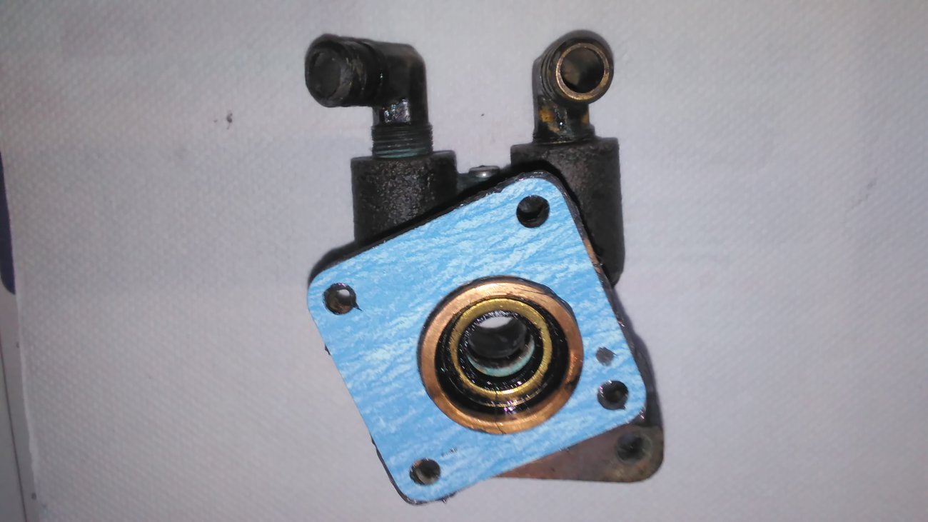

Here's a Kubota tractor gasket on my Oberdorfer:

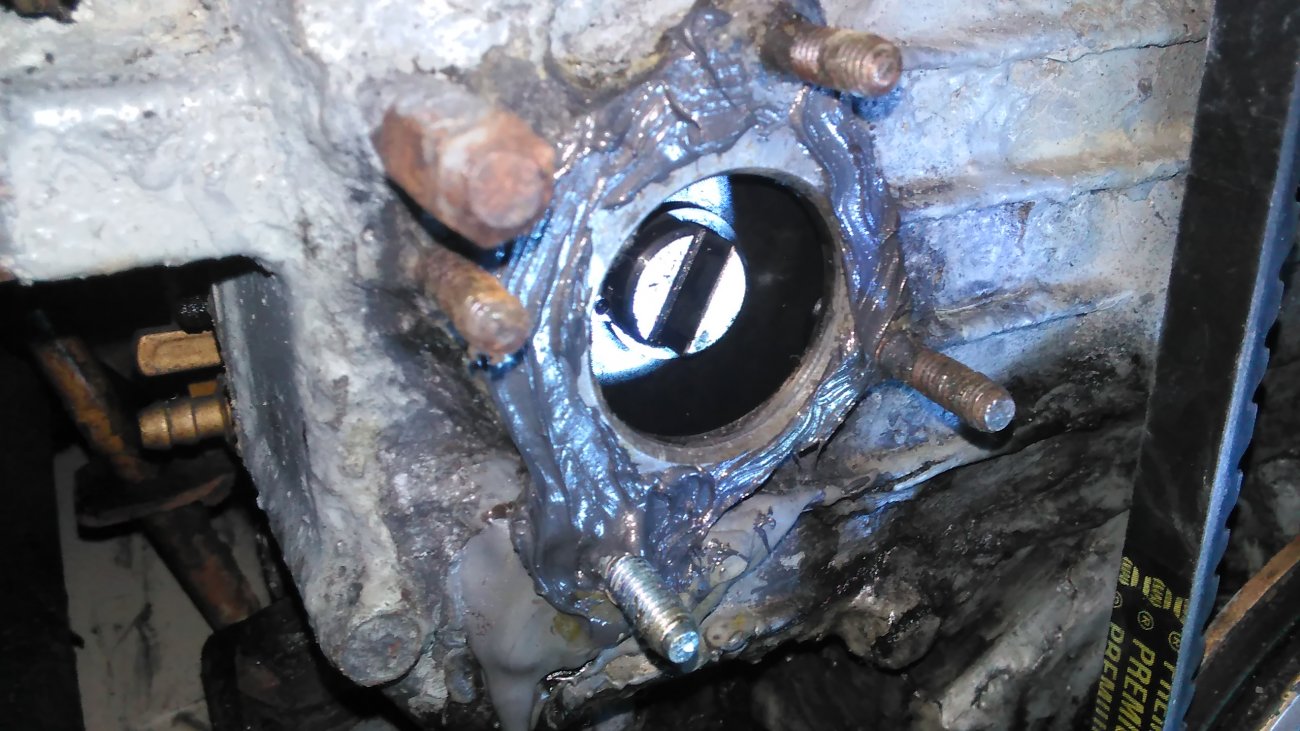

And here's the pump mounted:
