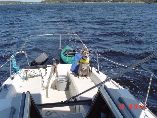

If there is a fuel compartment in the cockpit that doesn't have access to the bilge, it OK and safe to store it with the vent open. Methanol in the gasoline has a tendency to attract water and break down any lubricant that is vital to the life of a 2-stroke outboard engine. It's a good idea to shake the fuel tank about once a day before starting the outboard. I have an outboard bracket on my O'Day 222, which is similar to your O'Day 22, and I have it set up so that all I need to do is use the engine tilt to get lift the lower unit out of the water. I never have a need to lift the bracket on the stern. Perhaps you may be able to do the same thing by experimenting different positions of both the bracket and the motor. The fuel compartment on my boat is on the Starboard side under the autopilot in the picture.
