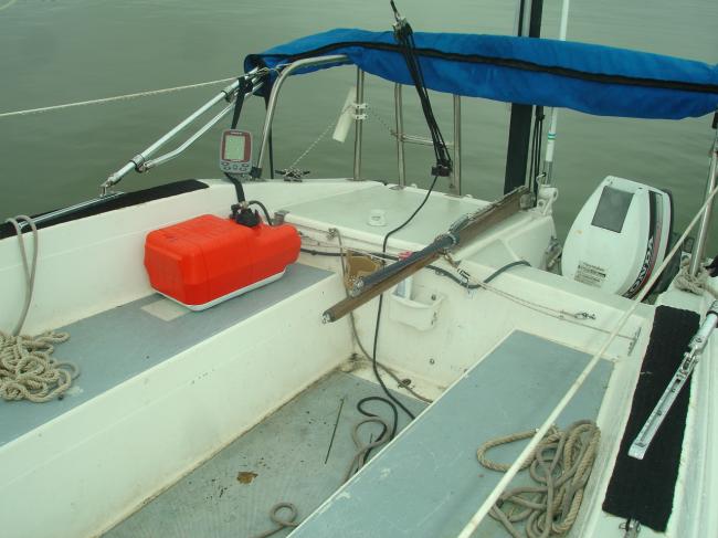

Ive never really found a good place to keep the gas tank on a 26C but have made somewhat of a compromise that seems OK. I put the tank on the seat across from where you sit if your motoring. I used a smaller plastic 3 gallon tank and made a cradle for the tank out of polyester resin and glass matt using the tank as a mold. The cradle is glued to the seat and has drain holes. This seat location seemed to never get used as you have to sit more forward to run the tiller and if the motor is running, someone sitting here would be in the way of the tiller. I plan to keep a separate identical tank (or two) in the lazerette. I "believe" (but am not sure) that if the spare tank in the lazerette has the vent closed, that it should overall be cautiously safe. I had the tank sitting on the floor in the rear of the cockpit but it gets in the way of your feet and also blocks the drain and my lazerette is already full of junk like anchors, ropes, fenders, ect.

My motor is on a fixed bracket, which gives enough room in the outboard well to fit a 3 gallon tank. Of course, that means that I have to stretch waaaay back to shift gears or steer. I guess you just have to pick your poison.
