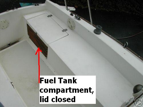

Fuel tank spot.JPG fuel tank_1.jpg fuel tank_2.jpg If you were to put the portable tank in that cockpit seat locker that is open to the whole interior of the boat.... ad any fire ignited, I would expect that your insurance would refuse payment on your claim due to your failure to comply with USCG (and common sense) regulations that portable tanks NOT be stowed below deck. They MUST be in a ventilated, or totally open to the outside compartment, separate from the interior of the boat.
The boats with permanent tanks, like most inboards, the tanks themselves are required to be vented directly overboard and filled through a deck fill, designed so that any spills will be directed overboard.
If an USCGAUX or US Power Squadron Vessel Examiner were checking your boat for a VSC (Vessel Safety Check) you would not receive a passing Decal with the portable tank stowed below decks, worse if you were boarded by the USCG or other law enforcement, they would likely cite you for an "unsafe" fuel system.

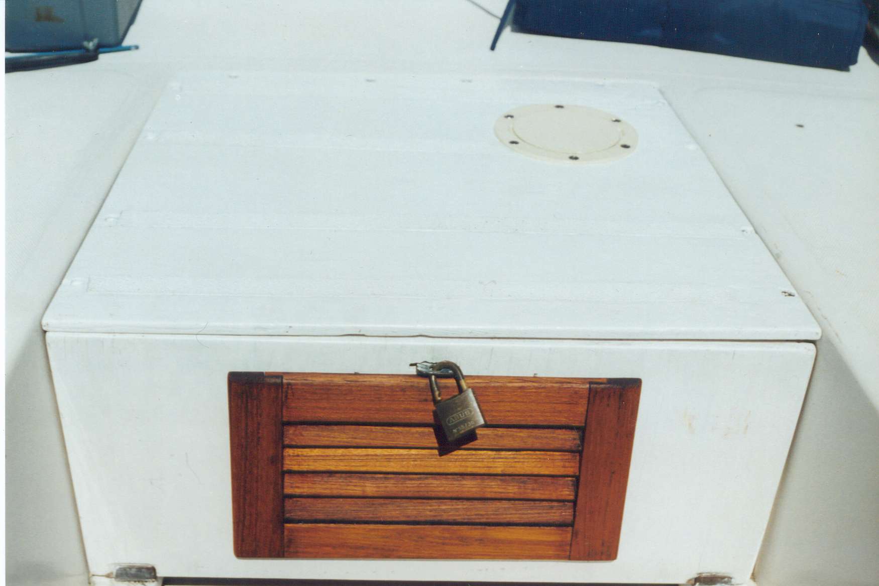

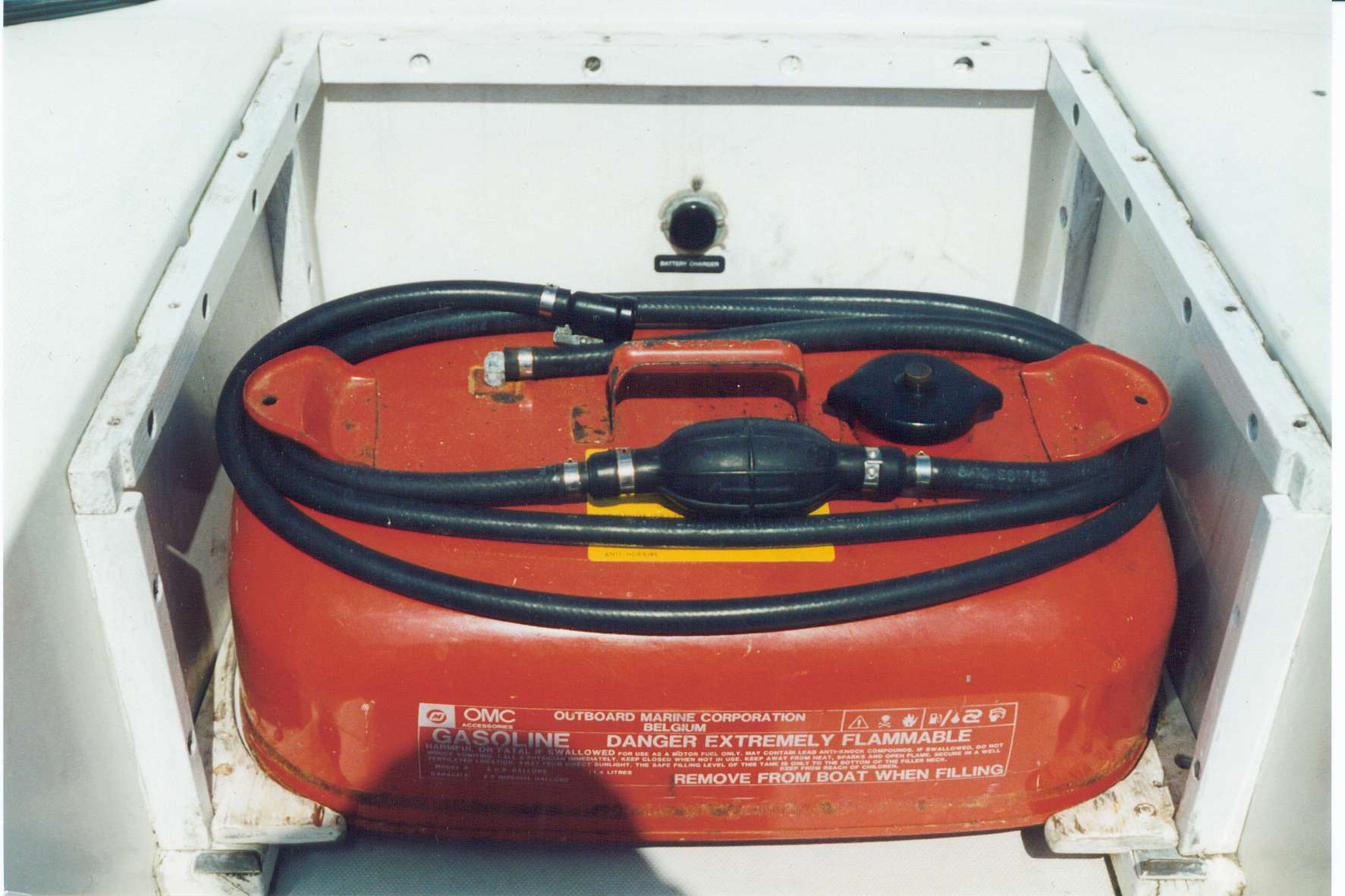

There used to be a great aftermarket fuel tank locker sold that could be mounted In a cut-out in the side of the cockpit seat riser, came either with or without a cover for the open side. Alas, no longer made. (see scanned pics below) However, if I had an O'DAY 20 or older 22, 23, or 25..... I would add virtually that same thing, just "home-made". It would be easy to construct a box big enough for the tank, glass the inside and then cut a lid in the seat top and seal that box to the inside of the cockpit seat top and riser. Would be a home-made version of what O'DAY built into Brian S's 192. Cut a slot in the cockpit riser to allow fumes and spillage to drain into the cockpit footwell, that would also let you lead the fuel line out to the motor. Or, just make a shelf that holds the tank up off the sole at the aft end of the cockpit (under the tiller) and make a plywood cover that securely covers the tank (with gaps to allow ventilation), yes, it does take up room in the cockpit..... but it will be the easiest way to provide safe stowage out of the elements for your tank. We did that on our old CAL 21, I would have preferred the built-in box idea, but my Dad, as primary owner preferred the enclosing of the aft end of the cockpit better.
I have included a pic of the locker on a 22 as well as 2 pics of the locker we built for our CAL 21, on our locker the 3" deckplate near the aft corner was to lead the fuel line out of the compartment.
